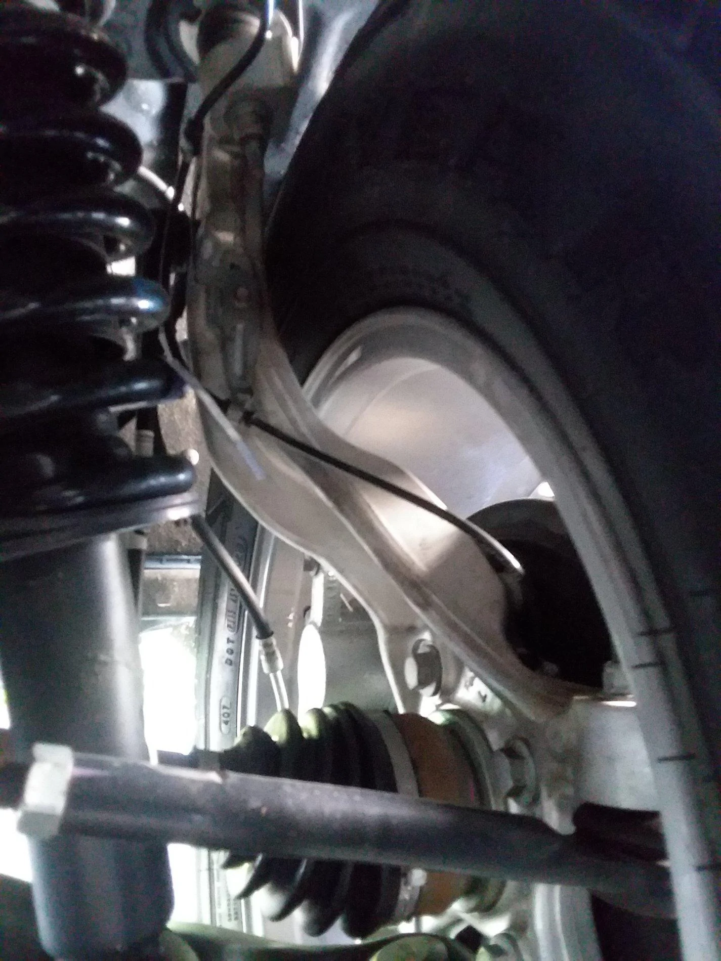

No not a must. But with the stock wheels the tire sits right next to the aluminum knuckle. Maybe an 1/8 of an inch. Maybe a little less. I didn’t measure. Heres a photo. As long as you never air down the tires. I would think you could get away with it. Tires seam to find a way of airing down all by themselves thought.

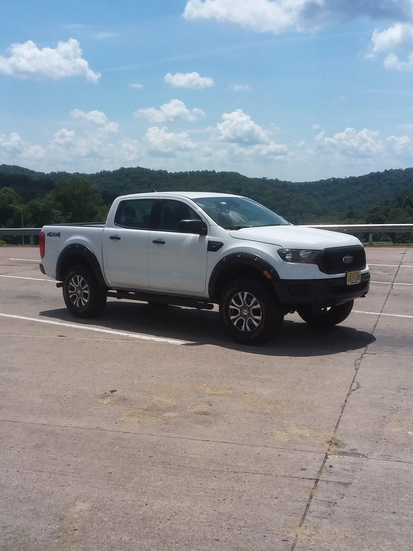

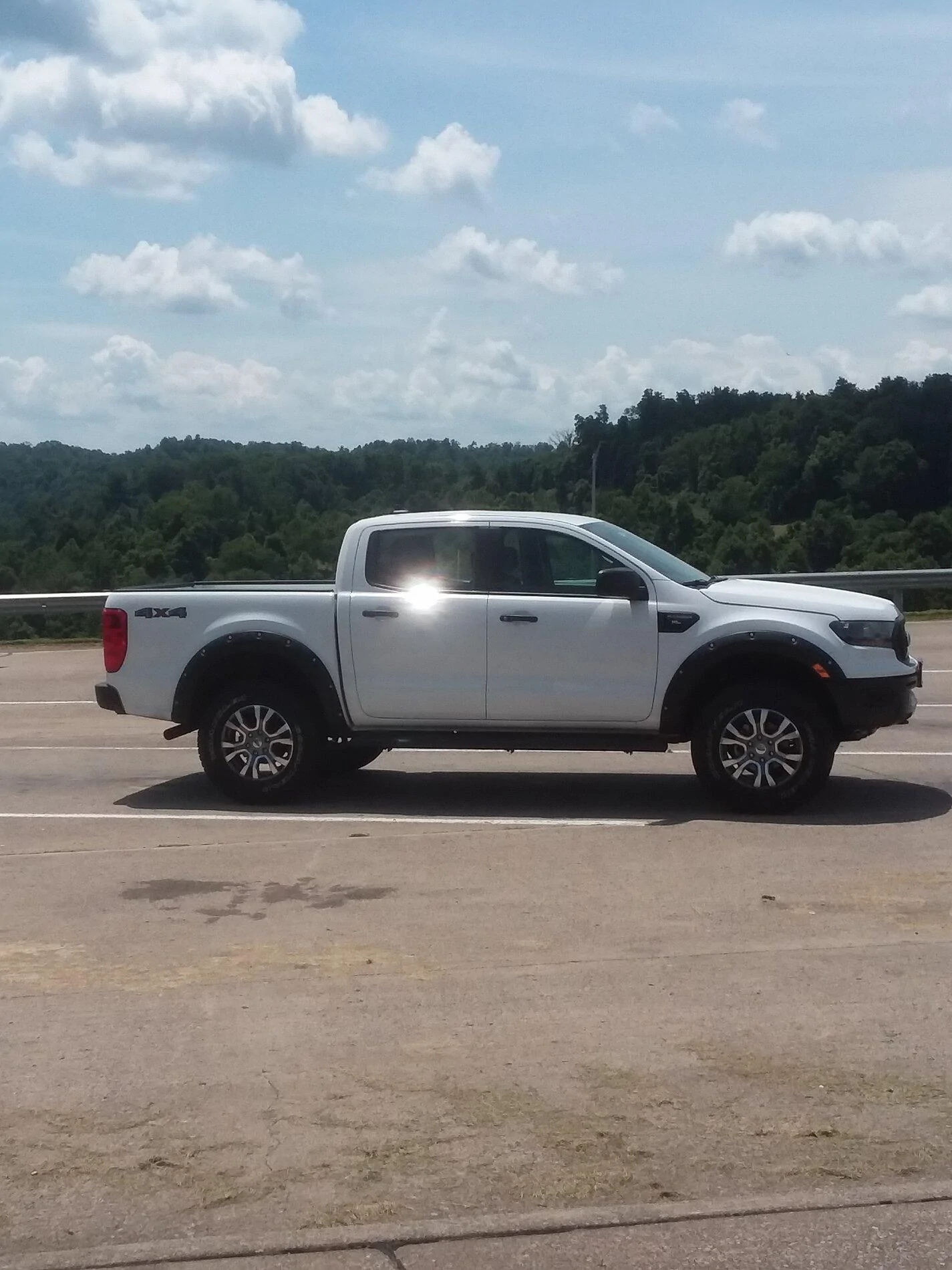

Love the flares. Really sets the truck off and gives it some attitude.
