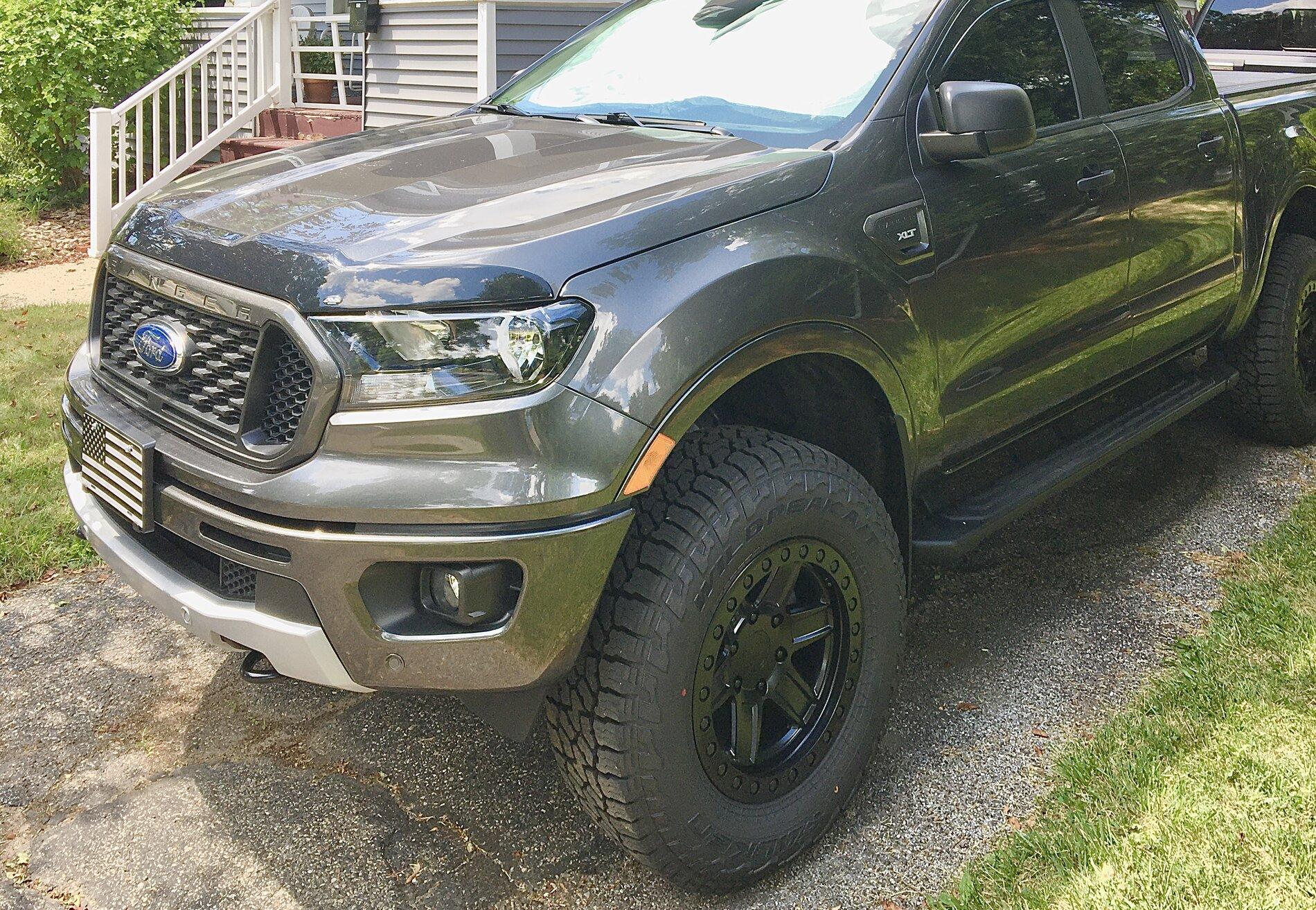

I have a 2020 Lariat FX4 w/ the Fox 2.0 kit installed.
Mounted Toyo Open Country A/T 3’s in 265/65R18
Been very happy with them!
Main reason I went with them is the fact that they are only ~4lb’s heavier than the factory tires. Almost all other options on the market are 10+ lb’s heavier.

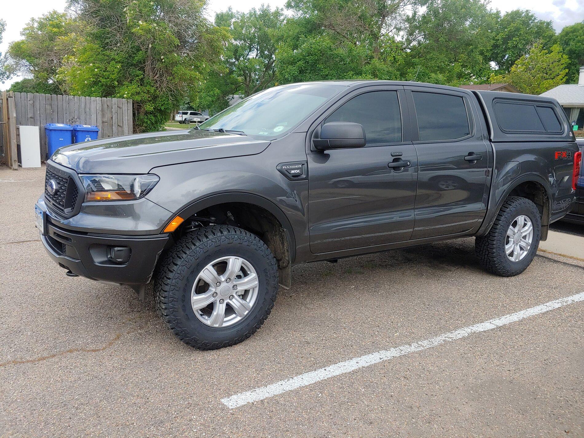

I put the Goodyear Ultratarrain 265/70/17. That is the largest tire Ford will keep the warranty

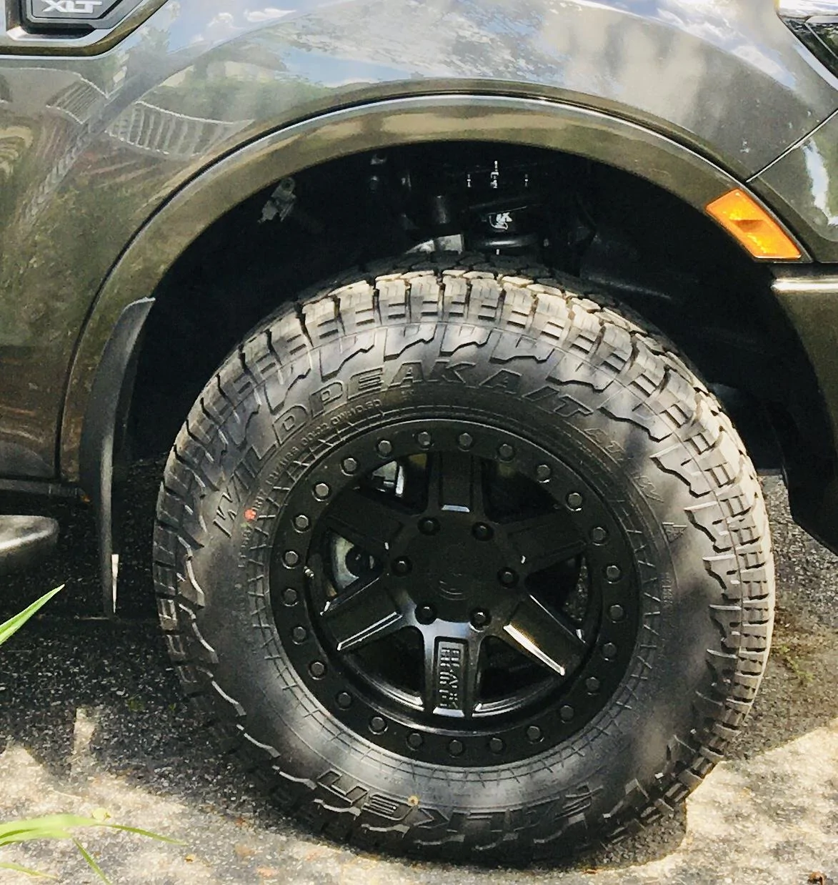

Falken Wildpeak AT3s (E load) 265/70/17 on aftermarket wheels with +12 offset. FP Fox 2.0 leveled suspension.
Works well. I like the tires thus far (three weeks). Quiet. Comfortable ride (35 psi of max 80 psi). Good fit. Capable. Largest size to which Ford claimed it would recalibrate (same for FP tune). Good reviews. Ford dealership had a deal on them last month.
