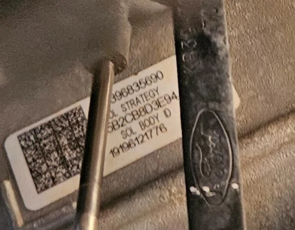

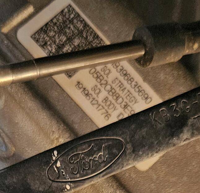

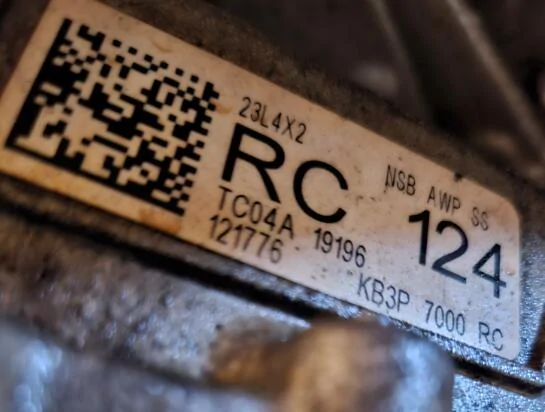

here are some pics I took prior to taking it back to the shop so maybe you fine folks can give me the good or bad. ALLEGEDLY letters in the solenoid strategy means its a new build but that is google talking - so not sure.

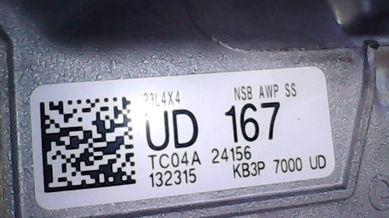

It’s most likely a reman based on the date code of “19196” ( june 19 2019) on the main tag. For example the date code for my new transmission installed on June 26th 2024 has the date code of “24156” or June 16th 2024. My original transmission hade a date code from February of 2022 ( can’t remember exact day number) and truck was built in 03/2022.

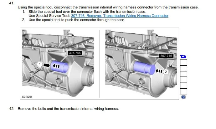

So the issue was an o-ring sealing the wiring harness per the shop.
I decided to look over the manual and it appears to be this?
Initially it feels fine. Fingers crossed.

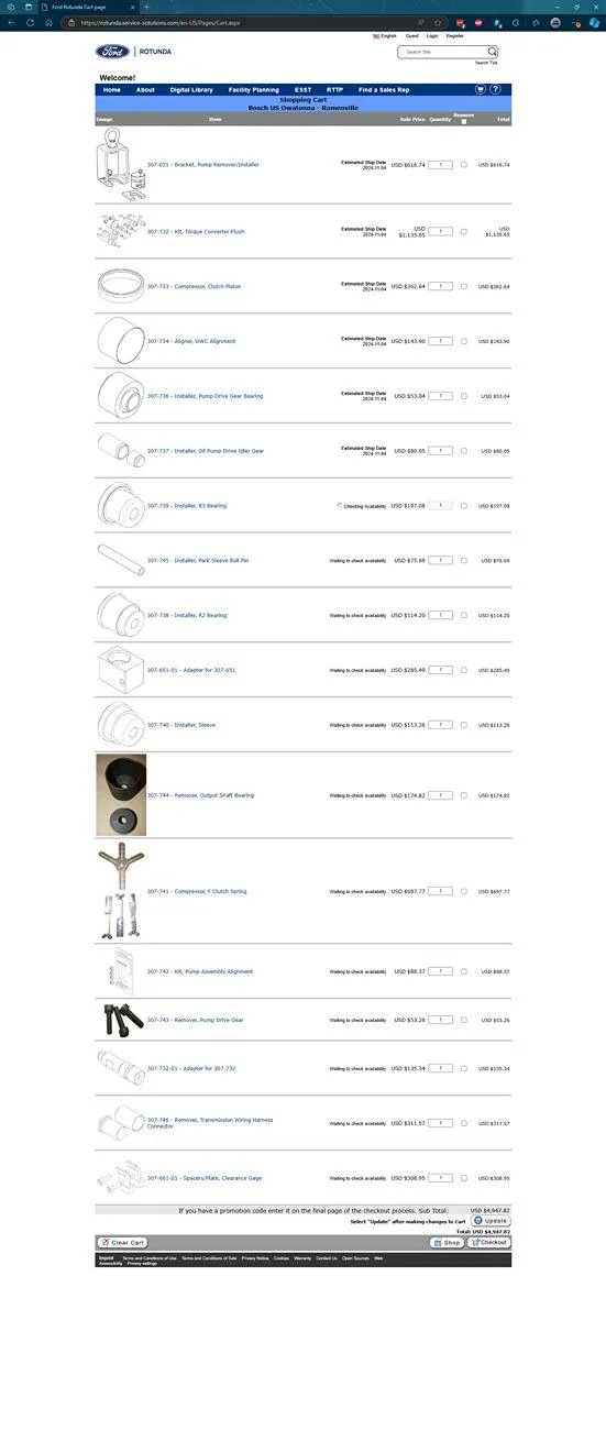

Well, now I'm looking at the cost to build out my transmission service tools for this truck.... (the one tool shown in your post is over $300). Nearly $5k in specialty tools.
