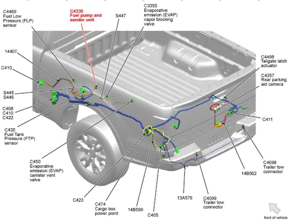

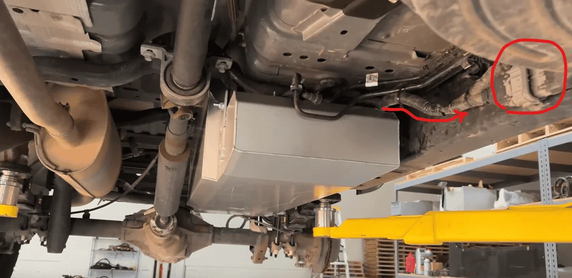

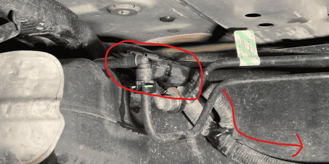

Ok to test the circuit - you disconnect C4330 (which is on the top of the pump)
So, use C410 instead and this will at least tell you the wiring is good from C410 up to the IPC

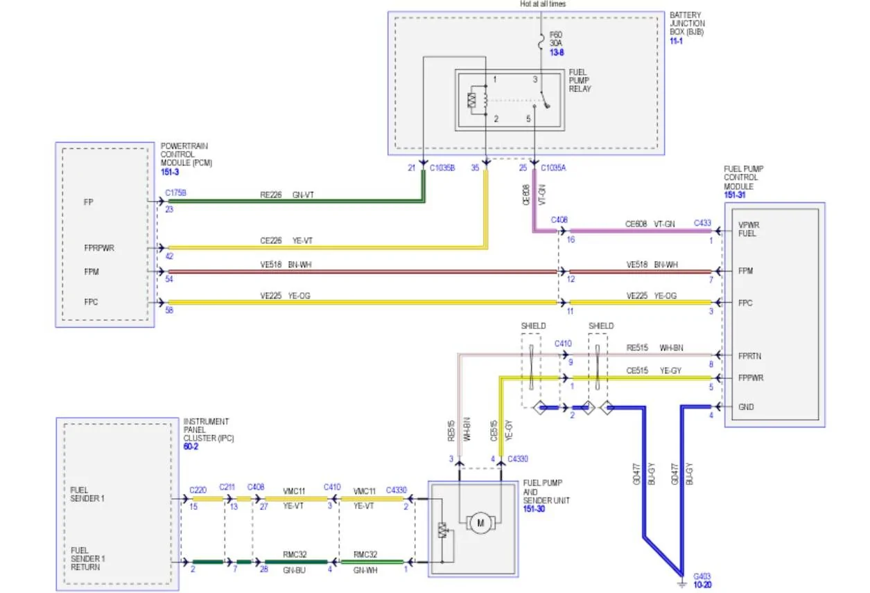

Test 1:
Disconnect C410 : Key -ON - Wait 1-Minute, Perform a IPC Self-Test
Note: P0460-11 (May Be Present) but can be ignored
If P0460-13 is present - in this set-up then the wiring is good from the IPC to C410.
As you are creating an (open) and the IPC is picking that open circuit up.
Test 2:
Disconnect C410 -Connect a (Fused Jumper) on the connector that runs forward
Between Pins 3 & 4
Key (ON) wait 1-Minute then Perform a IPC Self-Test.
Note: P0460-13 (May be present- but can be ignored
If P0460-11 is Present in this set-up then the wiring is good from the IPC to C410.
You are by-passing the resister and forcing the circuit to pull low (under 8 Ohms)
Test 1 and Test 2 - will at least check the wiring to C410, the only true test is at the Pump Connector C4330 and you know that the IPC is working correctly and is reacting the way it should with the (2) self-induced faults on the circuit.
You can also use C410 (feeding up) as a resistance check Pins 3 & 4 to somewhat test the Fuel Level Sender, by having a known tank level and calculate approx what the reading should be, using the specs I posted, you can then rock the truck back and forth to get the fuel to slosh and watch the reading and note does it jump out of the resistance scale 8 -184 Ohms.
Not a accurate test at all, but at least it is an approximant basic test that can be done without dropping the tank for a more accurate test.
So, in a normal operation, the system will not default to empty unless the resistance measurement falls out of the 8-184 Ohms (range)
Normal Operation is:
Full =10 +/- 2 Ohms
Empty = 180 +/- 4 Ohms
For a complete range (in between) 8-184 Ohms is considered normal any reading outside of that range and the gauge defaults to (Empty)

Other conformation checks that can be performed.
As I was curious - about the Scan Tool (Command) the fuel gauge testing in 25% increments
what is it actually testing (circuit wise)
It appears this only test (the IPC - Gauge itself)
If you can command it to all levels (Empty (0%) to Full (100%), then the IPC is good, and it directs you to the Fuel Level Sender - Test already posted.
If you cannot command it - Then it leads to a IPC issue
There is another test that can be done though:
With the fused jumper in the C410 connector (pins 3 & 4)
you can disconnect C220 (The IPC Connector) and measure (meter) between (pins 15 & 2)
you should have 3 Ohms
This is another confirmation of wiring is good between the IPC & C410
another one is:
Re-Connect C220 (if you disconnected it)
At C410 - (connector running forward)
Install a resistor (10 Ohms) between pins 3 & 4
Key on - The Fuel Gauge should move to Full, might have to clear any codes to get it to register.
With this test, you are basically (replacing) the fuel gauge sending unit (resistance) with a known variable (10 Ohms) and per specs = Full Tank on the IPC Gauge
These are some other options for verifying that the Fuel Level Sender is actually bad, before you actually drop the tank and do the (removed pump assembly test of it) as with the above tests and the tests previously posted - it only omits the short harness run from the pump down to the C410 connector. So a simple dirty connection at the Pump Connector C4330 can still be a possible issue that has not been ruled out.
If that connection is good, then it moves to the internal wiring or the float card of the sender.
