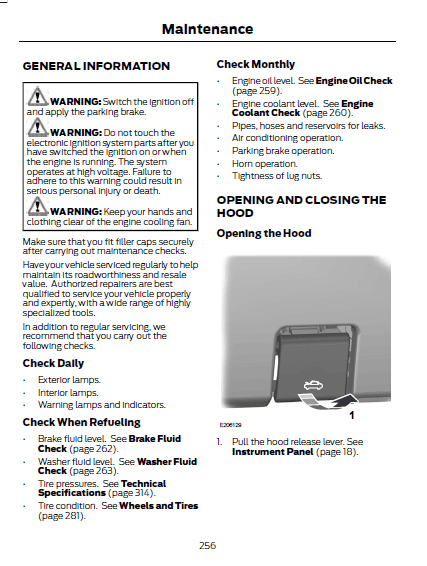

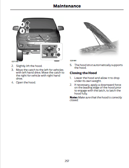

Step 1: Pull hood release at bottom of dash left of steering wheel.
Step 2: Exit truck.
Step 3: using right hand lift hood slightly.
Step 4: Insert left hand under hood and feel release lever.
Step 5: Move release lever. It only goes one direction.
Step 6: Lift hood.
Sheesh! Doesn't anyone read manuals anymore?
