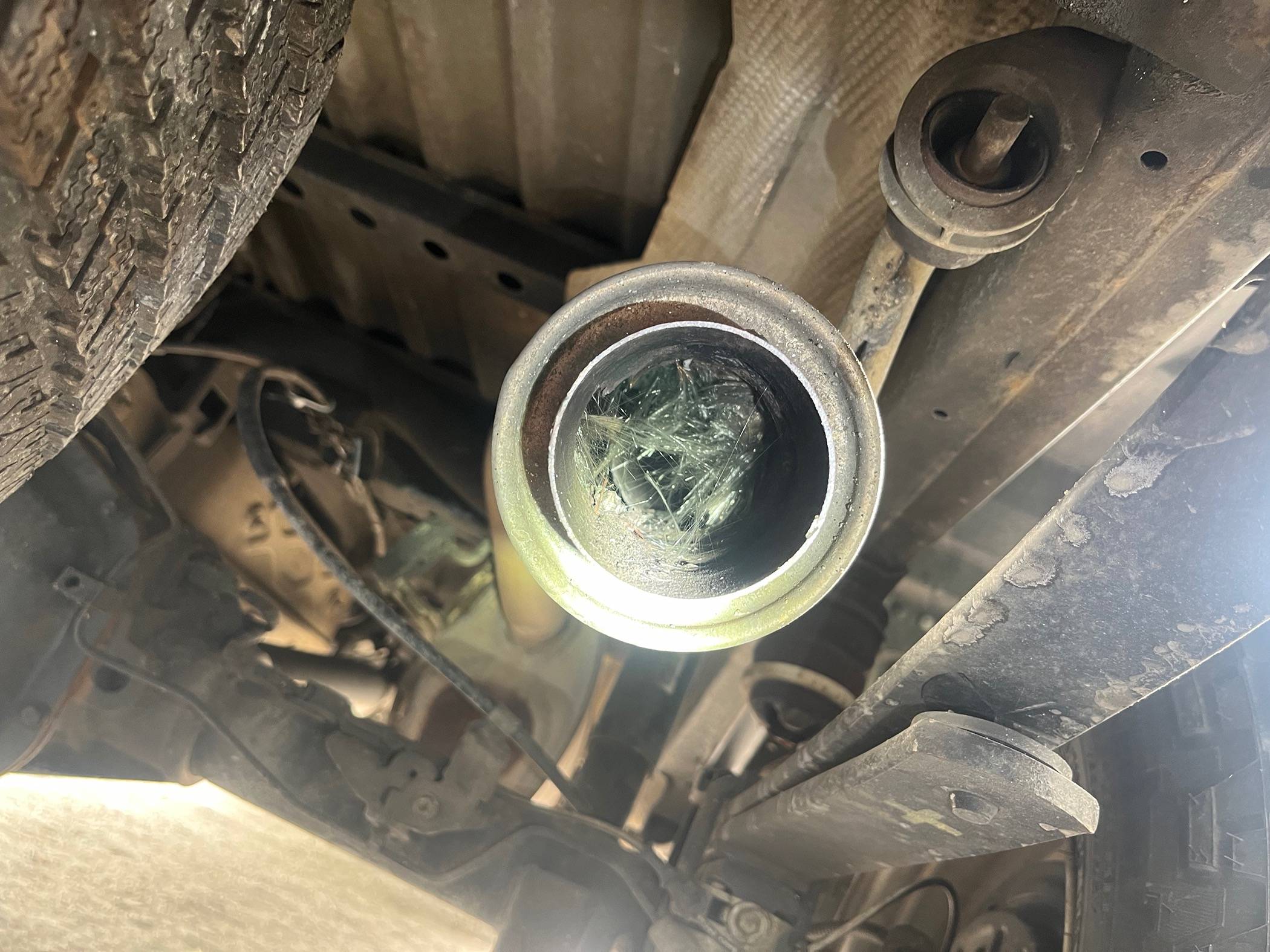

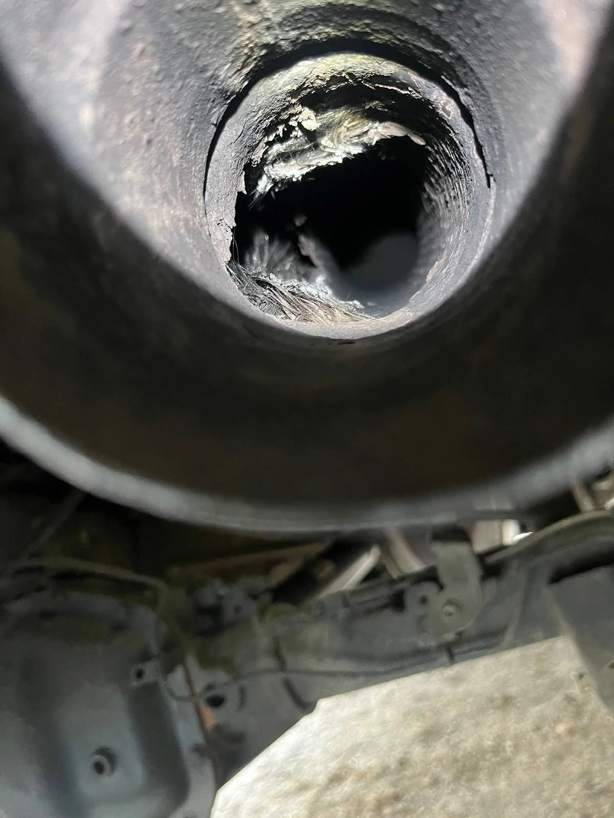

I’ve been trying to figure out this rattle coming from the back of the truck… I thought it was the E brake cable junction so I zip tied all the lines tight… Didn’t work..
so I come out of work and as I’m going around the back of the truck I see muffler packing hanging out of my tail pipe… so I pulled it out and I could hear metal in the pipe. Behold… the rattle. So I cut the tail pipe off to see if I could fish the piece out and this was what I discovered…
A portion of the perforated steel in the resonator rotted and broke off falling into the tail pipe with a big chunk of packing.
I can’t believe this happened already. It’s a 2021! I’ve never had an exhaust fail on anything in all the truck I’ve had.
Something tells me my extended warranty won’t cover this.

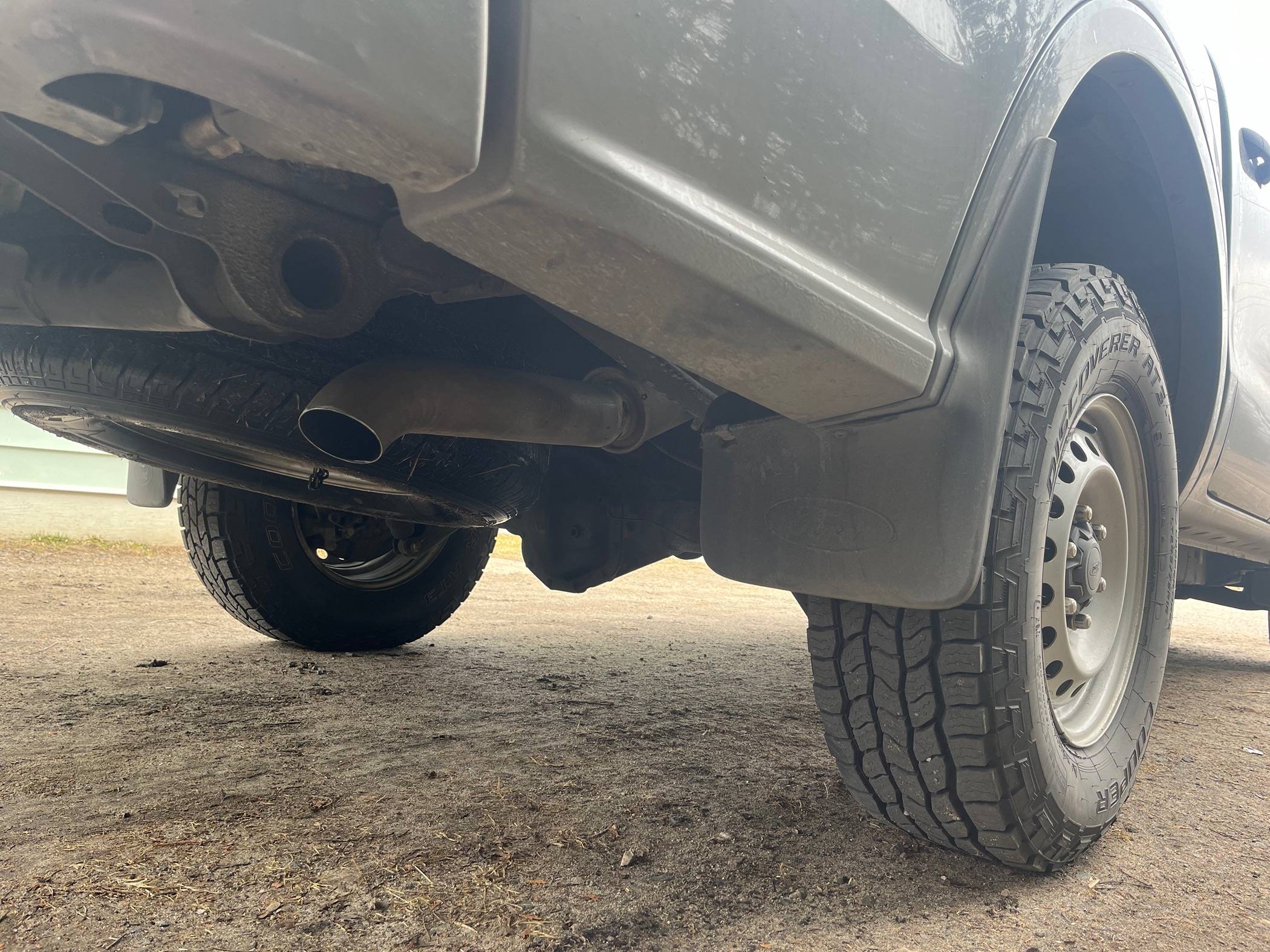

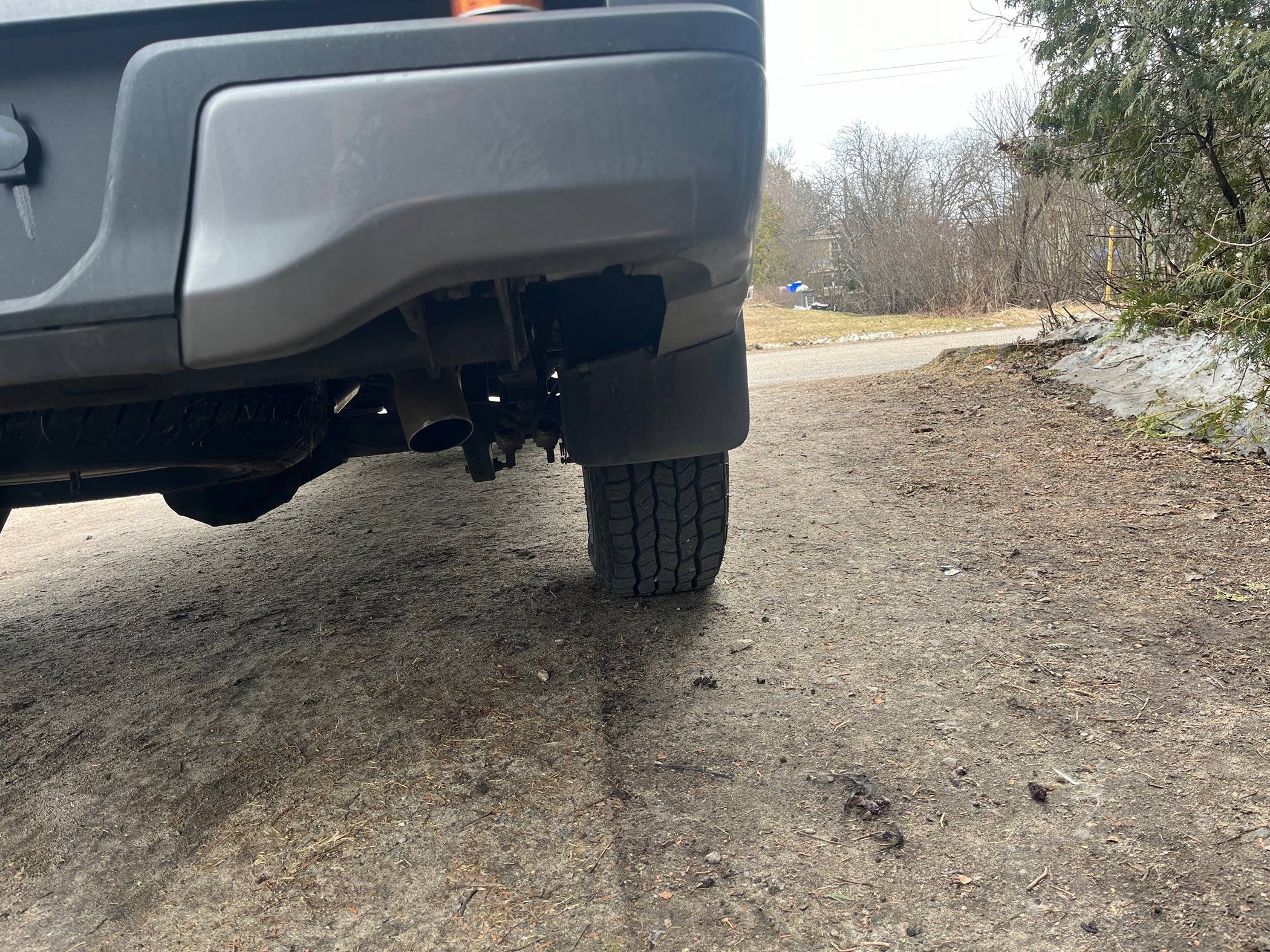

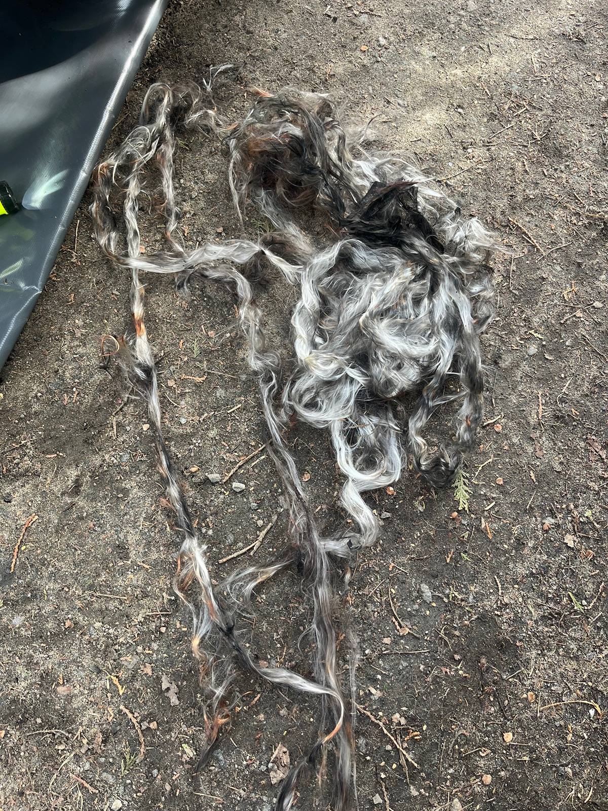

So I went out this morning and the rest of the packing came out…. I had a 10 ft string of it flapping g behind me on the highway… lol
I got home and fished the rest out and welded on the piece I cut off last night into a rear exit turn down. Sort of an off road style. This allowed me to do my spring cleaning of the spare and a quick rust spray in spots.
That will do for now.
It looks like you ran over Cruella deVille and spit her out your exhaust. ?
