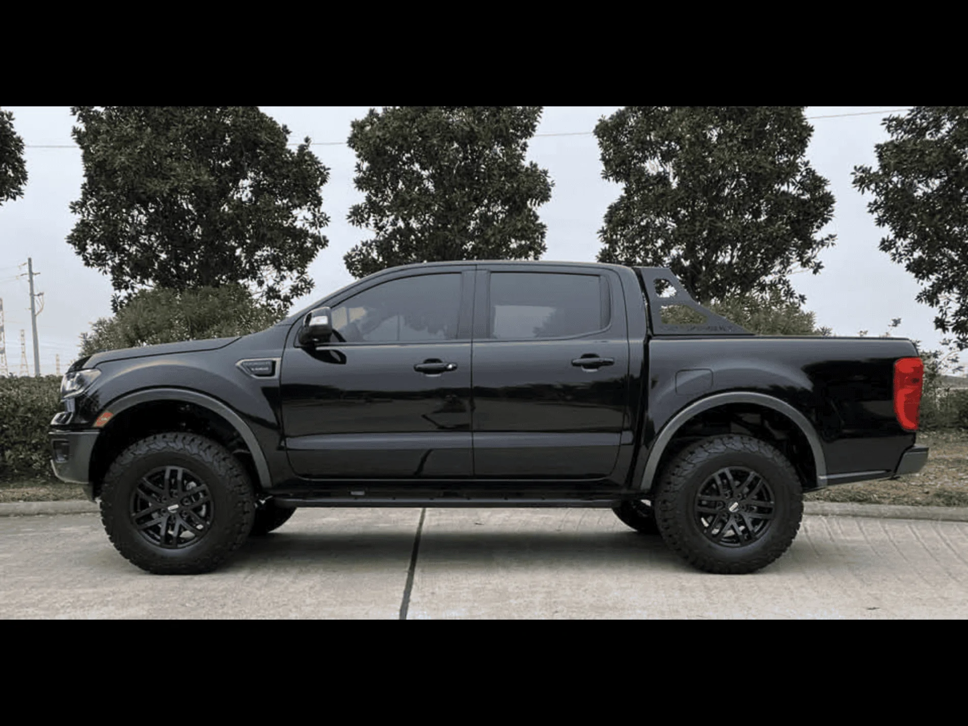

You donā€™t know me... I will continue with a 5 Star Tune that you keep saying 3 tune... I know that I said Iā€™d never do another 5 Star tune, if it was the culprit etc, and they denied it... Currently, the President of Stage 3 Motorsports, Bill is helping me as much as he can... I built this truck to be a Ford Ranger Raptor that wasnā€™t brought here... and once all of this bullshit blows over... Iā€™m going to flash my new 2022 Ranger Raptor with a 5 Star tune.... I appreciate Bills involvement and I trust their tunes... It helps to know, you have someone fighting in your corner... unlike you... Does my truck look like missed oil changes??
Look's awful clean. Think your trying to cover something up. :LOL: :LOL: :LOL: :LOL: :LOL::LOL:
