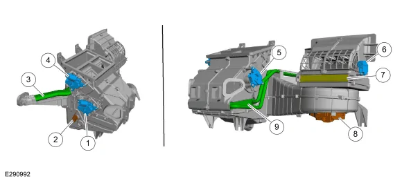

Being that Blend Door is thrown around so much I want to point out the correct name of the actuators and what they do.
For Dual Automatic Control
#4 = Air Distribution Door Actuator = This distributes the air - Floor, Panel, Defrost
#1 - Drivers Temp Actuator - Drivers Temp Output
#5 - Passenger Temp Actuator - Passenger Temp Output
#6 - Air Inlet Door Actuator (Aka-Recirculation Door) Outside Air Inlet from the cowl and the open vents right beside it is the mouse entry point into the cab.
NOTE: If you do not have the Dual Automatic Control and have the Electronic Manual Temp Control you will not have item #1
Both Drivers and Passengers side are controlled via Item #5
So, to clarify which actuator did you pull and move the door?
#5. It's a XL so has the base HVAC.

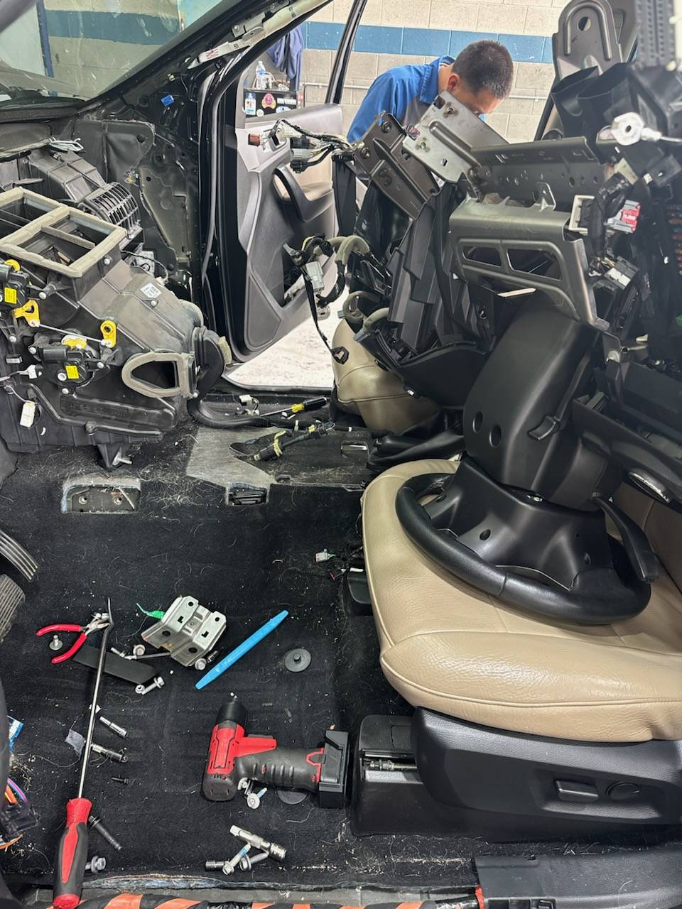

2021 here, I've had this clicking going on for a while, waiting for my one piece driveshaft to show up at the dealer so they can address both problems at once. (good thing my new trans is still going strong)
Truck has been in the shop for a month now, this is the "progress" picture I was sent today when I let the tech know I was coming down to pick up (I was told it would be done).
New climate control assembly under warranty (200 miles left on ESP), had them put in new actuators while they're in there.
