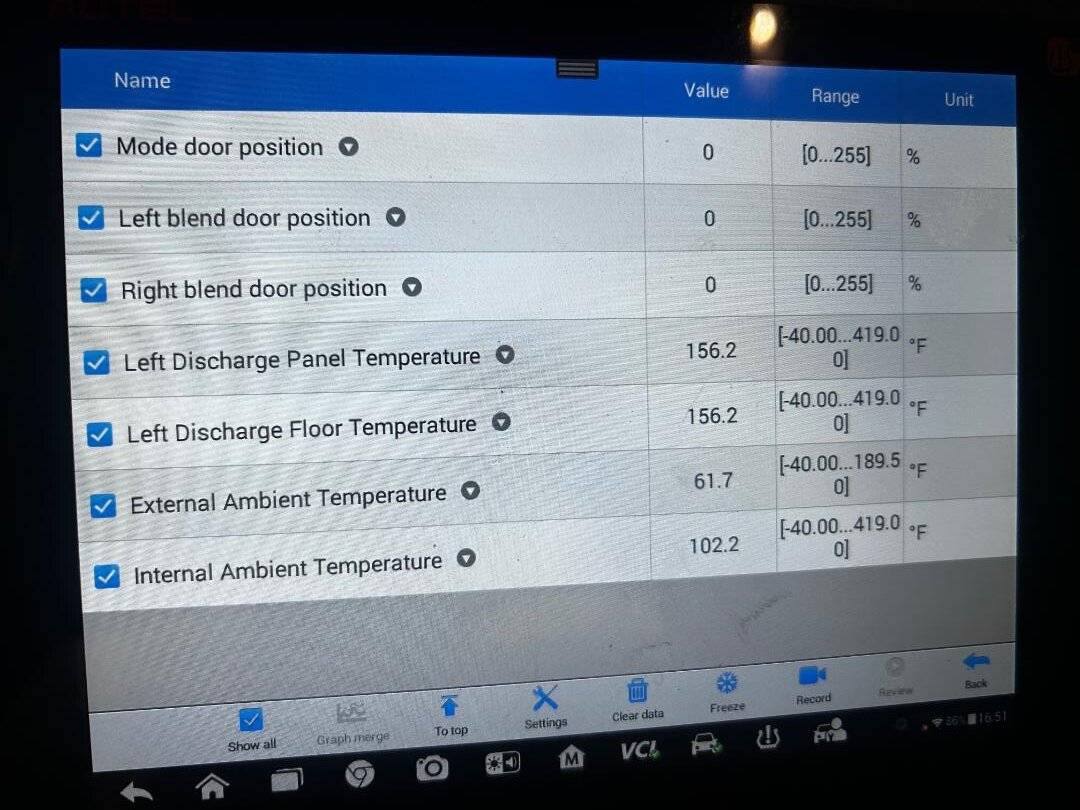

Are there any tricks to getting better heat down to the floor I do have the automatic climate control, but my feet are always freezing any suggestions?
I would say that possibly clean the Humidity Temp Sensor and see if that makes a difference.
and hook to a scanner and drive the temps (both sides) to HI
You should see results like this - my floor heat (will make your feet sweat) even with it set to 72 deg
So, either the Temp blend door is not fully opening (0%) or you have a duct not secured or one of the temp sensors is askew.
I know the system is capable of putting out some heat, granted this screenshot is taken with the truck sitting idle, so there is not ram air being introduced by the Air Inlet door, which even when closed it is still open 10%
The humidity temp sensor is located by your right knee, if it is dirty (dust) it may be throwing the average cabin temp off.
Now the airflow when in (Bi-Level) is rather low flow at the feet, but it should be HOT, the reason is the system design (OVERALL) Cabin Temp measured by the Humidity Temp Sensor, passenger side airflow pushes around the cab to the driver's side.
Ref: My Thread for some info on operation
HVAC / Climate Control- Issues - Operation - T-Shoot and Breakdown | 2019+ Ford Ranger and Raptor Forum (5th Generation) - Ranger5G.com
