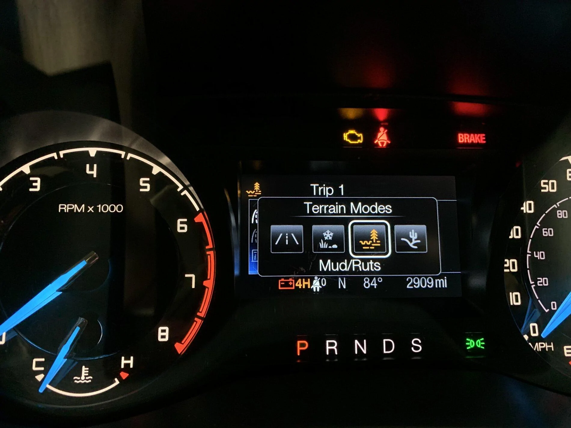

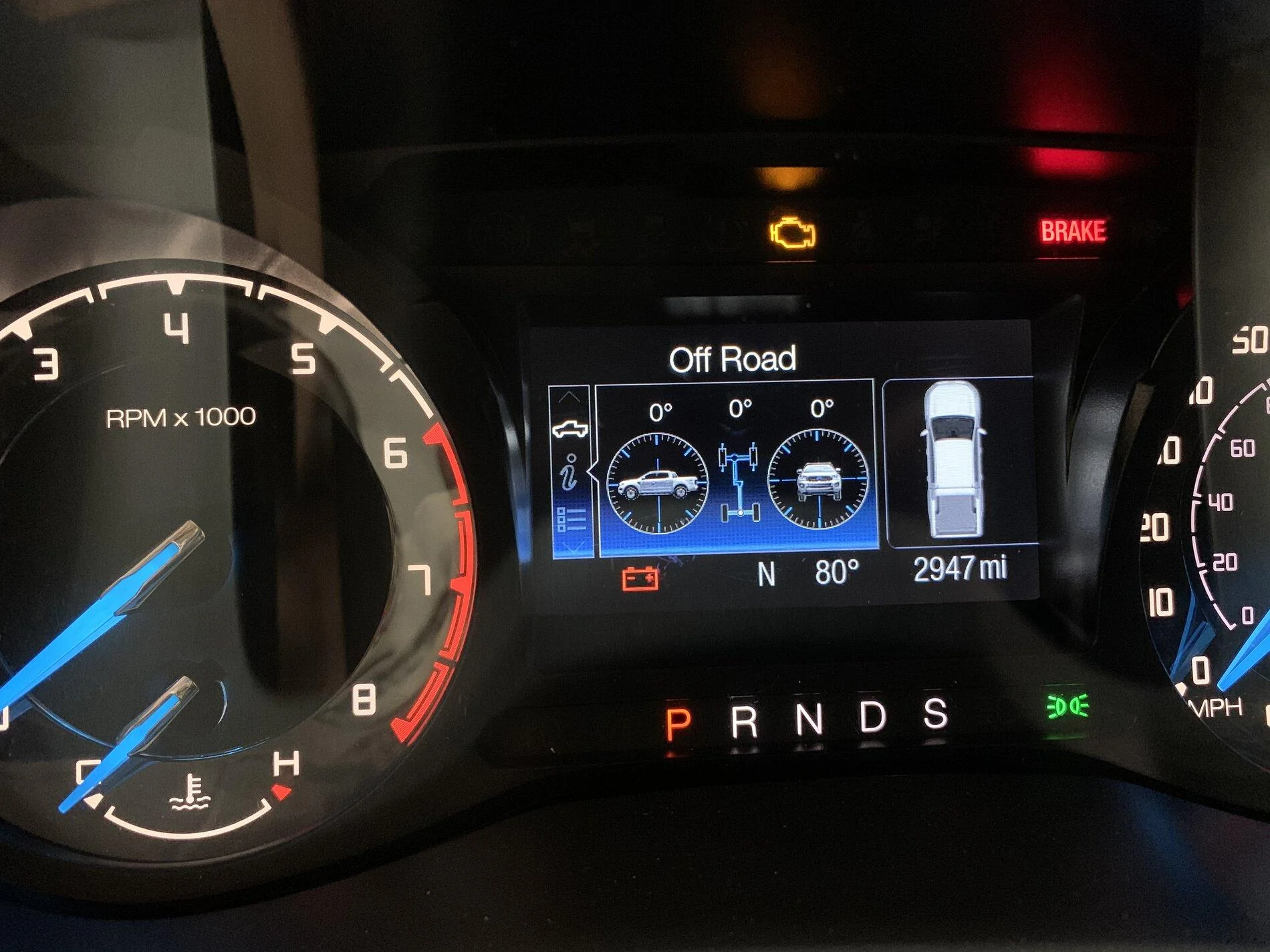

A huge thanks to the folks that started this and figured it all out!
Mines an XL,so I had to swap the cluster,which was only tricky trying to find one with as low a miles as my truck.Found one though,and installed,then added the new control knob,change a few items with forscan and it works as advertised.
Many thanks!!!! Can’t wait to take it out wheeling to put to use!

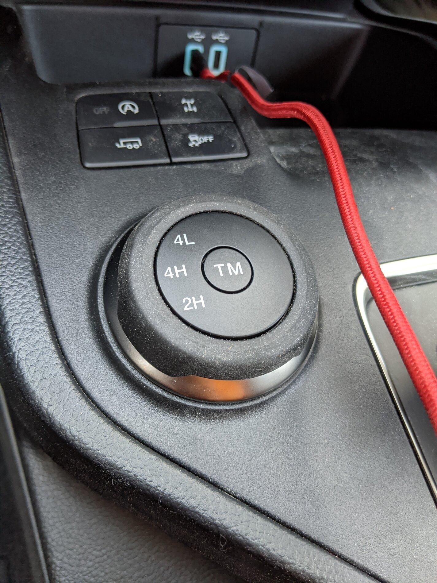

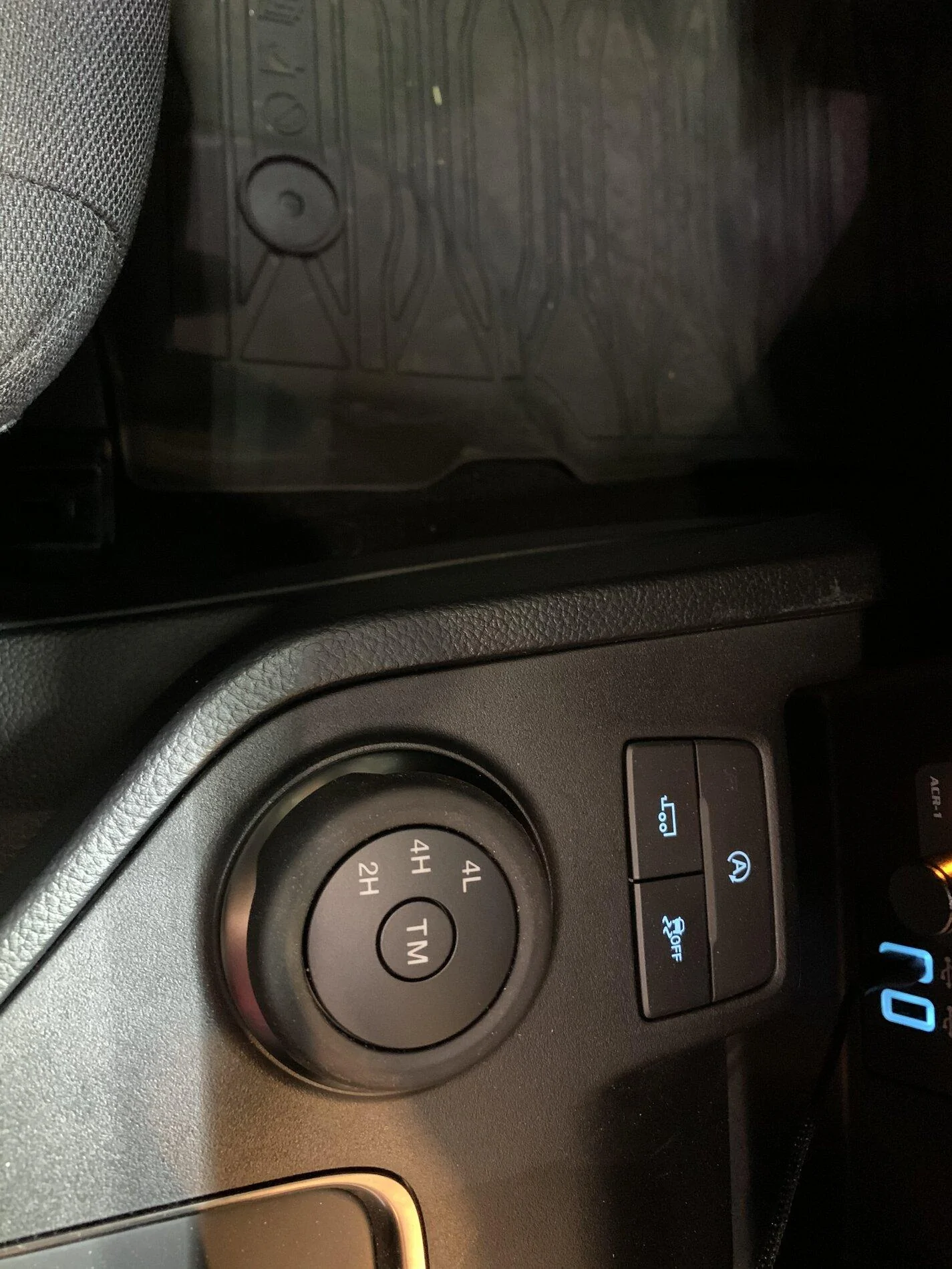

Did mine today. Pretty simple procedure.

Has anyone bought the terrain management controls and added them to their vehicle to enable terrain management using forscan yet?
Purchased the Terrain Management Knob, installed and then enabled in Forscan. Easy peasy.
