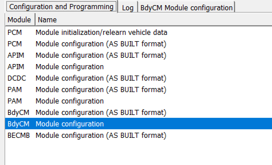

Guys I connect my ELM and open Forscan and this is what I get:
I've looked through all these modules and have not seen the terrain management system on off function. Where is it located? What am I missing? Sorry but I've looked high and low.
does your ELM have the manual switch ??
If its the OHP ELM see this
