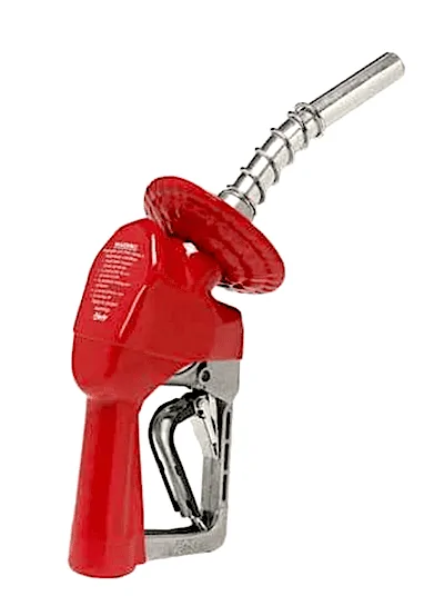

When I picked up the truck, it was down an 1/8 of a tank. I mentioned it to sales guy and he gave me the choice of waiting for them to run to the gas station or a free ballcap. I'm a sucker for a ballcap. Tonight I went to fill up for the first time and when the pump clicked off, I gave it a few more squeezes. Got in truck and it's showing down an 1/8. Ford Pass matches so I don't think it's the trouble some have reported with that.
The only thing I can think of is that I was at Costco and they have the nozzles with the seal around them and that maybe caused the issue?
Anyone experience something like this? I searched threads and didn't see any posts about it.
EDIT - It was the Costco pump. Stopped at Mobil and it filled up no problem.
I have had similar problems with other vehicles when filling up at a pump that has the vapor recovery system (black nozzle). They sometimes interfere with the vehicle's own venting. They are also a pain when filling a motorcycle tank.
