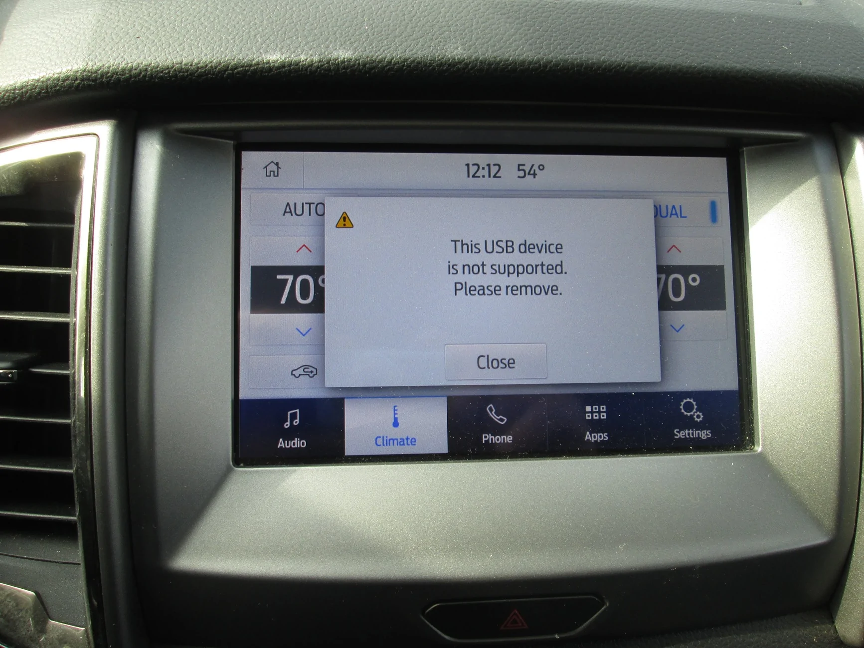

Any way to get this off the screen ?

I pooped the new control module in, and it is fixed now. Thanks again everybody and all the trouble airline tech for posting the picture and info which was wonderful help. Thanks................

Mine does that as well with my Android.
If bad probably need a new Module. This looks like a common problem as they have sold a lot of these. Since I bought the truck used the screen has been miserable but fixed now it works great.

True - Yes for the Ranger at least this forum, I do not recall a great deal of issues with the actual hub failures.
Keep in mind that the part number I posted is not specific to the Ranger, it is valid for a few other ford models.
I dug some into the Hub operation and it appears that there is a resistor in the hub (pull down) that pulls down when there is nothing connected and the device power overcomes that resistor on the data lines - this is how the Sync (APIM) sees that there is something connected.
So, either the Hub was shorting the data lines together or the resistor was bad - tricking the APIM into thinking something was connected.
Either way - it's a good fix
