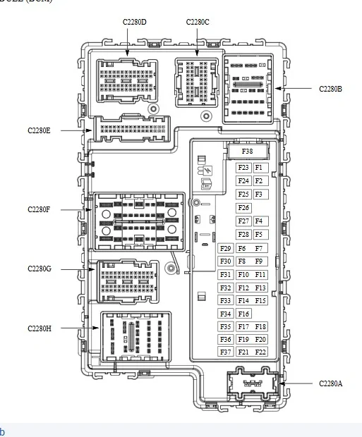

I suspect one of the handles is faulted and its pulling down the circuit (internal to the BCM) micro controller as a possibility or a bad ground.
The circuit uses a separate power feed and antenna for each handle however they share 1 ground. There is no fuse for this as its direct power from the BCM itself.
The main connector feed into the BCM for both handles and the ground is C2280E.
Try pulling and reseating this connector and inspect for corroded pins.

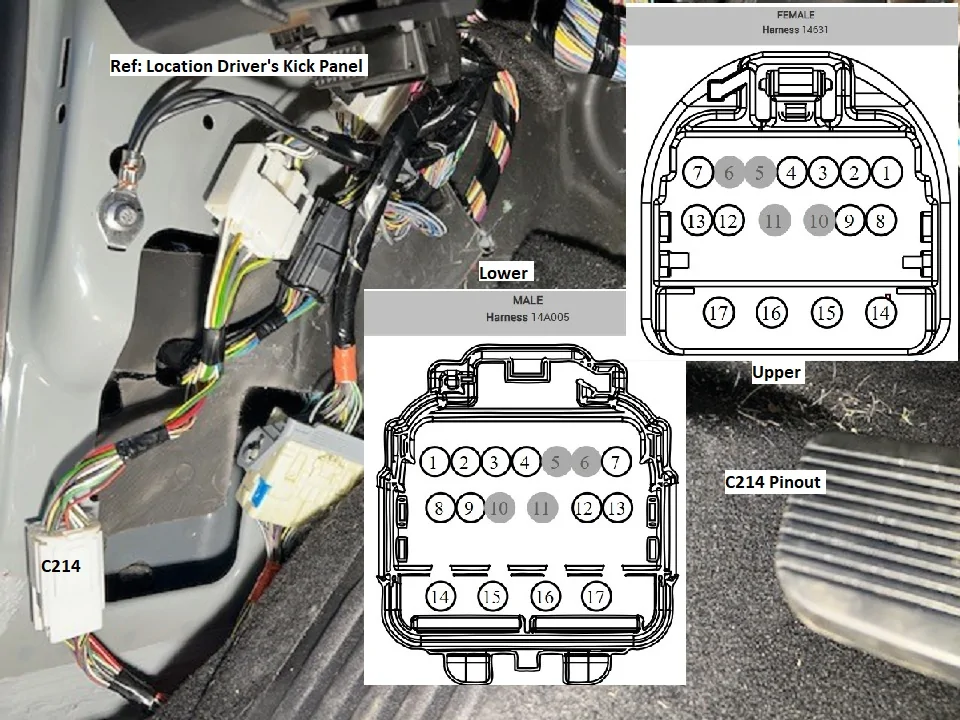

Depending on how deep you want to go without a true T-Shoot and possibly isolate which side (Left or Right) the issue is on, would be pulling the door panels and disconnect the handle connector and see if the opposite side now works, you can move farther downstream to a more accessible connector but disconnecting that will take out the door locks with it
and those are C214 (Left Side) and C3050 (Right Side) located in the kick panels.
If I were to flip a coin I would guess the issue is in the most used handle (Drivers) if it turns out to be a faulty handle.

The BCM is located in the Drivers Footwell just above your feet
The main connector to reseat is C2280E

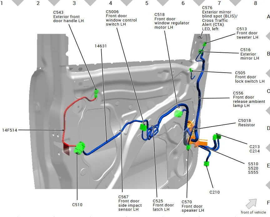

Next Connector is: C214 - This feeds into the door - the kick panel has to be removed for access
Then C510 - The door panel has to be removed for access
Then C543
This would be a simple check with a scanner but Old School we can swap the Right Handle to the Left to see if it the Right Handle will function in the Left Position.
or dig into wiring checks with a meter

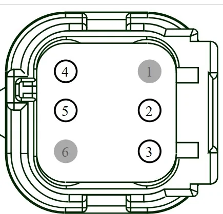

The basic checks @ C543 are
Key Off:
Check for Power @ Pin #3 (Battery Voltage) 12 Volts
Ohms Scale:
Check the Ground Pin # 4 to body ground -Less than 3 ohms
If you have good power and ground then we move to the Antenna, the antenna is internal to the handle
Ohms Scale:
Check the resistance of the handle antenna:
Handle Side of the connector - Not the Harness Side so visually match C543 to the handle connector to find the pins.
Probe between Pins 2 & 5 - 1 to 3 ohms - I have a feeling you may have high resistance here
We can go a step deeper and check the continuity between the BCM and C543 for the Antenna wiring if needed but if the above checks are good its a good indication the handle is bad.
If you find you have no power then it is possible the BCM has dropped power to it and needs the code reset.
