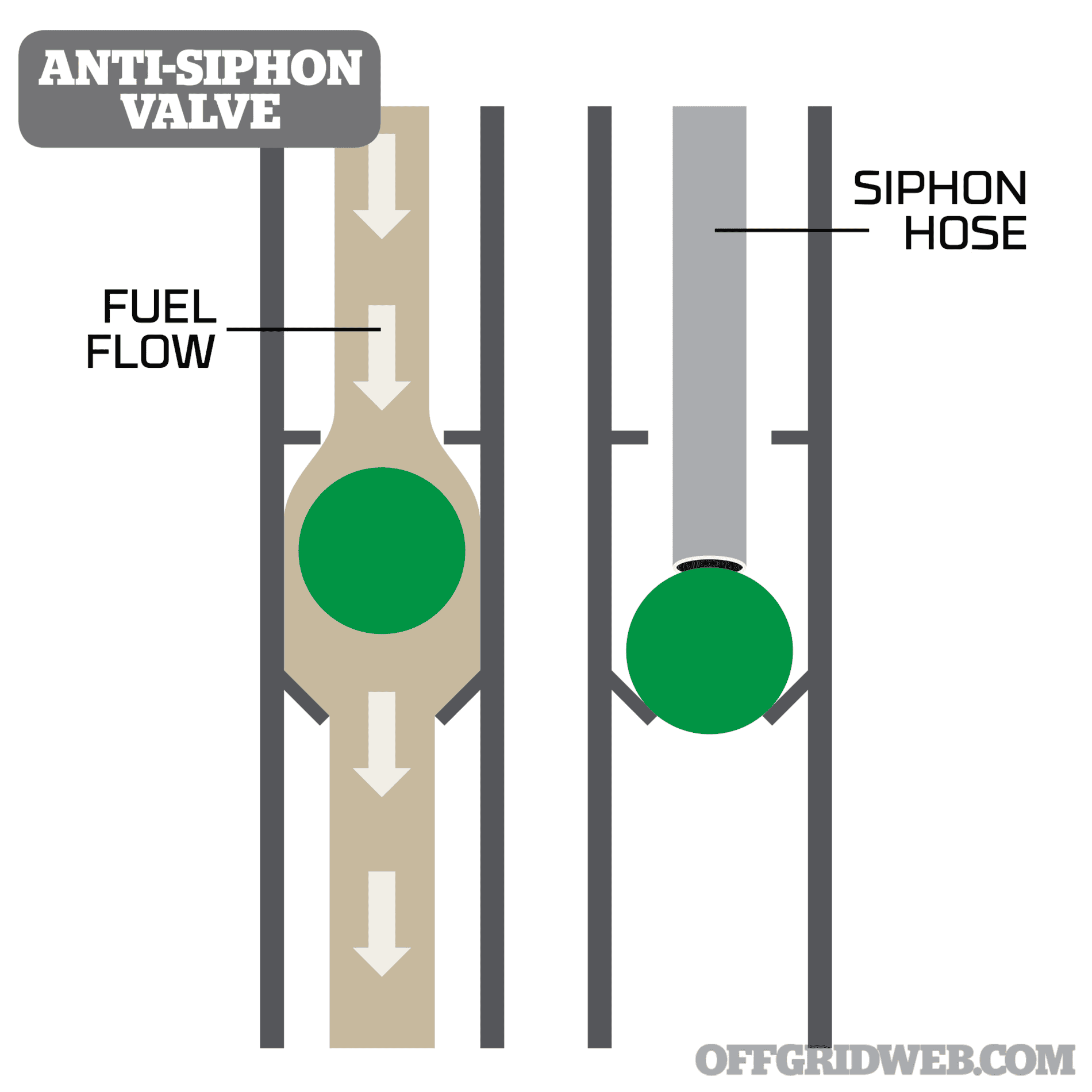

How does fuel get in then?
I don't know if this is the exact design Ford uses, but conceptually it's like this. In this example there's a ball that floats and lets gas into the tank, but gets pushed against a collar if a siphon tube is inserted.
61
7,757
22,642
That'll make drilling the bottom of the fuel tank much more attractive ?
