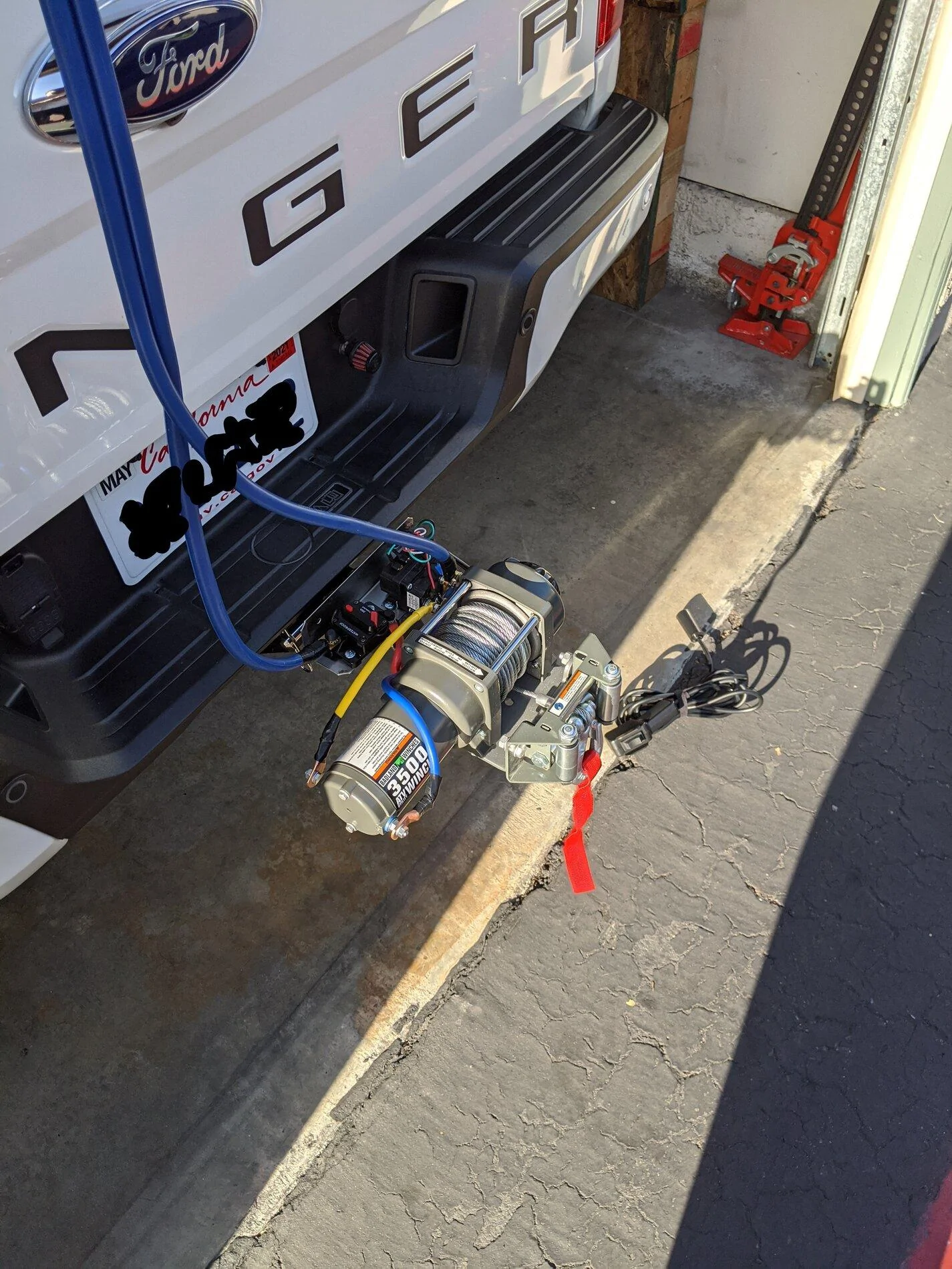

I have a hitch mounted winch setup
Got the hitch plate from Amazon
Winch from harbor Freight, shortened all the wires it came with, came with a wired remote long enough to reach the cab. I didn't want a huge heavy bulky one so I went with a compact setup with a snatch block if needed
Cables from Amazon (quick disconnect on the winch side with alligator clips on the battery side, 25ft so I can run to my battery. Also didn't want to hardwire anything, and with this setup its easy to use with any truck, say a friend who is stuck on the trail)
Circuit breaker and misc. electrical fittings from Amazon
Used a piece of angle iron and self tapping screws to mount all the electrical components
This is the path I’m looking to take, except with the 5000lb unit. Any chance you could post more detail about your whole setup?

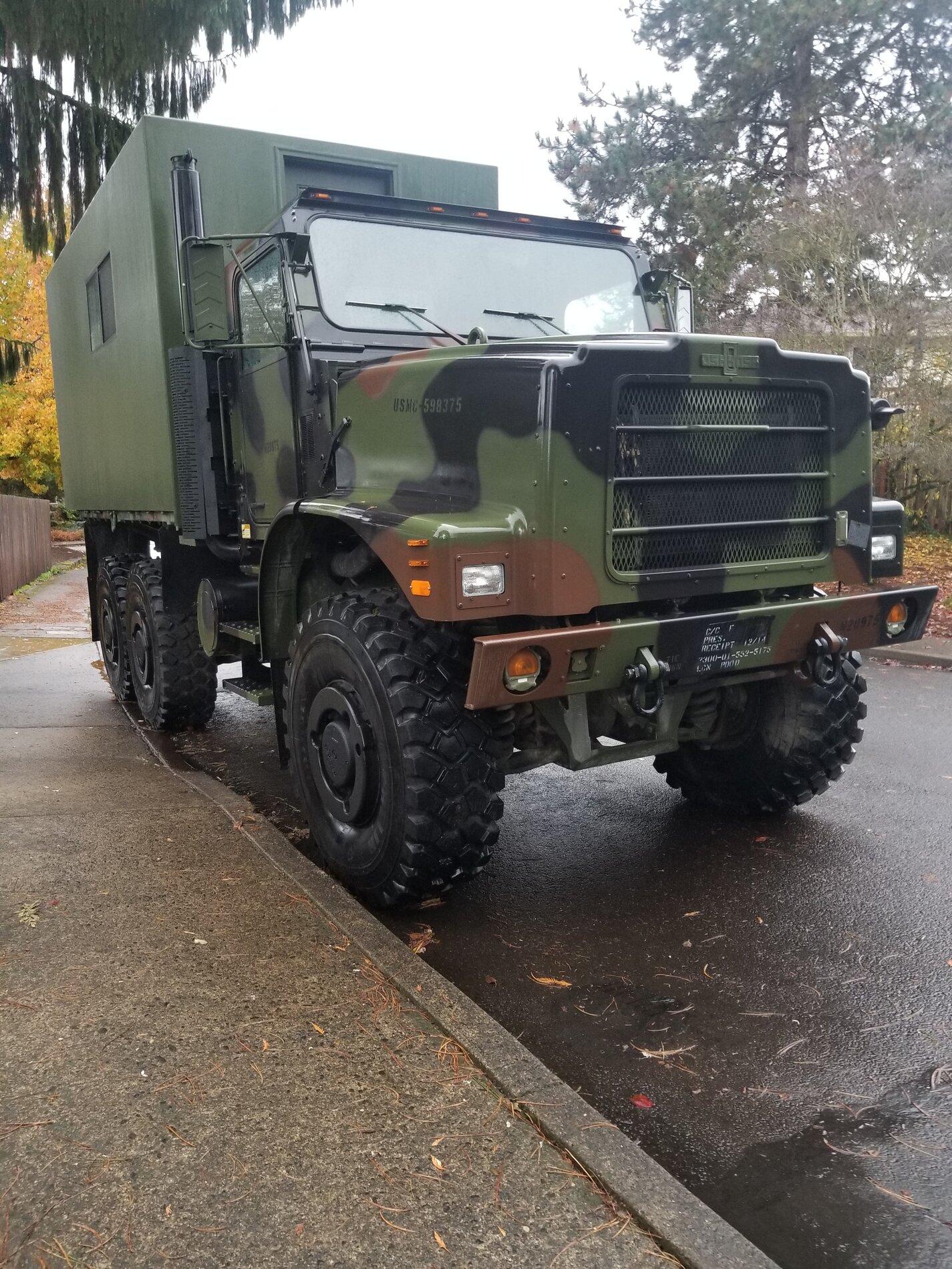

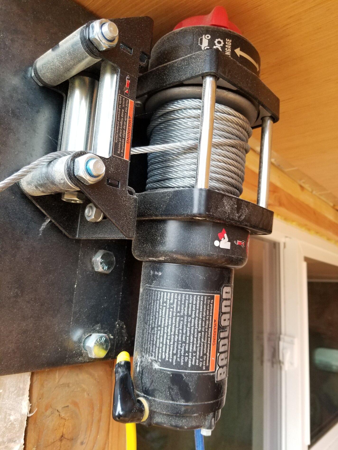

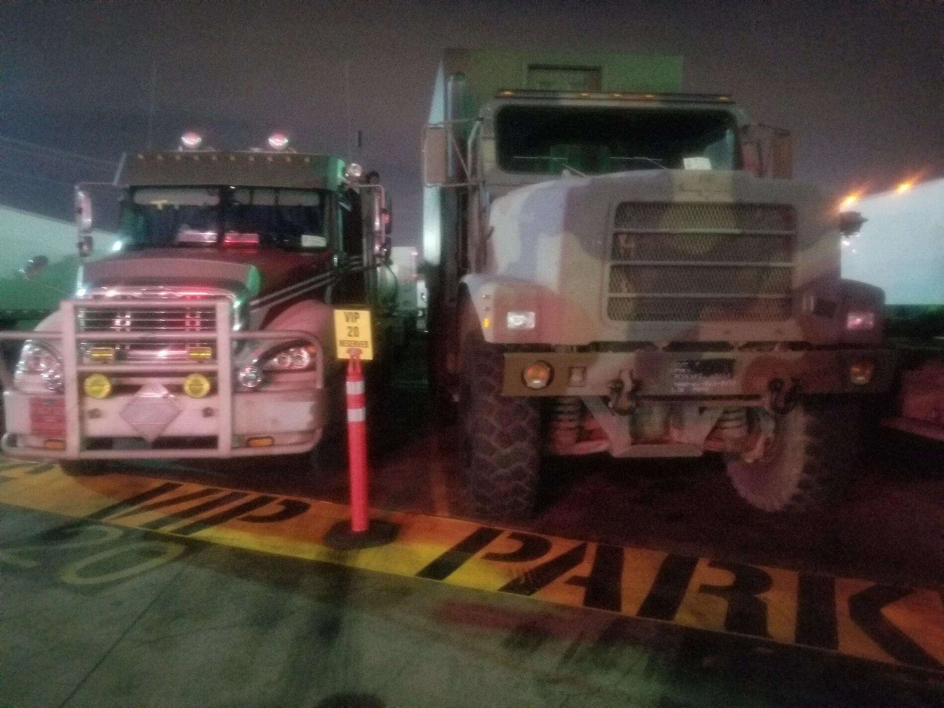

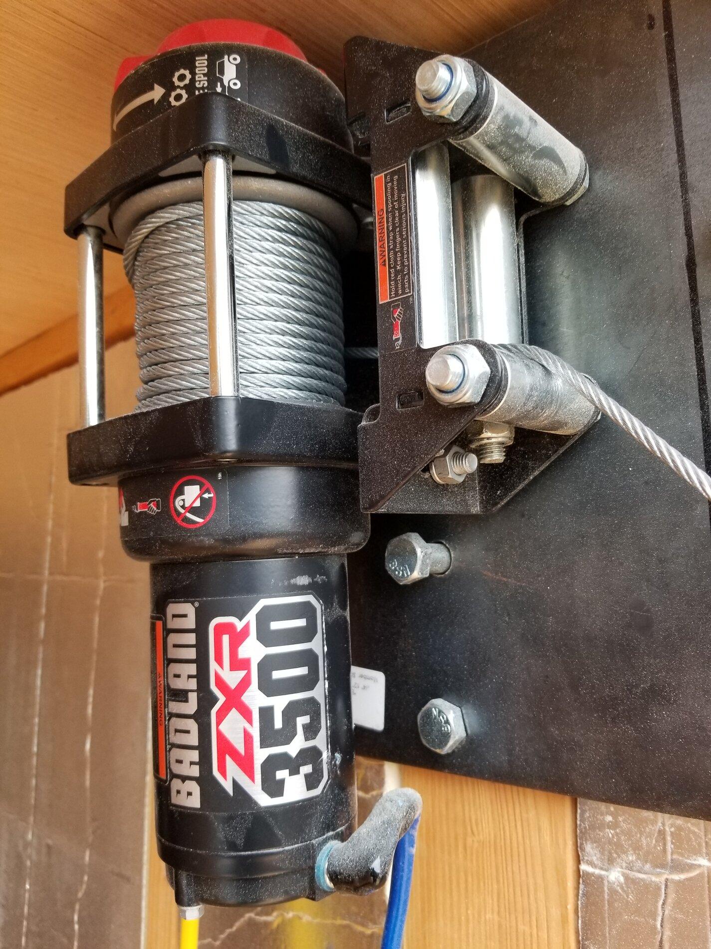

That's an interesting choice of winches- we use a pair of those to operate the rear "drawbridge" door on our ex-Marine special forces armored gun truck MTVR motorhome, and we've got a third one to winch motorcycles up into the "garage" inside the back of our box:
