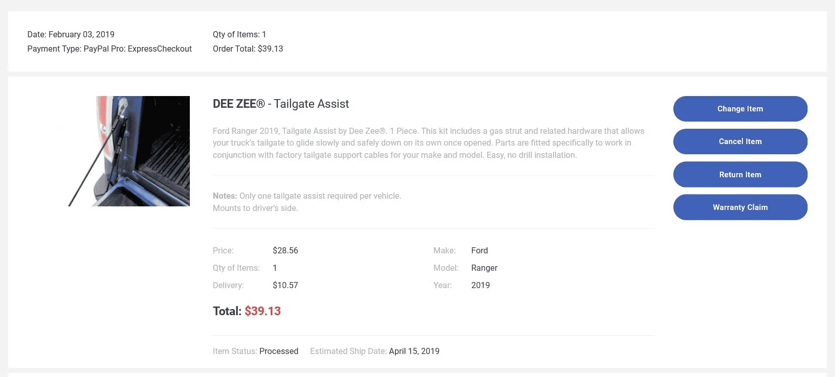

FYI, I ordered this back in January and I got a second call a few days ago - they are not expecting it to ship now until April. This was from carid.com

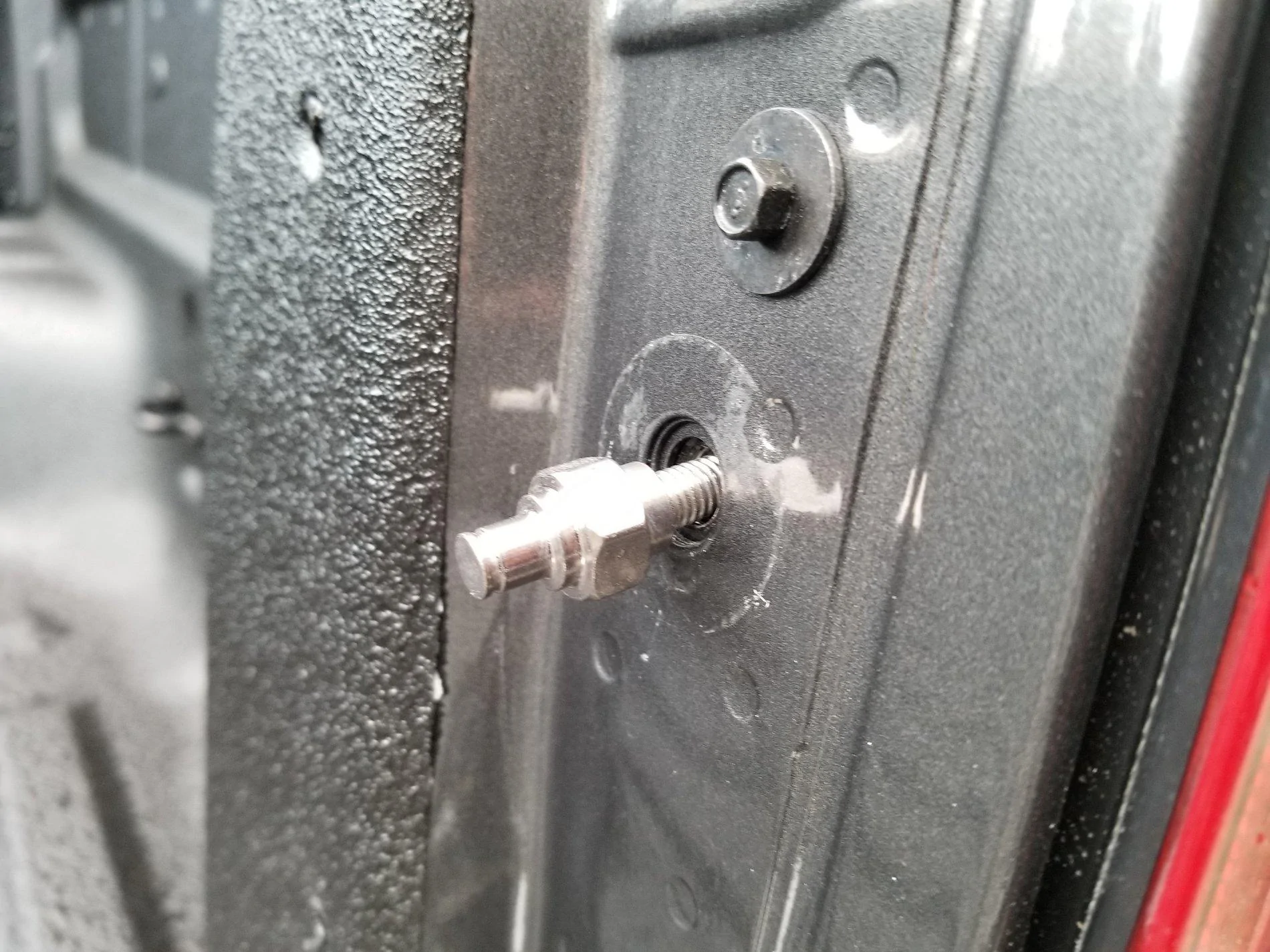

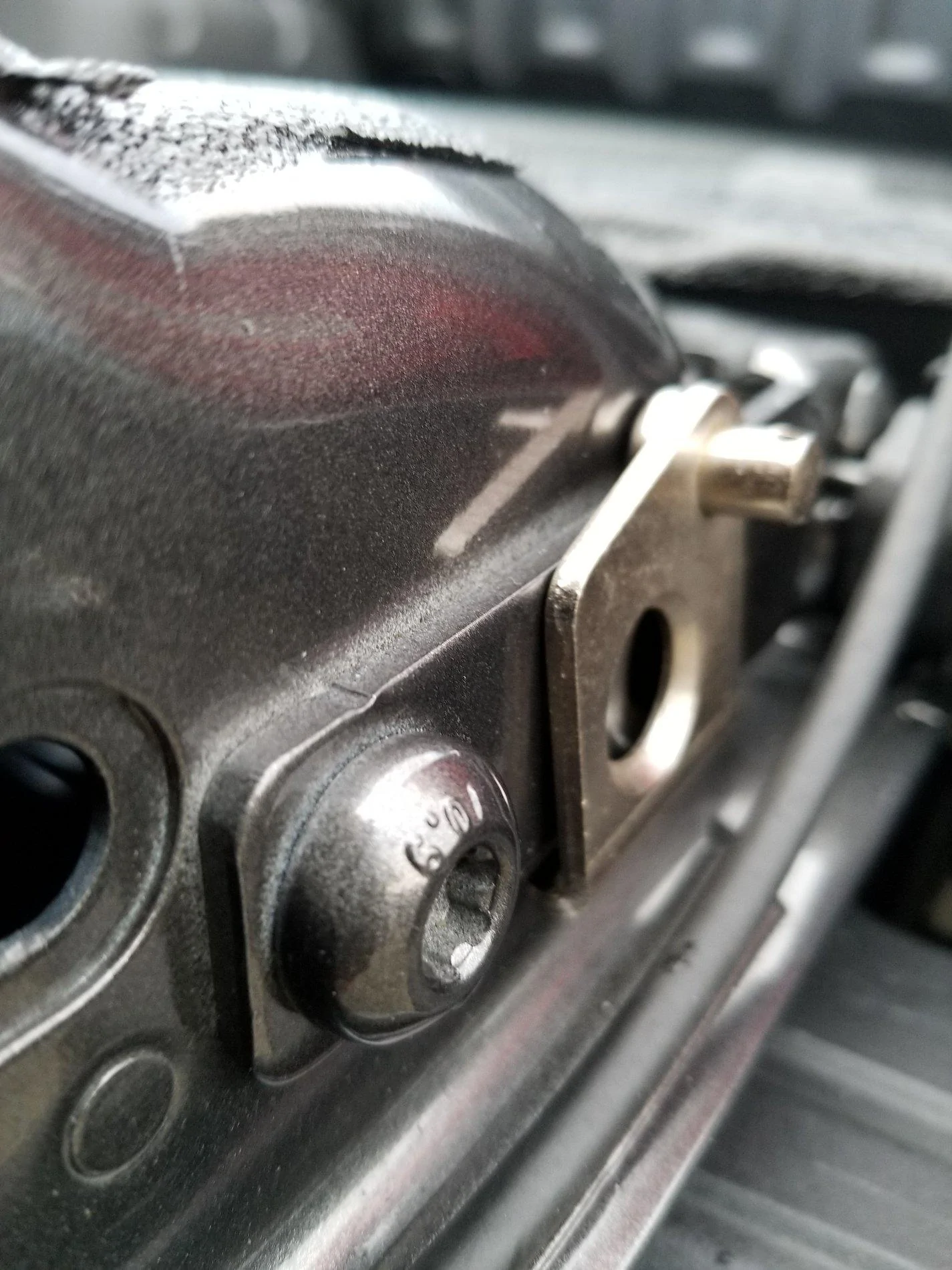

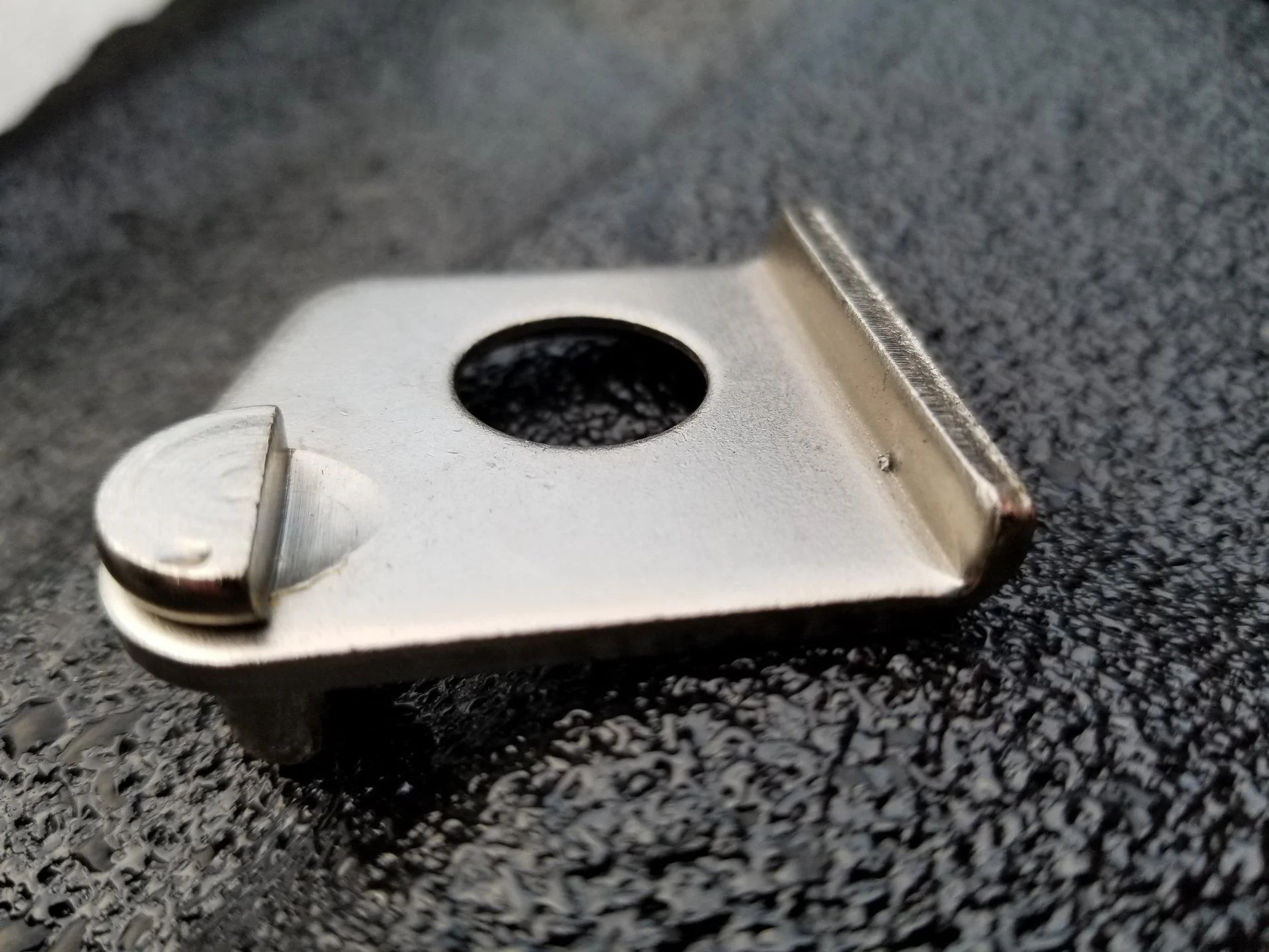

I thought I'd give one of the international T6 Ranger kits a try that I find so plentiful on Ebay. Not sure if anyone had covered it yet, but figure I'd share my results. Unfortunately to my dismay it didn't work.
This is how the kit is supposed to mount:

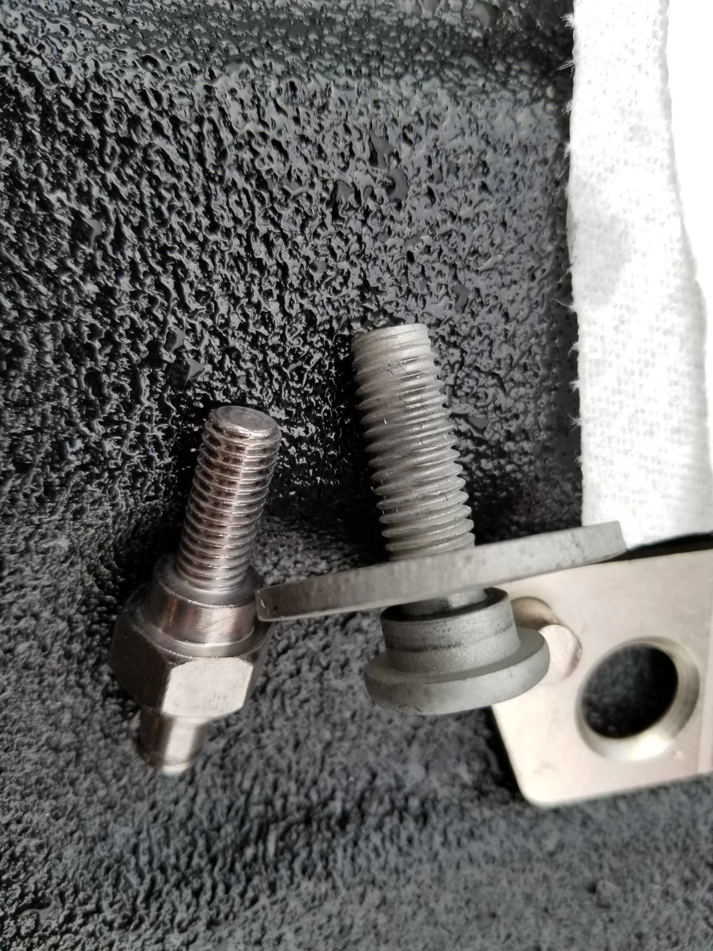

The position/location on how it would mount is right, but the tailgate cable is flipped on the US version. Also note the black bracket on the 2nd picture, something we don't have. That in itself isn't a problem, but the Torx 50 bolt on the top side is a larger diameter than the one supplied in the kit.
In addition, it appears the latches that secure the tailgate to the body are different than the ones internationally. The bottom bracket for the damper didn't fit on the latch properly.
Kind of a bummer, but the price for the damper was only $16USD shipped. Despite those obstacles, I'm pretty confident I can make it work. Looking behind the tail lights, I found room for a bolt to fit if I mount it similar to how the Dee Zee is done.
