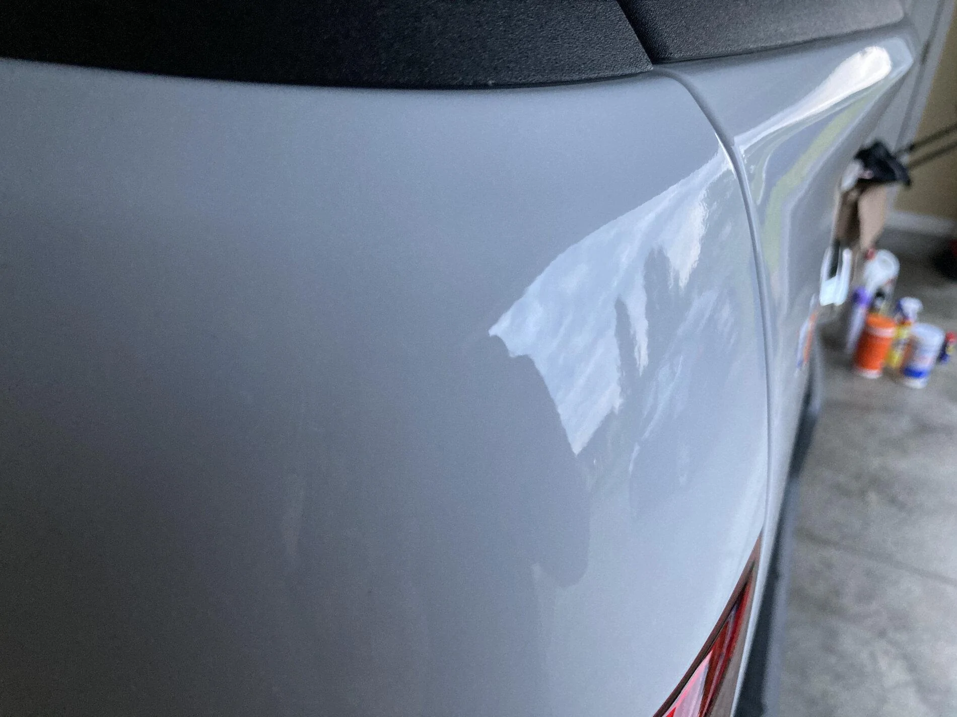

Well, y’all...thank you for all the replies And props to runbeerfish. I just gave it a harder close and it was the solution. It pops, like it’s under slight stress, when you unlatch it...but the gap is clearly gone. Not sure it will pose a problem down the road, but it def corrected the current issue. I attached a pic.

Hi Matt,
The tailgate is supposed to close tightly as tailgate rattle is difficult to diagnose but drives an owner up the wall. There is adjust ability in the side latches, so if you think you have to slam it to get it to close take it to the dealer. The slight pop you feel is very much a good thing to say you have a well adjusted tailgate.
In the 4G Ranger, and likely this 5G too, the tailgate strengthens the rear of the pickup box when in the closed position. Keeps the box sidewalls from flexing. Been many years ago when we were concerned about the proliferation of tailgate "nets" for "aero". So we ran durability on an F Series with no tailgate....rear box metal fatigue was not pretty.
Tailgate down for better Fuel Economy is a myth and has been addressed on these forums. I verified this in the Lockheed wind tunnel as well on a 4G Ranger.
best,
Phil Schilke
Ranger Vehicle Engineering
Ford Motor Co. Retired

My new 2021 XLT also had that -- on the same side. It was not normal. On opening, the tailgate practically leapt out, it was under so much tension, unlike any other tailgate I've had.
1) I pointed it out to the dealership on taking delivery (factory order), and they scheduled an appointment to repair.
At home, i checked the cause: the bottom pivot point (which is not adjustable) was 1/4" closer to the truck on the driver's side, so the tailgate was not perpendicular to the sides.
The body shop said it was not perfect -- but did say that if I slam it hard it will close all the way. "Did i still want it worked on?". I mentioned that a driver shouldn't need to loudly body-slam a tailgate in the middle of the night, so I asked to continue.
They did what they could; but still 1/4" off. I asked what adjustments were available, and at home re-did the adjustment so that one side is 1/8" in, 1/8" out. That looks okay enough, and seals the canopy. Due to the pivot point placement mentioned above, this is the best it will be.
2) Just a funny story. The same occurred with its corresponding new Snugtop canopy. The driver's side would not latch. Someone at the factory had actually tried to bent the latch brackets as a hack, and it looked like quite an amateur effort (bent / distorted, and still not working).
The root cause looked to be the canopy molding: the bracket seat was tilted, compared to a flush surface on the good side.
The canopy shop fixed it. But in another appointment, they replaced the rear window (bad fiberglass cast on the original), which brought the issue back.
This technician kept trying to tell me that it was fine, and I just needed to slam it. I feared he'd shatter the glass, the slamming was so hard.
I kept showing him a normal closing pressure, and how it wouldn't engage.
In response, he kept slamming it, until it latched, and looked at me expectantly and would say "Look, it's working. This is normal."
This cycle repeated itself a few times.
Finally, to say the obvious, I said: "If one side can close with a normal pressure, why shouldn't the other side be able to close with the same pressure?"
At this, he paused, thought for a second, then nodded and without word took it in to fix. He brought it back 5 minutes later; it's fine now.
