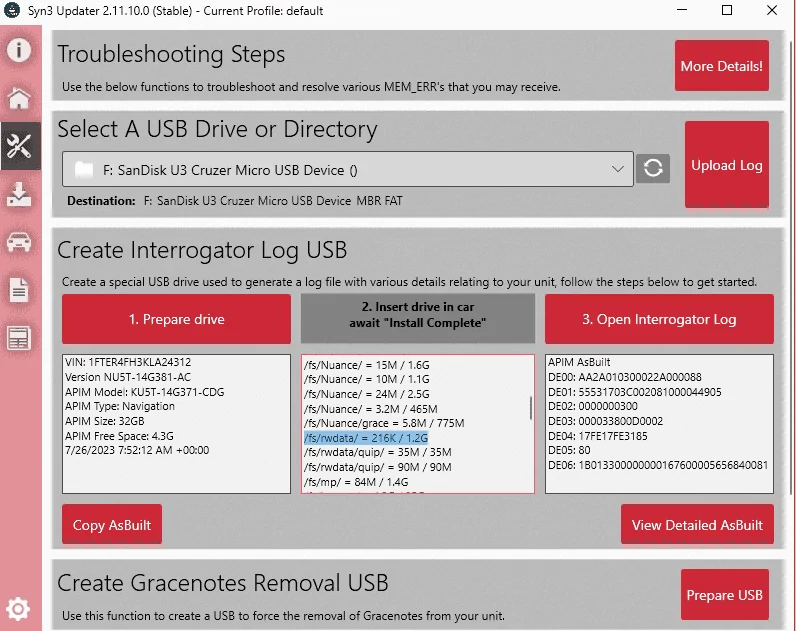

For those of you having the problems with Sync not remembering your day/night/auto settings, or what your last audio source was, and soforth (as many have reported for the past few pages) there's a lengthy thread on an F150 forum that eventually led me to the writeup on Cyanlabs that explains the problem as well as the potential solutions.
I can't get Cyanlabs' Syn3 Loader to work on my old Mac running Windows via BootCamp so I did the jailbreak solution since I've already got FORScan working and a so on. It was shockingly easy. One thing that doesn't seem well explained is that you don't actually have to install the mods_tools in order to install the rwdata Cleaner.
Depending on your MY, Sync version, familiarity with Syn3 Loader, etc these may or may not be viable options but it seems like Ford is a crapshoot as to whether you get someone familiar with the problem and they're either replacing APIMs ($$$) or just telling people to wait it out.

The most perplexing thing is that the "fix" in 23088 seems to be compressing the log files rather than rotating them / deleting them. Which will probably make the problem really unlikely, but it definitely doesn't solve the root cause of filling empty space with log files.
