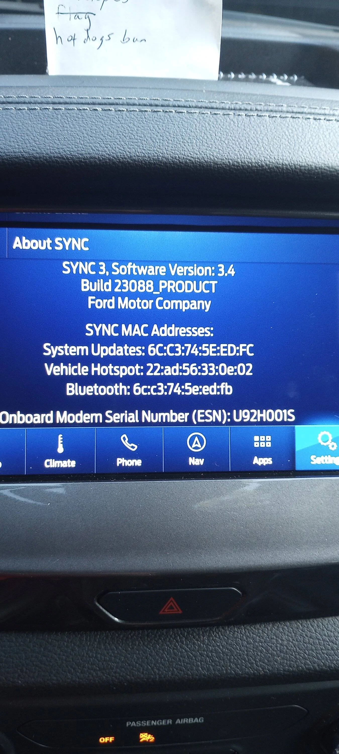

I guess I should note that when I upgraded to 23088, I still chose keep my maps. I did not deselect any options presented. So it should have installed Gracenotes, Voices and Apps.

I think that's the same error I was getting. The part where it says to download and try again is why I fought it for 2 days. I thought it was a problem with the files on the USB, or a problem with the USB itself. So many downloads and several different USB devices later, I finally read Cyanlabs forums. Hope it works for you.
Success. Thanks. I'll test it out this weekend. Sure seems snappier out of the gate.

I was getting the same error message but after several attempts at a master reset I was able to do a reset and install 23088 sucessfully. So far my screen is staying in dark mode and the radio is not reverting back to whatever AM or FM station I was listening to prior to XM. So, if I was listening to XM it comes on to XM at startup now but does go to the ID screen.
I do wonder what factor a weak cell signal plays in all this reset stuff as I was in town taking a class and went out to my truck on break and was able to do the reset.
