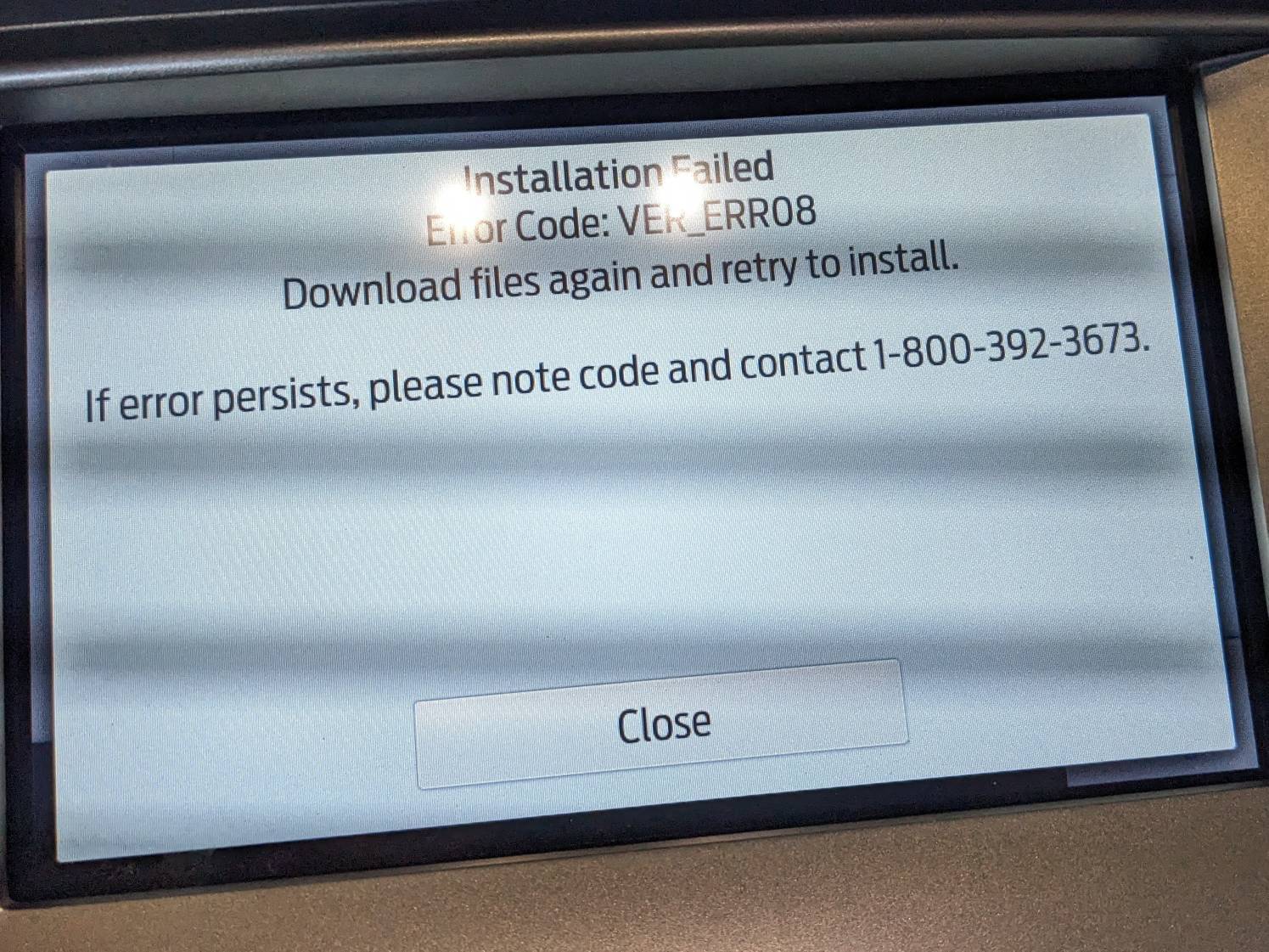

Gonna have to try this because I tried 3.4.23088 last night and then 3.4.22200 this morning and both times got this:

I think that's the same error I was getting. The part where it says to download and try again is why I fought it for 2 days. I thought it was a problem with the files on the USB, or a problem with the USB itself. So many downloads and several different USB devices later, I finally read Cyanlabs forums. Hope it works for you.
