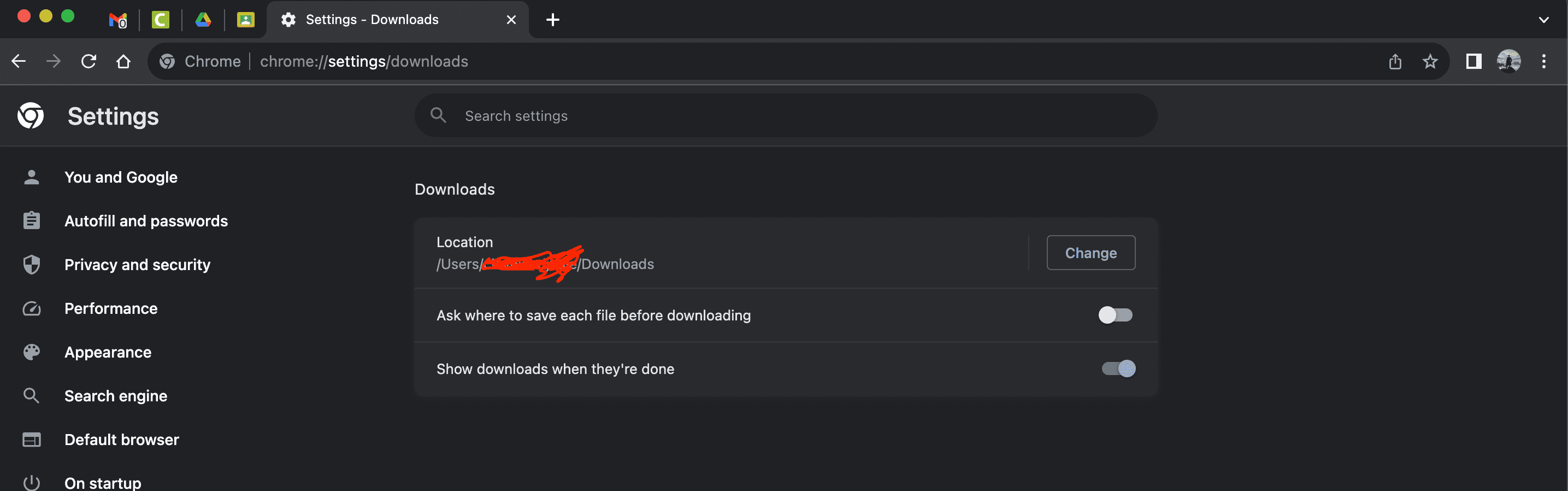

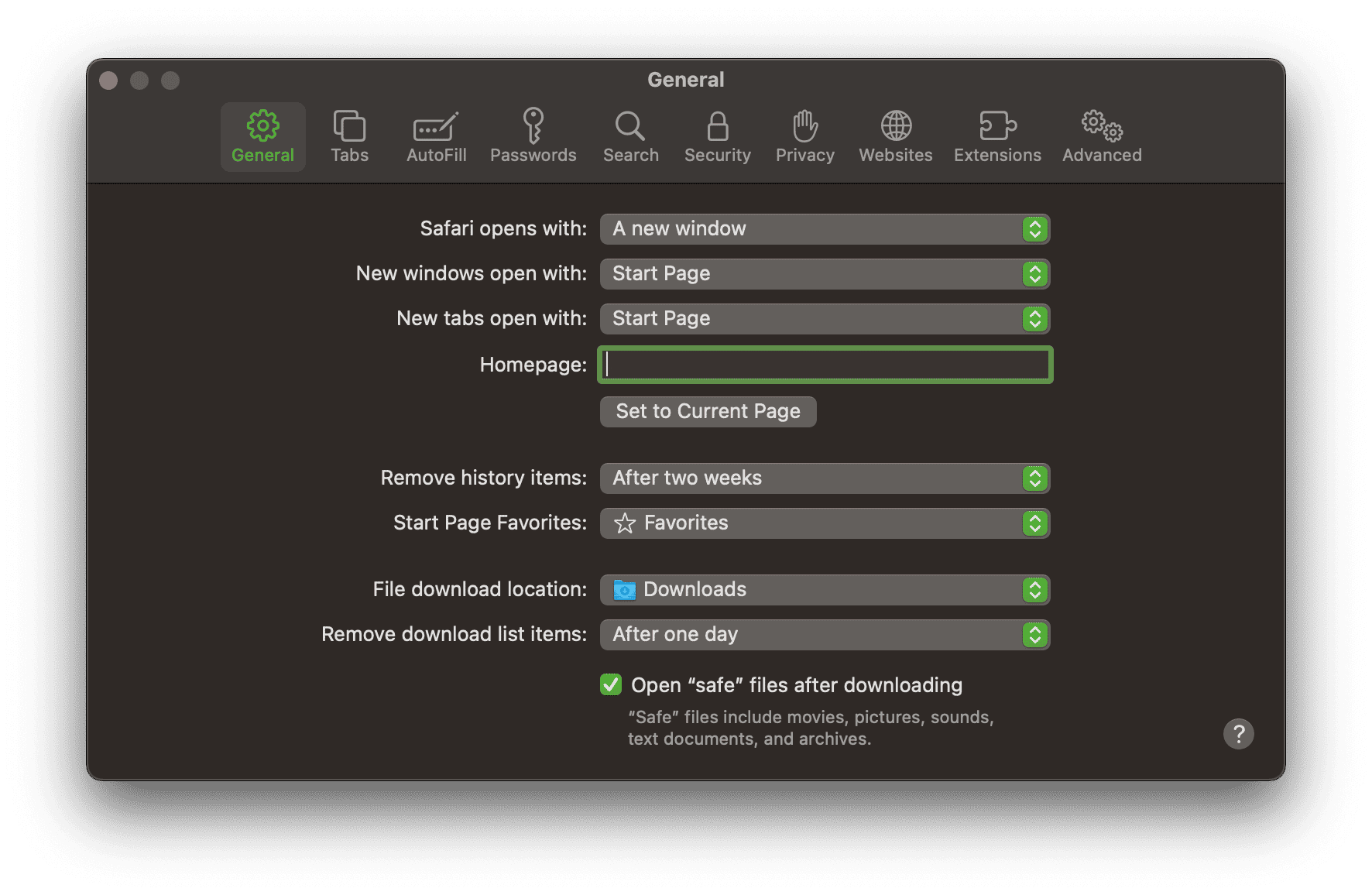

Question about this tip.....when does it ask you where to SAVE? When I push Download Update, it just starts downloading without asking me where to save. Thanks.
Unless you've specified somewhere else, most browsers just default to the "Downloads" folder.
Safari:
Chrome:
Safari:
Chrome:
If that's the case, it seems like I can't remove the ".zip" before saving. Not sure I understand what that does anyway. Will the update not work if the .zip isn't removed before saving as suggested?
I use Safari and I may have set my preferences to ask every time where to download
It makes it so a zipped file will not automatically unzip.
See the screenshot that was provided?
just below the red blob there’s text how to handle downloads
