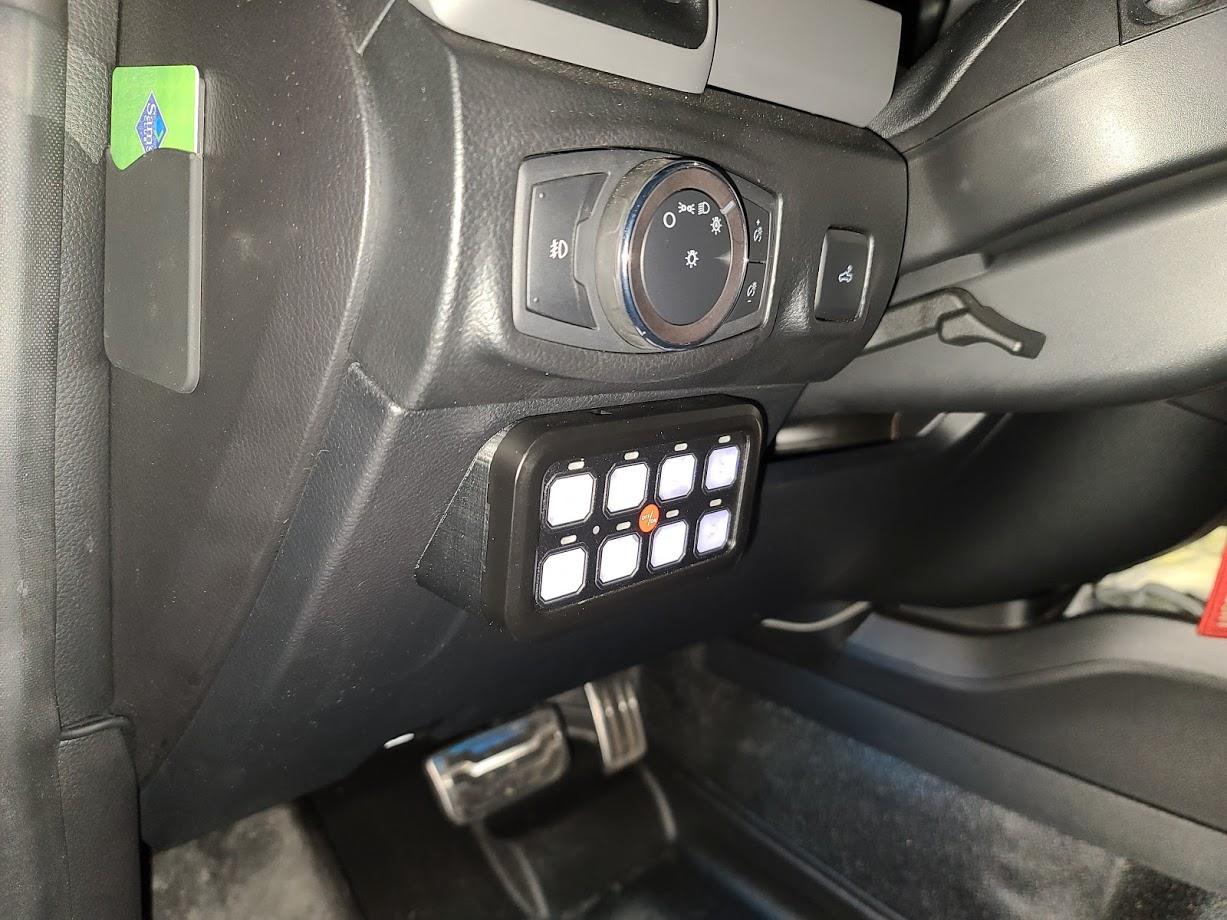

Stedi AUS. Snaps into place in seconds, completely non-permanent, super easy to wire to
Have you got an image of it in your truck? I'm just interested to see what it looks like in the NA model. I was wondering if the buttons are angled for a right hand drive or are straight out?

That pic in my OP is of the panel in my NA model truck. They are straight out

And with one simple change, in my opinion, that switch panel is so much better than LightForce. Adding that angle makes button visibility and toggling much more natural. Got a link?

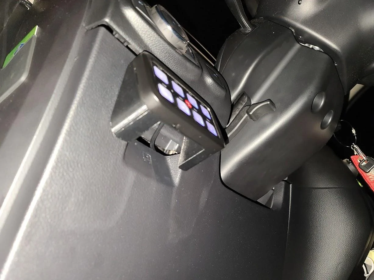

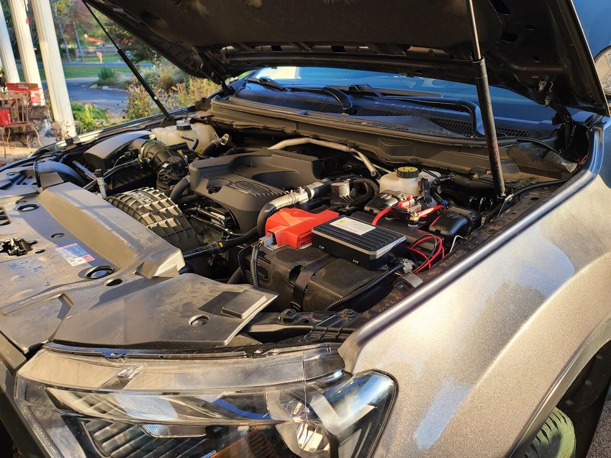

@emkeiz how did you route your wires to get there? I'm not too experienced with wiring but this seems like a better looking and cheaper option than trigger but the trigger seems very easy since you don't have to bring wires into the cab

Hey there! The wiring is super easy as long as you know the basics. The way i routed it required no additional removal of interior panels. At the back of the switch panel, the wires can be tucked behind the panel beneath the steering wheel. From then, i went through the existing rubber grommet in the firewall and to the battery, lightbar, & keyed fuse. I think the hardest part of the whole install was getting through that rubber grommet, but with an extra set of hands it worked well.
