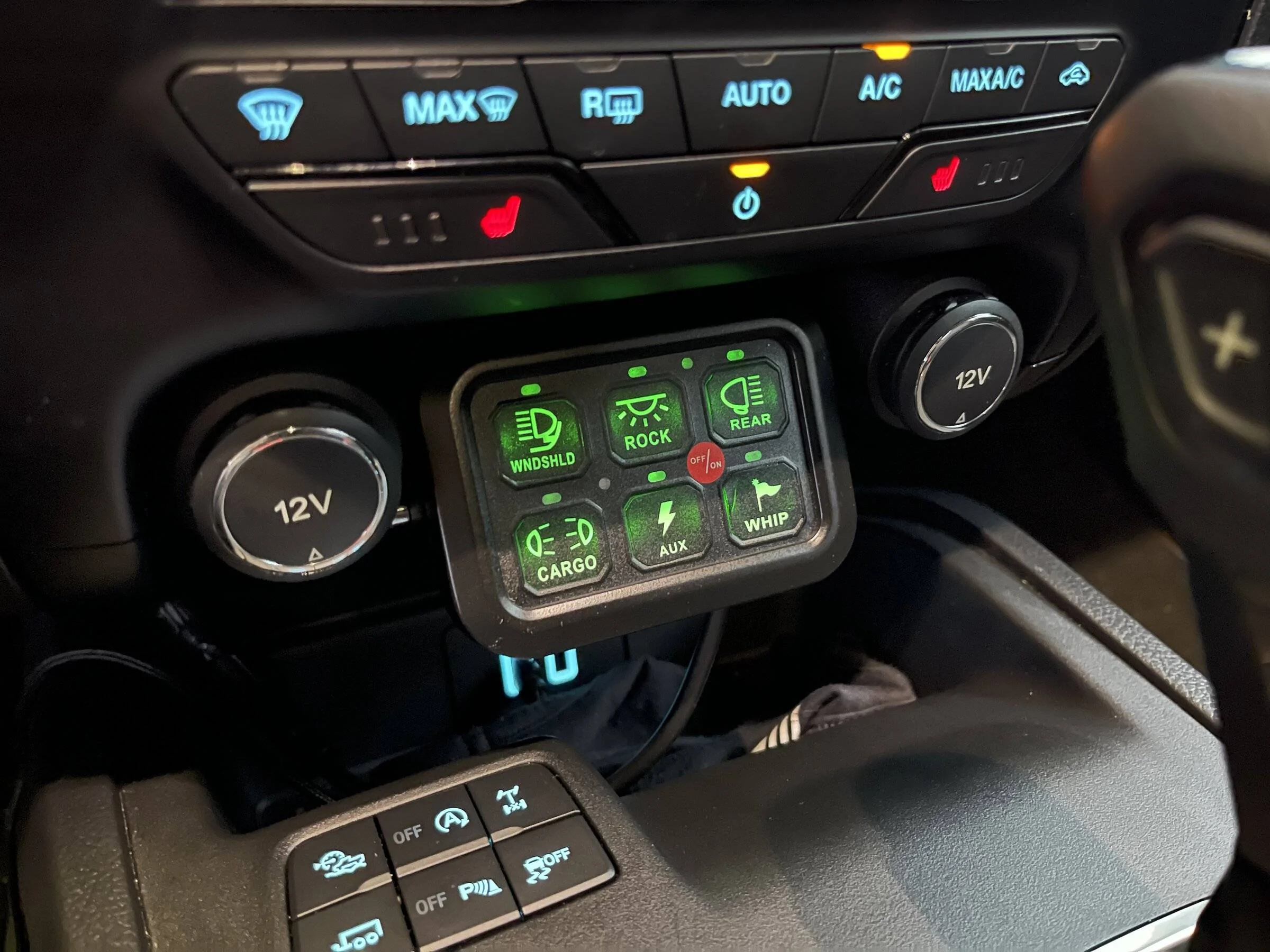

@McLeadslinger Thank you for the little hints that made this install easy and 1 or 2 less trips to the parts store, only made one and that was for the micro add-a-fuse on the way home.
I wired up the left and rights separate, I don’t have a use for 6 outlets yet. When oncoming traffic comes I can switch off the left only and keep the right burning. The most difficult part was drilling the outboard hole for the switch box, odd angle and hard to keep the bit from walking.

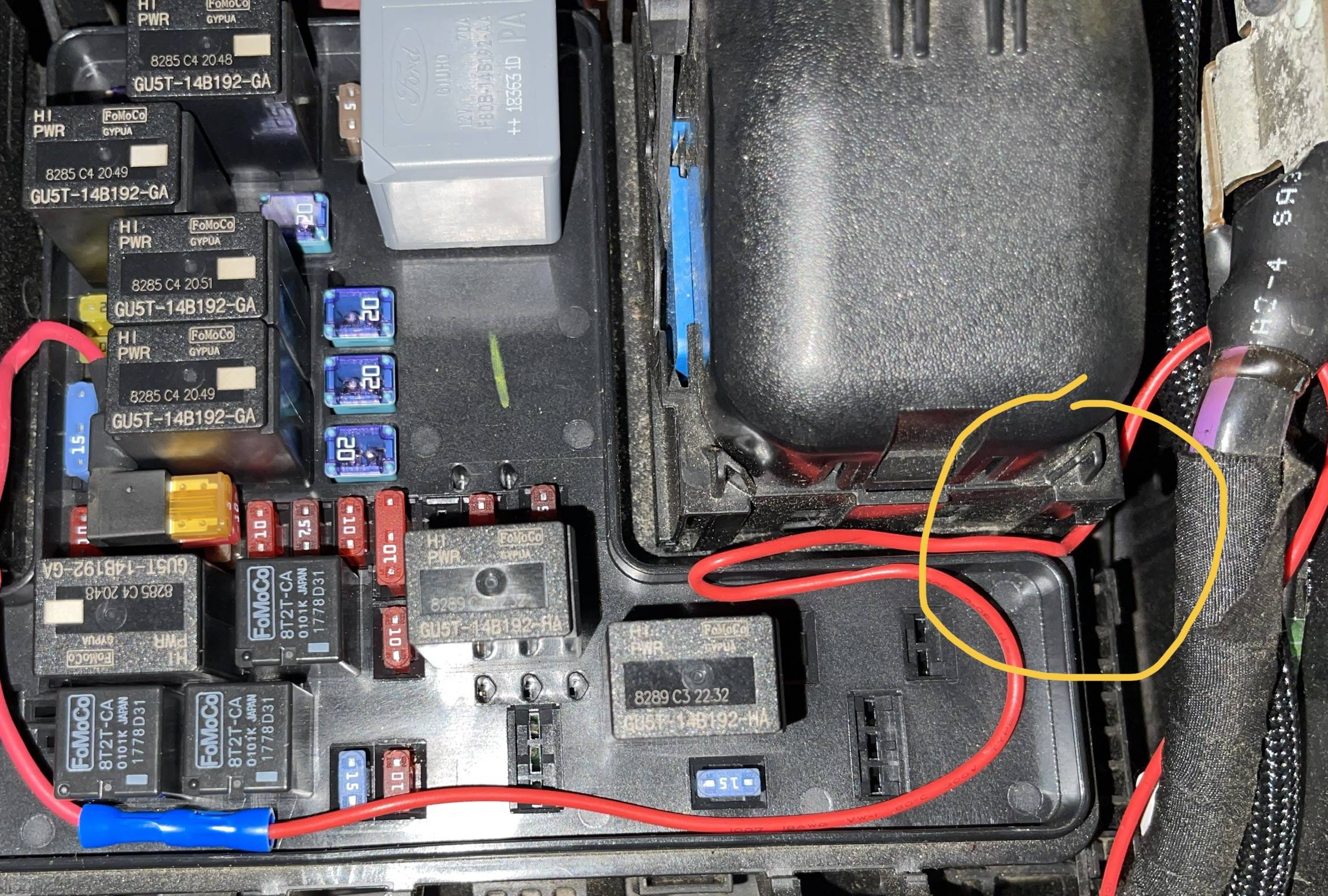

Install was pretty straightforward and the result looks great. Only tough part was getting through the boot of the firewall.

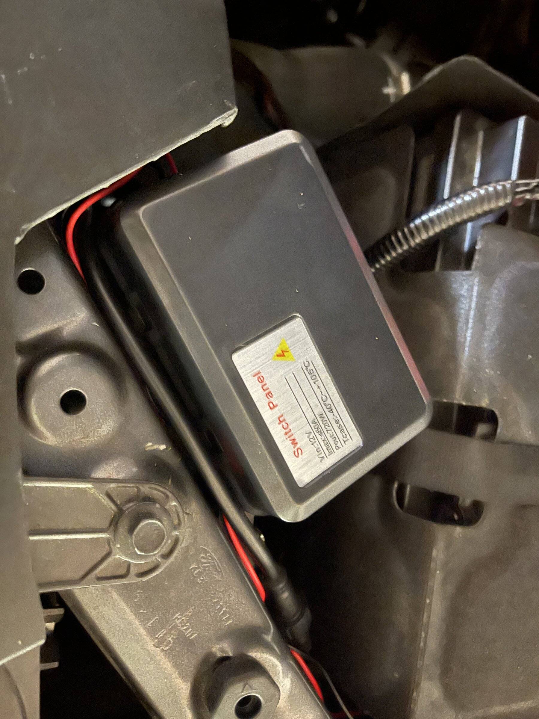

This looks great - Where did you find room inside the engine bay for the switchbox itself - I have the 21 Ranger XLT 4dr

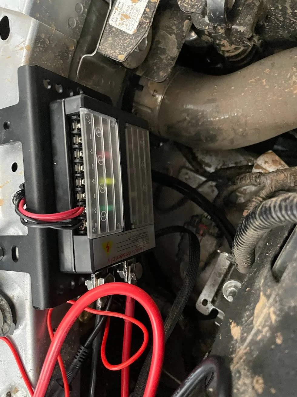

What kind of brackets did you all use to mount the switch box in the engine bay? I would like to not drill holes and use existing holes to mount the box.
ylwjacket
Jan 18, 2023
259
742
N. GA
2019 XLT FX4
I zip tied it to a few existing holes in the cross brace. They wouldn't have lined up for screws, but you have a little more leeway with zips.
It's nice and tight, works fine.

Anyone install theirs up on the headliner center console area? Looking to install mine just behind the map lights but in front of the sun glass holder
