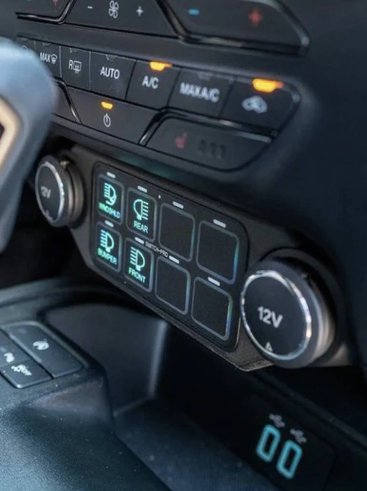

I placed the same 2 switches here.......

The housing only holds 2 switches. I don't plan on adding any more so that's good enough for me.
Here's the housing...............
https://powerwerx.com/two-hole-panel-mounting-pod
You can also find them on Amazon if you prefer to shop there.
The housing fits perfectly. You just have to point the holes up towards you and move the edge up towards the square openings. Once you find the perfect spot, mark the holes, drill, and use a screw with one washer and nut. You'll have a secure installation.
You will also need this...............
https://powerwerx.com/panel-mount-blue-switch
Not the switch, the housing it's in. Again, you can find these on Amazon.
You will need to drill a hole for the wires to come through the panel to the mount.
Here's what I used.
https://powerwerx.com/hole-saw-for-panel-mount-accessories
Get these after you make the hole.
https://www.amazon.com/gp/product/B07HLRKMNF/ref=ppx_yo_dt_b_search_asin_title?ie=UTF8&th=1
USB port... Again Amazon has a similar port.
https://powerwerx.com/panel-usbc-pd-power-delivery-qc30-blue
Hope this helps. Make sure you know what you're doing before you drill any holes.

they look nice how do they work?
The DD SS3 Ditech lights, Amber backlight, are switched on (either backlight or main beam) by one of two Switch-Pros 9100 buttons.
