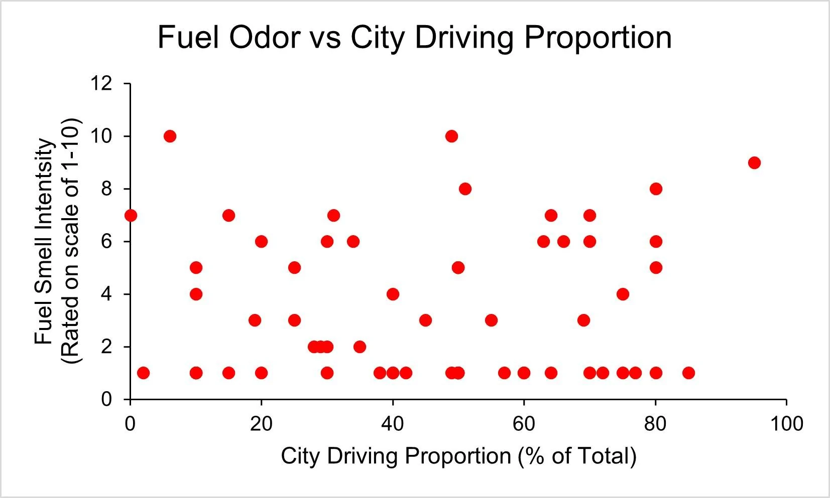

I took a look at city vs highway usage in a variety of ways. No matter how I look at it, I see the same thing, so here's the first graph I made:
Zero correlation between the amount of city driving folks are doing and the amount of fuel sticking around in the crankcase. I must admit, this one surprised me.

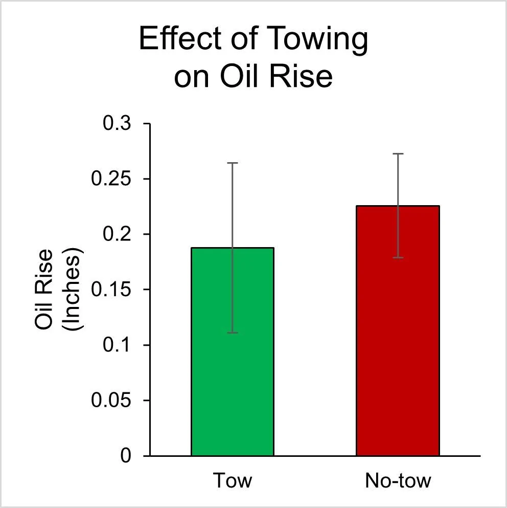

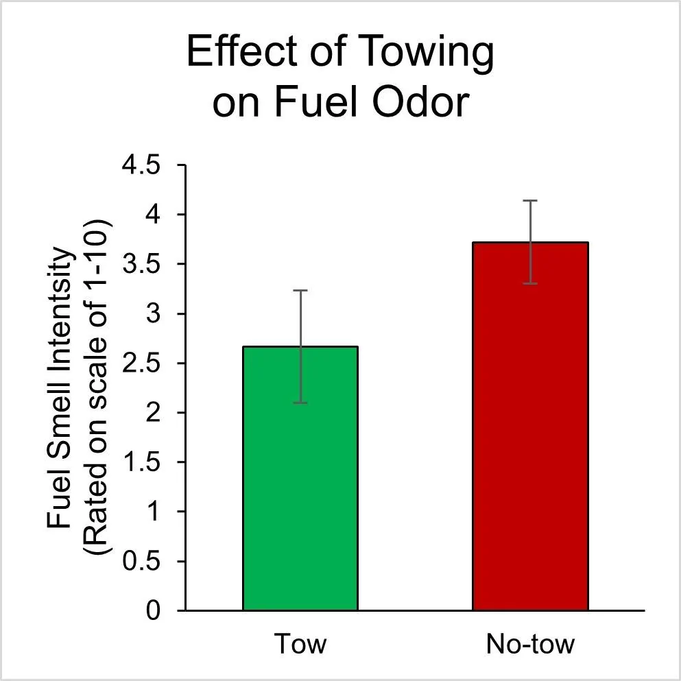

That same question on the survey also asked about towing. The scatter plot did look a little like there was an effect that is best observed with a breakdown of binary towing vs non-towing, regardless of amount towing reported:
Any difference is relatively minor, but the trend is definitely there. At the very least, towing isn't making things worse.

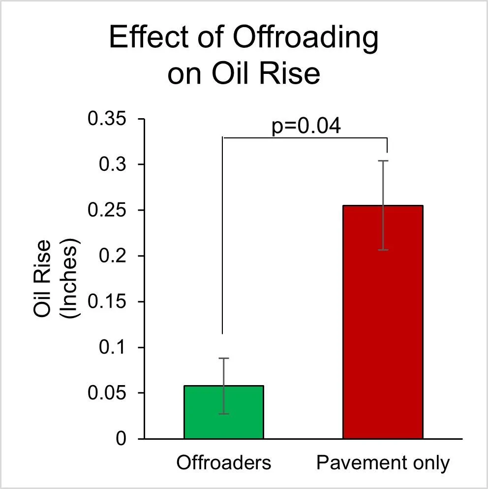

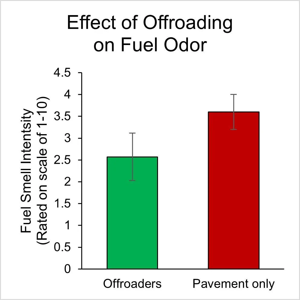

The bigger surprise was the offroaders:
Recall from my earlier post that trucks with the FX package don't seem to have quite as much dilution. I suspect these two observations are related.
A picture is building that working your truck (driving it further, getting it off the pavement, towing) is what it wants.

Towing likely results in increased oil temperatures helping to burn off the fuel in the oil.

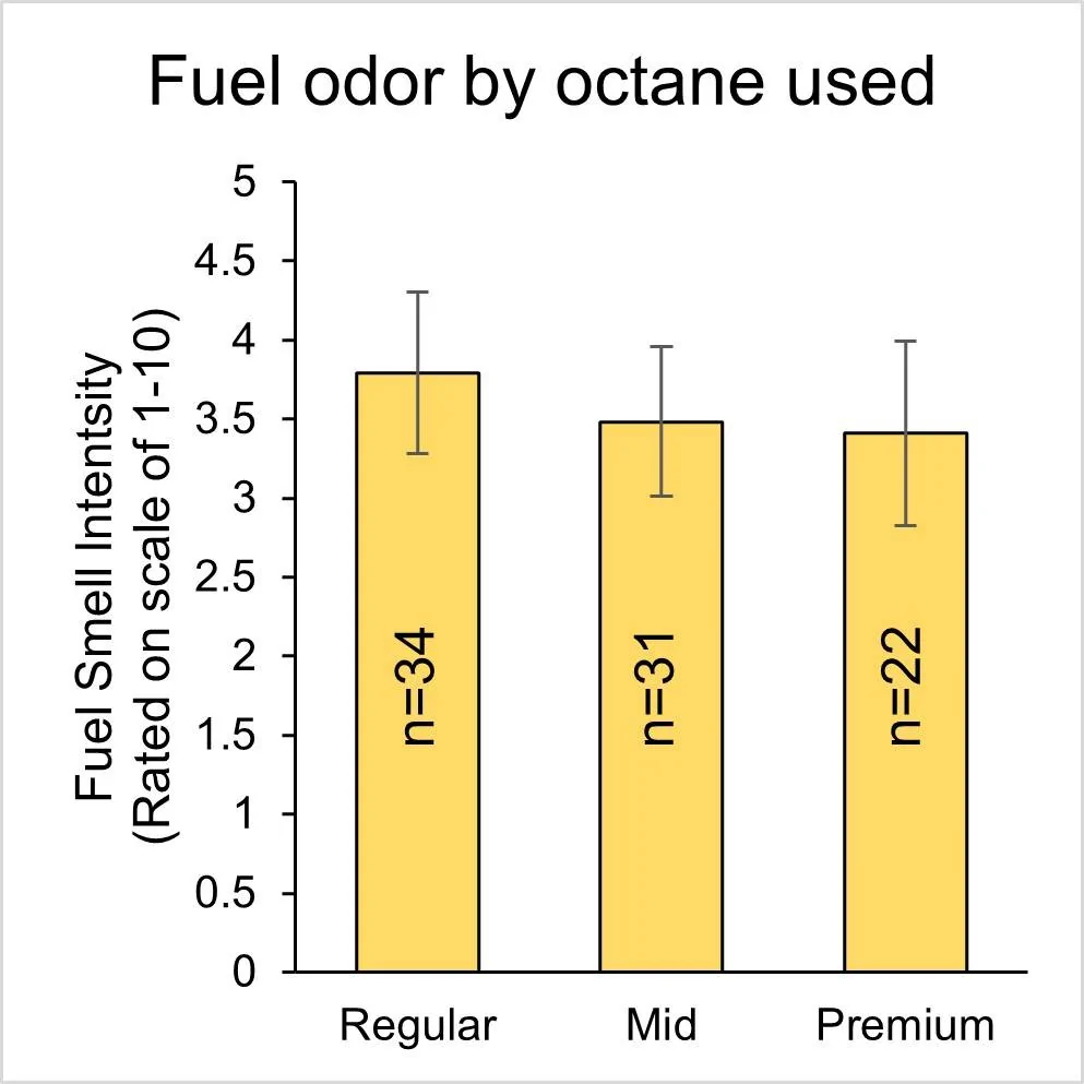

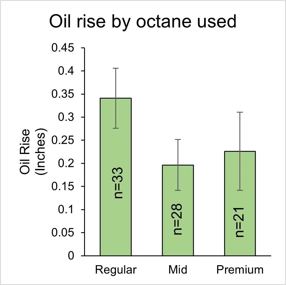

Next question: does fuel octane rating play a role? Here's the data:
For the purposes of this analysis, since I know these definitions are different in different areas of the country, "regular" is 87, "mid" is 88-91, and "Premium" is 92+.
As you can see, there is a slight trend towards lower perceived fuel dilution with higher octane, with the difference being more pronounced in the amount of oil rise. As with most of the parameters I've looked at, there's a lot of variability in the data, so make your own conclusions about whether this effect is real. I could definitely see how differences in combustion and/or computer adjustments to timing could influence fuel dilution, so I'm completely open to this being a real phenomenon. Anybody with fuel dilution who's running 87 want to spend a few extra bucks for a few tanks of premium and report back?
I do wonder if there could be a confounding factor, wherein people who are buying premium are doing so because they work their trucks a little harder (which the previous posts indicate could very well be a factor in dilution). However, I did look back specifically at the towing data, and there's no difference in the prevalence of people reporting towing among the "regular" users versus the higher octanes.

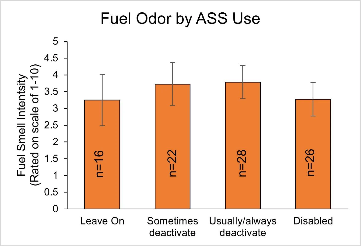

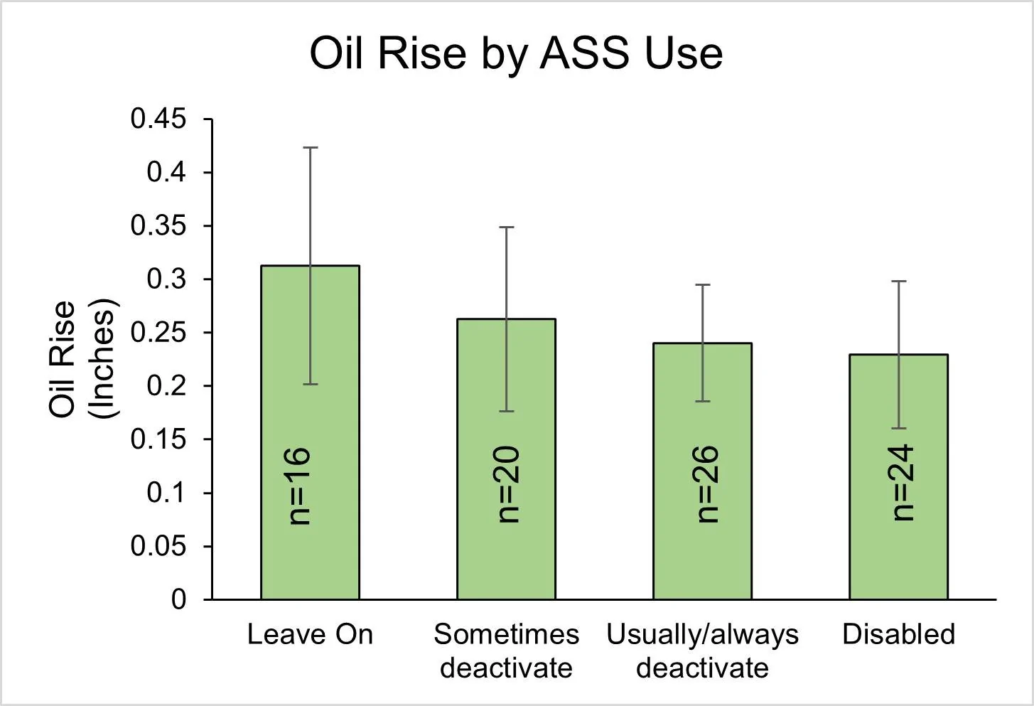

I wonder if their is a difference between owners that use the AUTO/START/STOP feature and ones that turn it off. Thanks for the work put into this survey.
Ask and ye shall receive...eventually (again, sorry for the delay)
No clear consistent trend between the two measures. There is a slight apparent decrease in oil rise with increasing rate of ASS deactivation, but since this is not also observed with the odor, and since there is quite a bit of underlying variability, I'm not inclined to read much into this. Maybe there's a slight effect of ASS use, but, if so, it's contribution to the fuel dilution issue is minimal.
And just to make sure it's clear: for the purposes of this question, sometimes/usually/always deactivate refers to the use of the button, whereas "disabled" means the user has some sort of defeat device in use.
I tried doing a couple of subgroup analyses to dig into that minor trend observed in the oil rise above. When I limited the analysis to just folks who reported >50% of their driving was city (I figured this is the group that would be most affected by the ASS if there is indeed any effect), the trend completely disappeared. Similarly when I limited the analysis to just folks who reported a commute of 10-25 miles (long enough to ensure ASS would start kicking in, but perhaps not long enough for engine to fully get up to temperature), the trend likewise disappeared.
Since cherry-picking situations that should emphasize any possible effect didn't confirm the earlier observation, I'm even more inclined to believe that ASS is not a problem for us.

Thanks for answering my question
