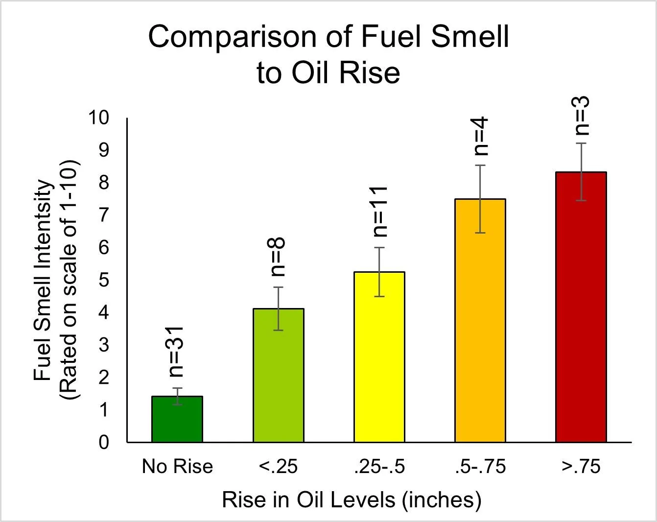

First analysis is a simple one: How well do the various indicators of fuel dilution agree with each other? The survey included questions on a rating of fuel odor severity a scale of 1-10 (with 10 being the most severe), an estimate of rise in crankcase oil levels, and lab-reported fuel dilution.
57 respondents answered both the fuel smell and oil rise questions. Of those, 31 (54%) reported no rise in crankcase levels, 8 (14 %) reported a discernible rise less than ¼ inch, 11 (19%) reported a rise between ¼ and ½ inch, 4 (7%) reported a rise of between ½ and ¾ inch, and 3 (5%) reported either a rise of ¾ - 1 inch or a rise greater than 1 inch. In general, a greater rise in oil levels corresponded to a higher reported intensity of fuel odor (Figure 1), with an r2 of 0.65. This is much better correlation than I expected, as I thought the fuel odor intensity was too subjective to be meaningful.
Twelve respondents reported lab data. Unfortunately, the only people who reported data were people who otherwise had indicators of fuel dilution, with ten of them reporting oil rise of either 0-1/4 inch or ¼-1/2 inch, so this data is very biased towards a very narrow range of fuel content. In general, those who reported under ¼ inch rise did have lower lab-reported fuel content than those who reported over ¼ inch rise (3.2% vs 4.2%, on average), but the narrow range means the overall correlation is quite poor.
Due to how restricted the lab data is, going forward I’ll be using the self-rated fuel odor intensity and the dipstick rise for the analyses. I’ll probably focus on the dipstick rise, since that should be less subjective.

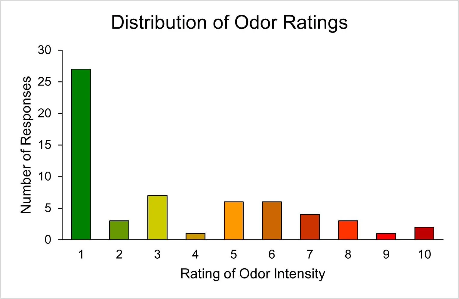

As a quick follow-up to my previous post, below is the distribution of responses to the "fuel smell intensity question," which all 60 respondents answered. It stands out to me that 27 respondents (45%) reported no fuel odor in their oil. Recall from the previous post that 54% of people who checked their oil levels reported no rise. It seems pretty clear that there's a lot of Rangers out there that don't have fuel dilution issues at all, so what's different about the Rangers that do have dilution issues? Stay tuned as I keep digging through the data...

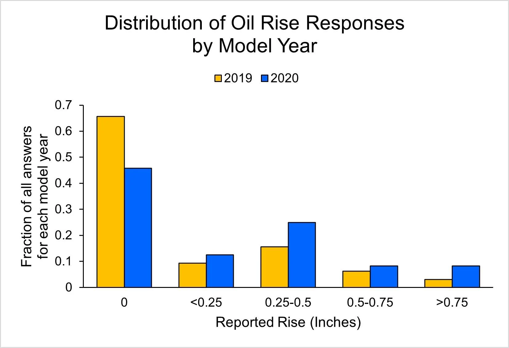

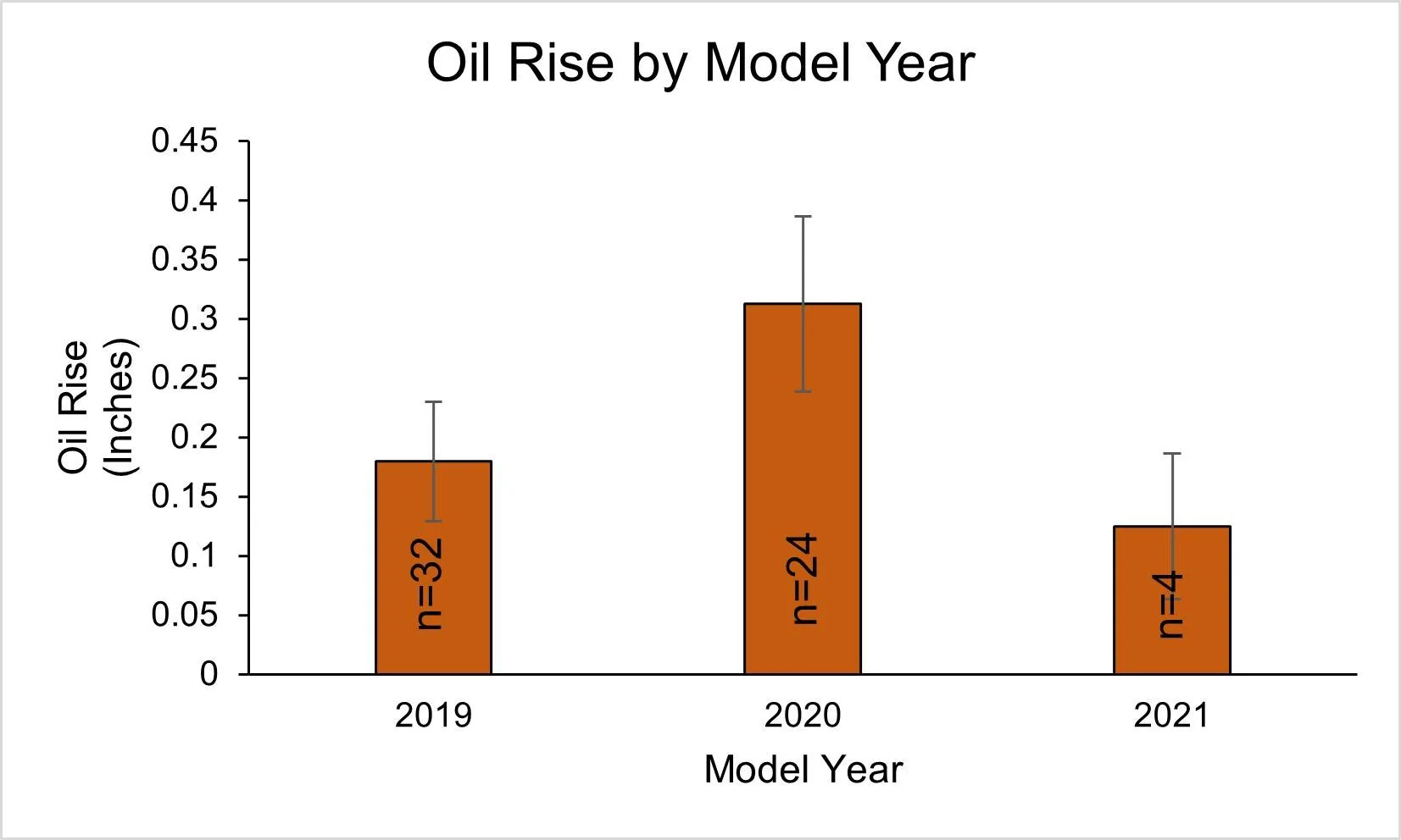

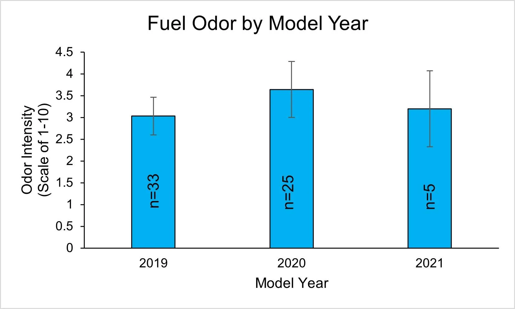

Next up: model year. Have there been any changes made to mitigate the problem? Survey says...no. Based on people's perception of the fuel odor, there is no difference at all between the different model years. Using oil rise as the measure, the 2020's look worse than either 2019s or 2021s. This is due to a slightly higher proportion of 2020 owners than 2019 owners reporting rising oil, but among those who report rising oil the severity is the same between those two model years (See the third graph below; I've excluded 2021 from this graph due to the small sample size). I'll keep on eye on the 2020s as more responses come in (we're up to 64 now), but I don't think this is anything to get excited about.
