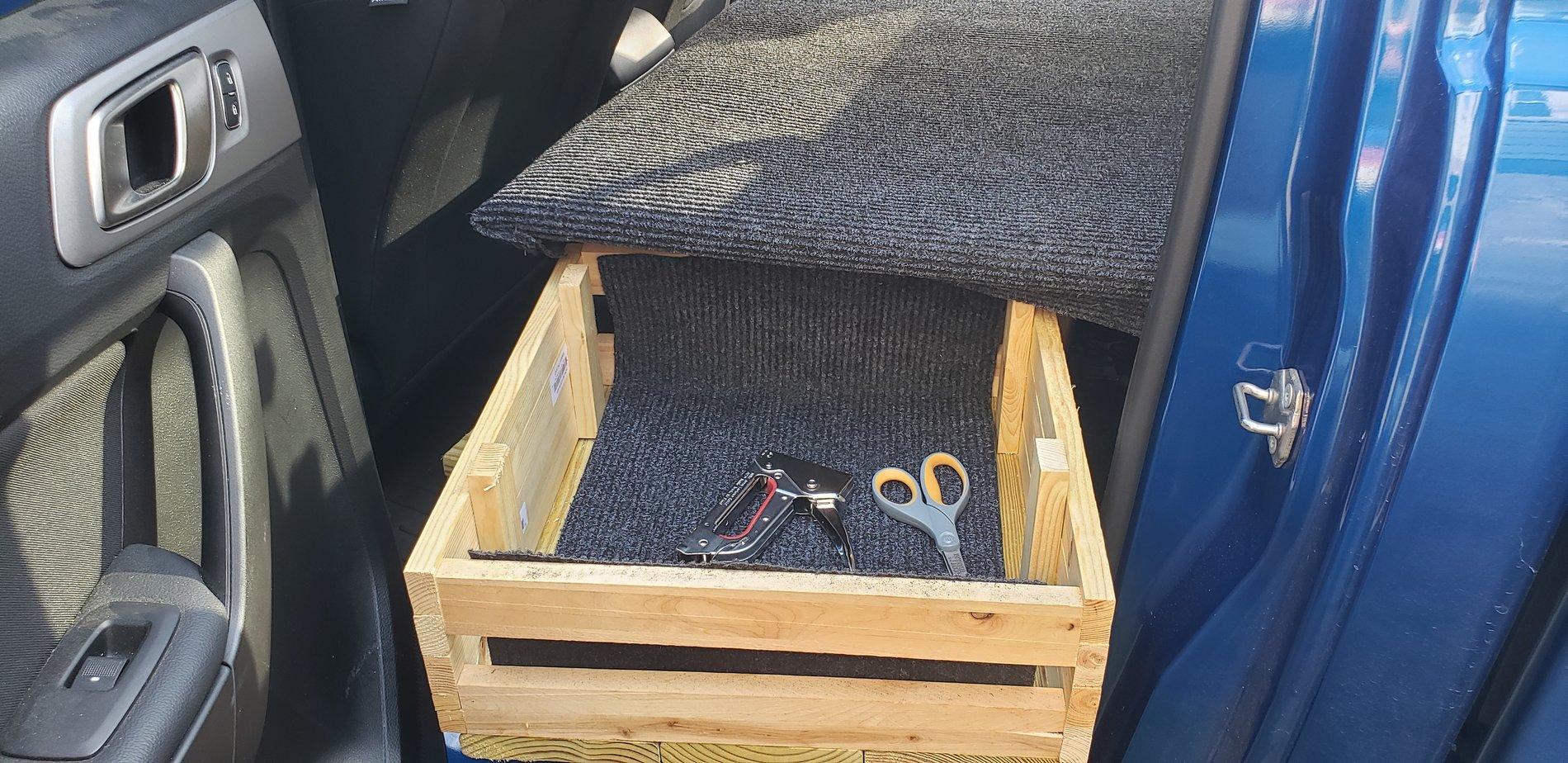

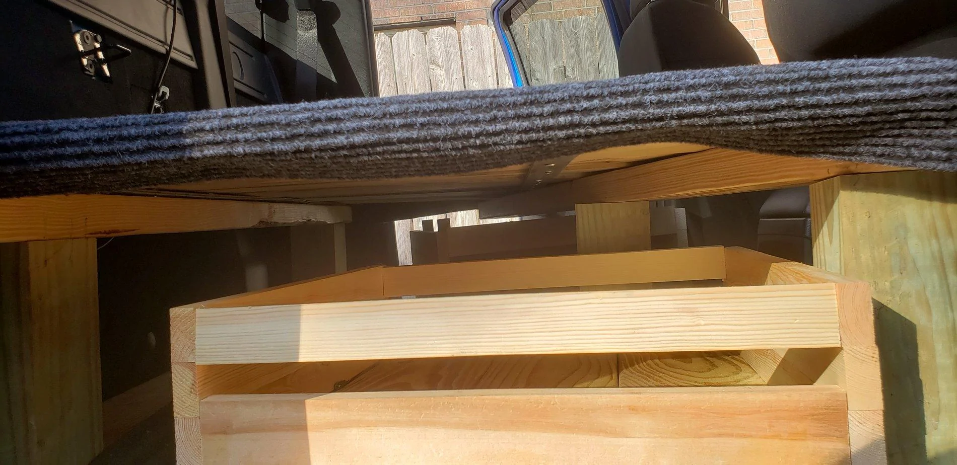

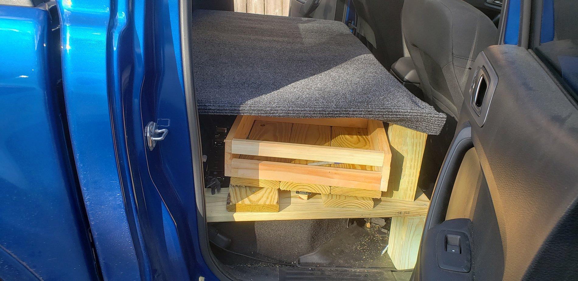

Day 4 consisted of the top platform and having to re-work it from my original idea. Nothing major, I just had to re-do where the supports were. I completely took Saturday off and did some minor adjustments on Sunday. Today I decided I was happy with just about everything and went ahead and got a large utility rug from Lowes and started cutting. I've only done a couple pieces so far, and still need to finish the sides (cut-to-size plywood), but here's the progress so far.
Only thing I really need to add is a gun holster right in front of the power plugs in the rear center console. And yes, I've confirmed it can support all 190lb of me with no sway. My original mockup was a rocking chair ?. Truck is getting lifted tomorrow so I doubt much progress will be made soon. For those wondering, if my math is right, I can hold 7 large pizzas on driver side drawer and 5 on passenger side. Not that I deliver pizza, but that's our new unit of measure.

That's where I'm at right now. Shop had truck all day yesterday and I've been at work all day. Probably won't see any more progress until Saturday.

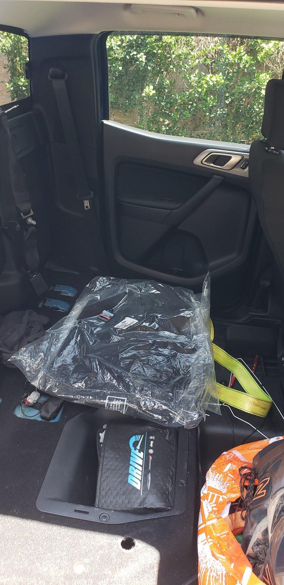

Long time no update. Since the last pictures were posted, I didn't really add on anything else apart from the magnetic gun holster and a tiny bit more 'carpet' to complete the look. 6 months later and about 10k miles in, everything is still holding and fully functional.
Two weeks ago I set out on a 4 day/2600 mile road trip and slept on the platform two nights. The first night I slept on it, I was in the middle of absolute nowhere and it was 30 degrees outside. I had picked up a queen size foam pad, folded it in half, and was able to also roll up a portion of it into a pillow. I also brought my regular comforter for extra warmth/padding. Not going to lie, I slept 6 full hours with no problem and felt great, even given the fact I had to curl up a little bit. Plenty of side space, little tight on the door to door space (head to toe).
I used the driver side drawer to hold any tools and emergency items I might need. The passenger side held all my dry food for the week. Although it's not ideal to grab a snack while driving, I deliberately made the back end of this drawer a little shallow so my hand could fit and grab a snack. It was nice so I didn't have to get out in the freezing rain. I had the cooler in the bed which, of course, held most of my drinks and cold food.
The second night I slept in the back was at a rest stop about 500ft from I-10. Even in the middle of the night I was pretty surprised at how loud the truck was...not as much of an issue while driving, but I don't think it was designed to be slept in, lol. I got about 4 good hours of sleep, which was all I needed to complete the remaining 450 miles home.
All in all, I'm pretty happy with how the thing turned out. It's already paid for itself and proven to be useful and durable, and that's all I can ask for at this point. I'd post more pics of the thing, but like I said, it's basically unchanged from what's already been posted... so here's a couple pics from my trip.

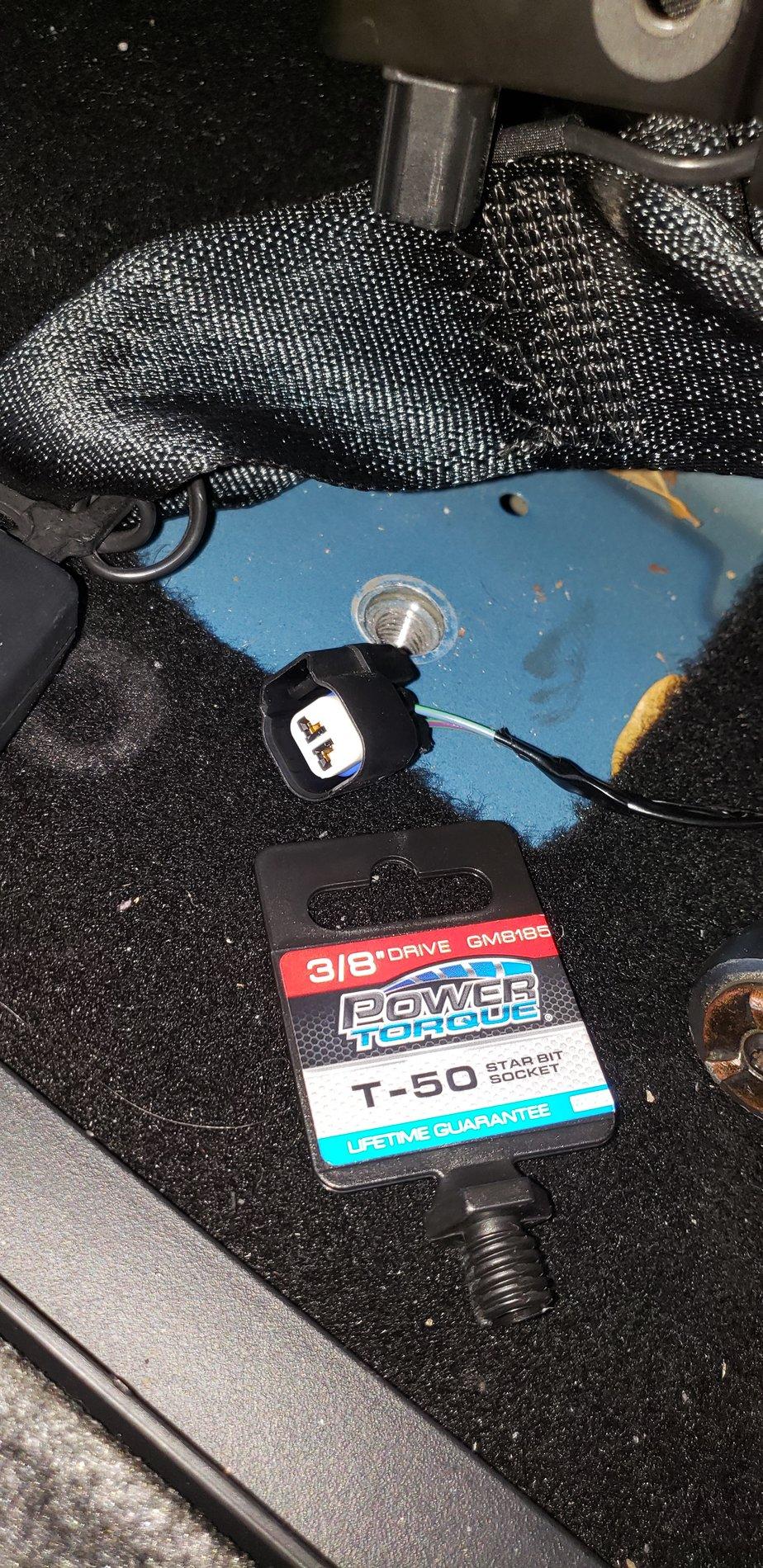

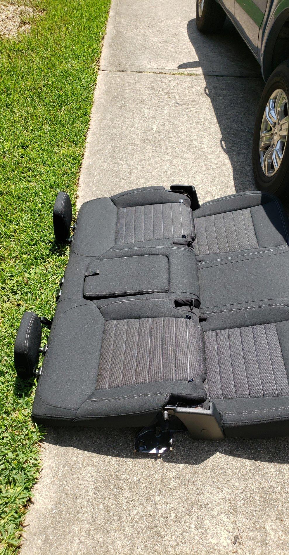

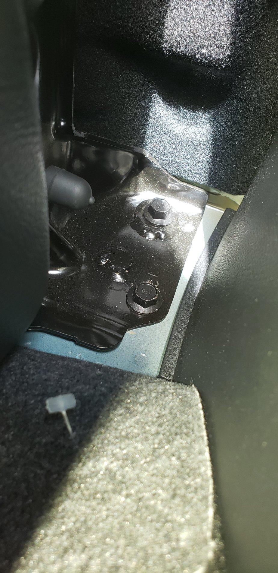

Quick PSA/DIY: removing rear seat is super easy.
All you need is a 13mm(or 1/2 inch socket) and a torx t50 socket. I'd highly recommend a power drill, or at least a 9" extender on your ratchet because there is NO room in between the door jamb.
First step is to fold up the seat bottom. Remove the t-50 bolt that holds the seat belt bracket in place. There's an elastic band holding it down. Just feed the belt up through that (and the other seat belt). There's also one plug you have to undo, the only thing I think it might be for is to monitor if a rear occupant is not wearing their seat belt. Why we actually need that....idk.
There's four 13mm bolts that hold the whole assembly in place. Two on each side underneath a flap of carpet. Undo those.
...and that's it.
