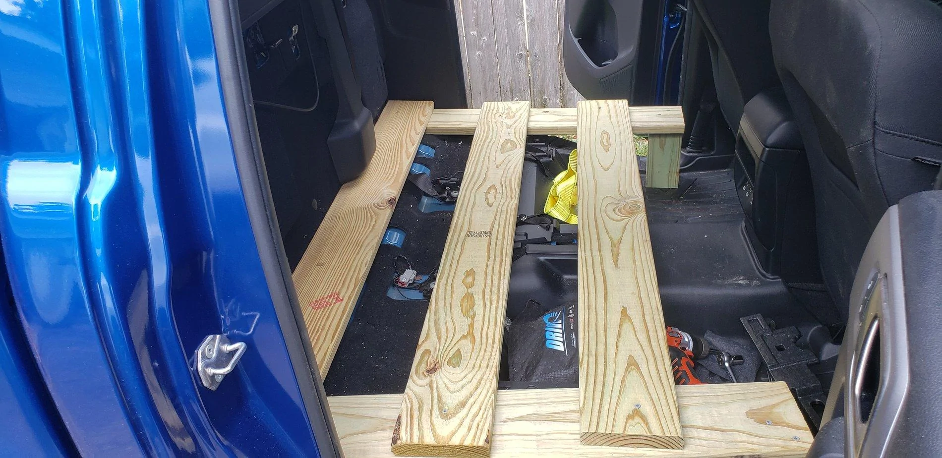

Ok, day two of the build. What I've done so far is just the base of the platform. It's only going up from here. I do plan on putting in a little carpet to hide the rough edges. I had to get just enough clearance underneath for the seat belts, and since the back is already raised up just a bit compared to the middle, I ran the bottom boards sideways (and cut the back edges at about 5 degrees) instead of long ways. I used the seat rail bolt closest to the door to secure the platform to the truck, then screwed a board over the top of the factory seat rail bolts. This gives just enough clearance to tuck the seat belts and wires underneath the platform with no worries. There's still some space to access the little cubbies. Since nothing rigid can really go in there anyway, they're a little narrow but still functional. The boards are treated 1.25"x6", or 1"x5.5" actual size. And 4x4 (3.5"x3.5") supports in the footwell. All 190lb of me is sitting on the middle as I type this, lol. I think I'm going to call it a day for now and do the pull out drawers next. I plan on having them just off kilter since the doors dont open a full 90 degrees-id rather have the extra couple inches of width than the couple inches of length.

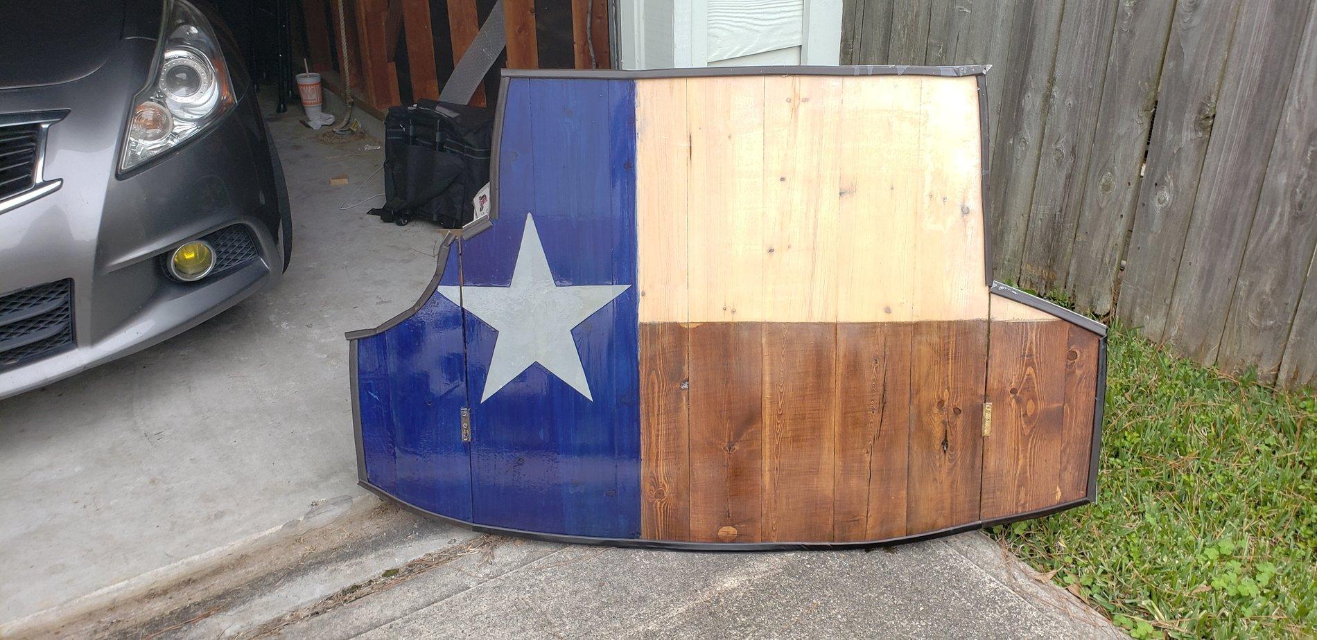

Day 4 consisted of the top platform and having to re-work it from my original idea. Nothing major, I just had to re-do where the supports were. I completely took Saturday off and did some minor adjustments on Sunday. Today I decided I was happy with just about everything and went ahead and got a large utility rug from Lowes and started cutting. I've only done a couple pieces so far, and still need to finish the sides (cut-to-size plywood), but here's the progress so far.
Only thing I really need to add is a gun holster right in front of the power plugs in the rear center console. And yes, I've confirmed it can support all 190lb of me with no sway. My original mockup was a rocking chair ?. Truck is getting lifted tomorrow so I doubt much progress will be made soon. For those wondering, if my math is right, I can hold 7 large pizzas on driver side drawer and 5 on passenger side. Not that I deliver pizza, but that's our new unit of measure.
