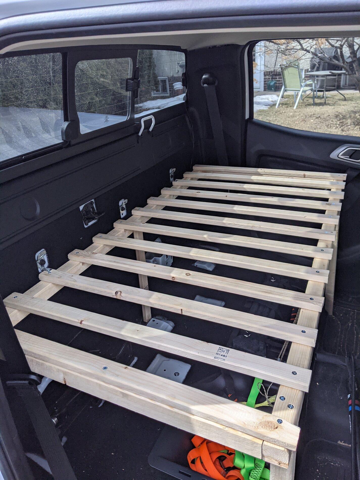

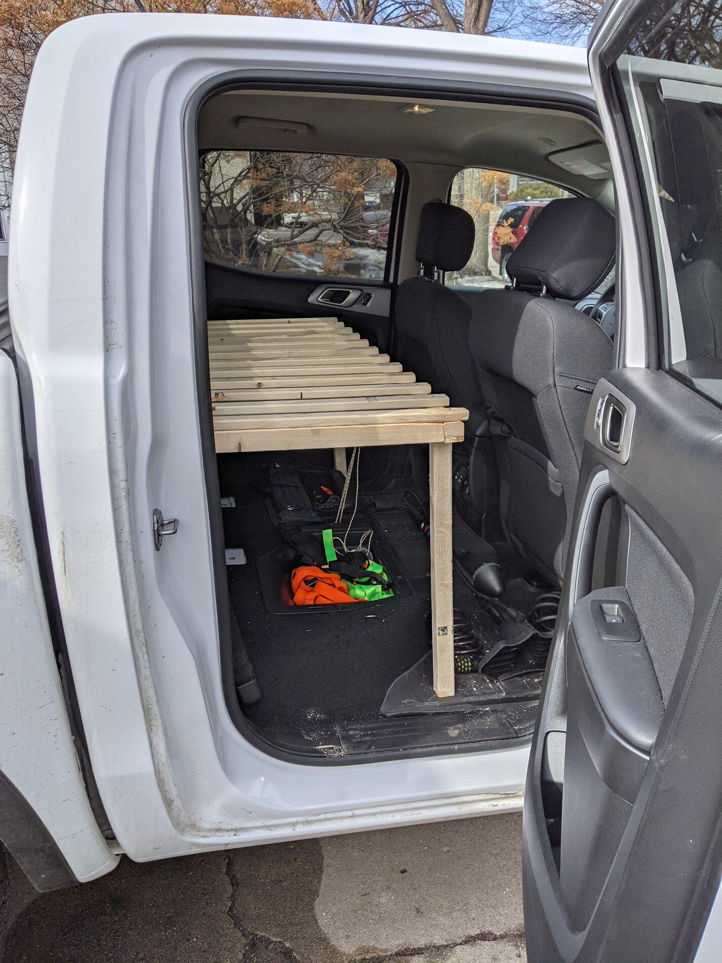

I whipped together a single level platform this weekend for an upcoming trip to Moab where the bed will be taken up by a moto and bicycle. Should have plenty of room for camp gear inside now! Pretty simple construction using 2x2 and 2x1's and wood screws. I used three support legs and two metal L brackets tied into the rear anchor points. I used some paracord to tie down the front when not in use so it's not flopping around. Overall pretty happy with how it turned out and how stout it feels back there.
