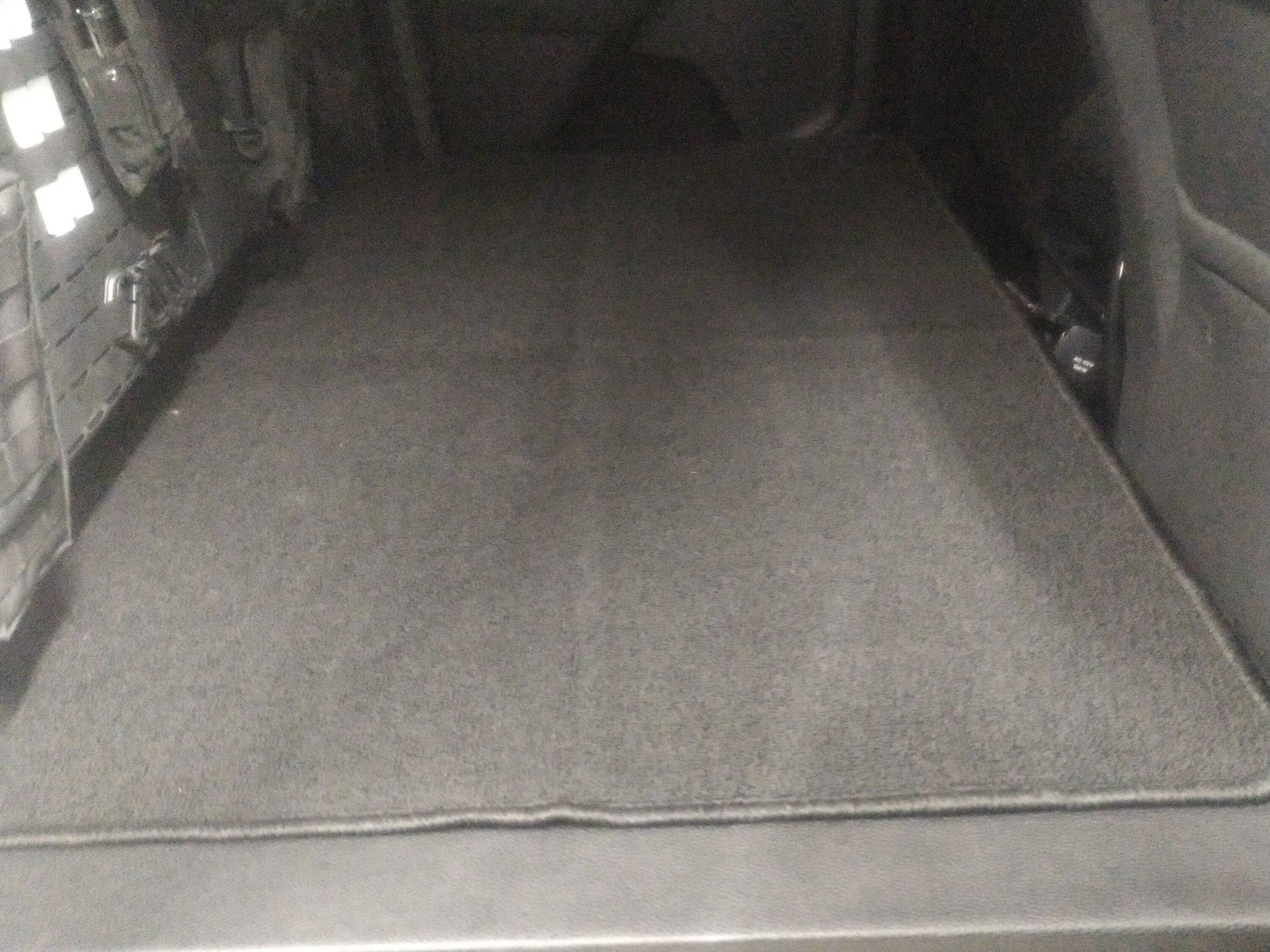

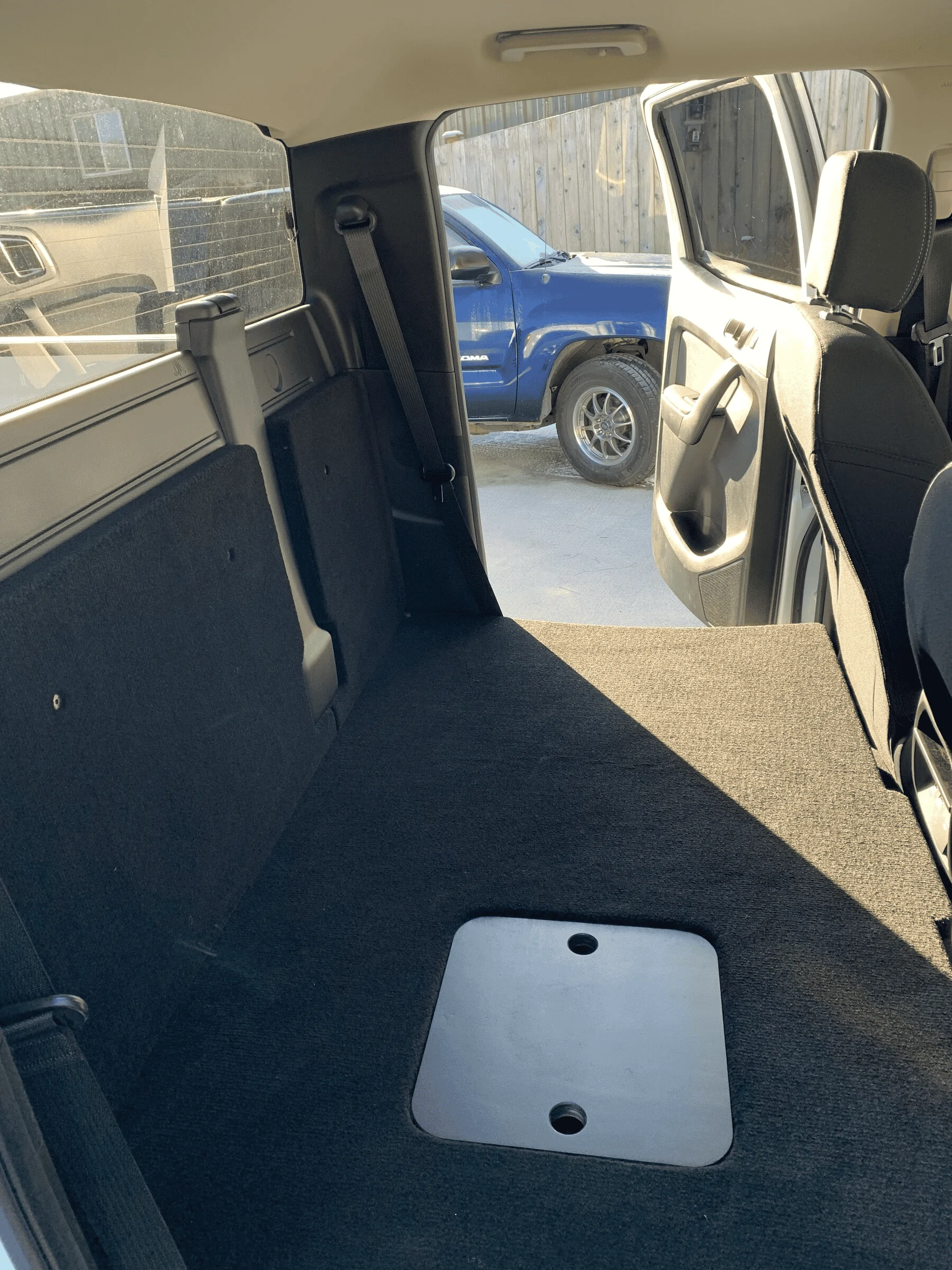

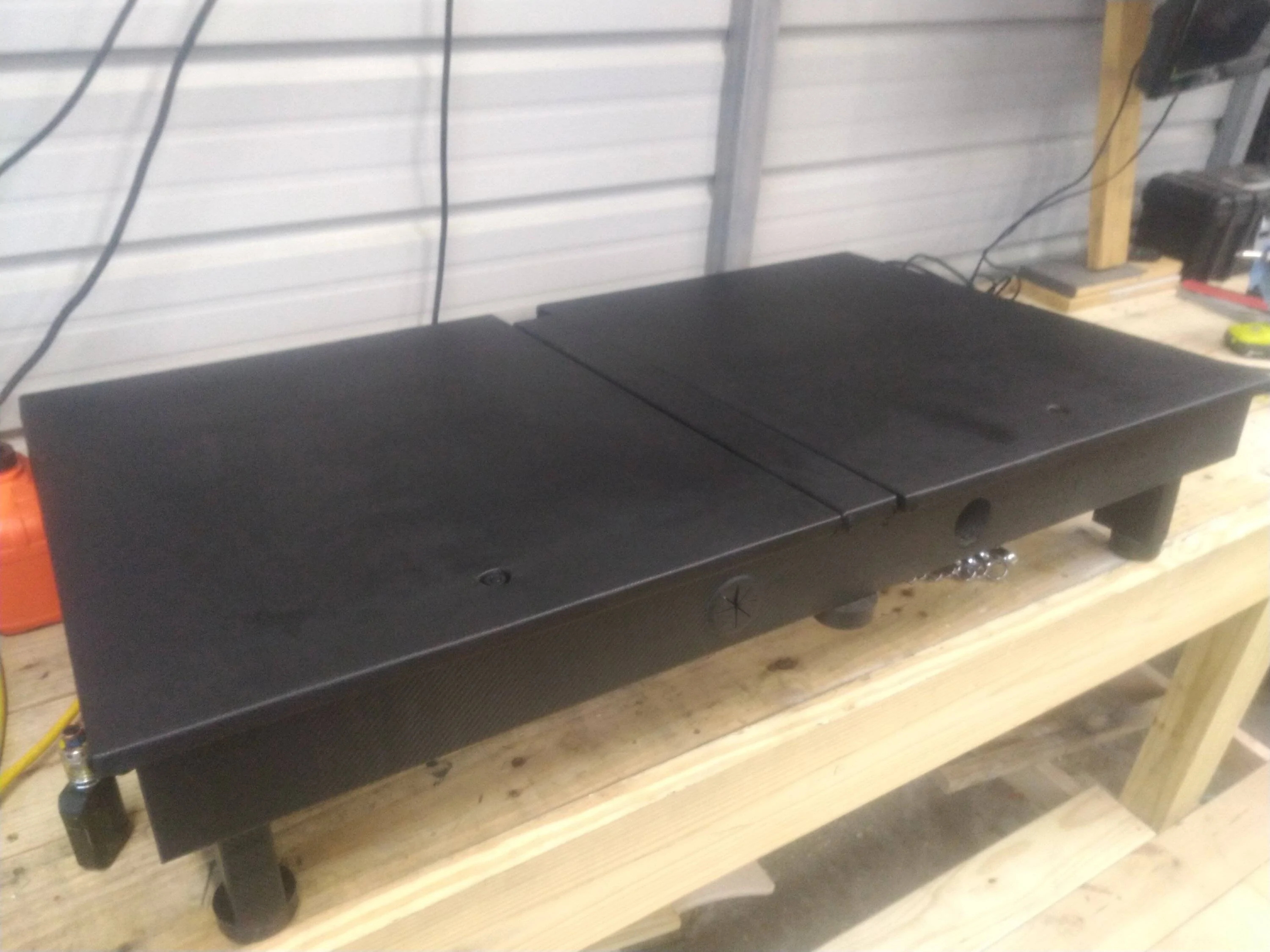

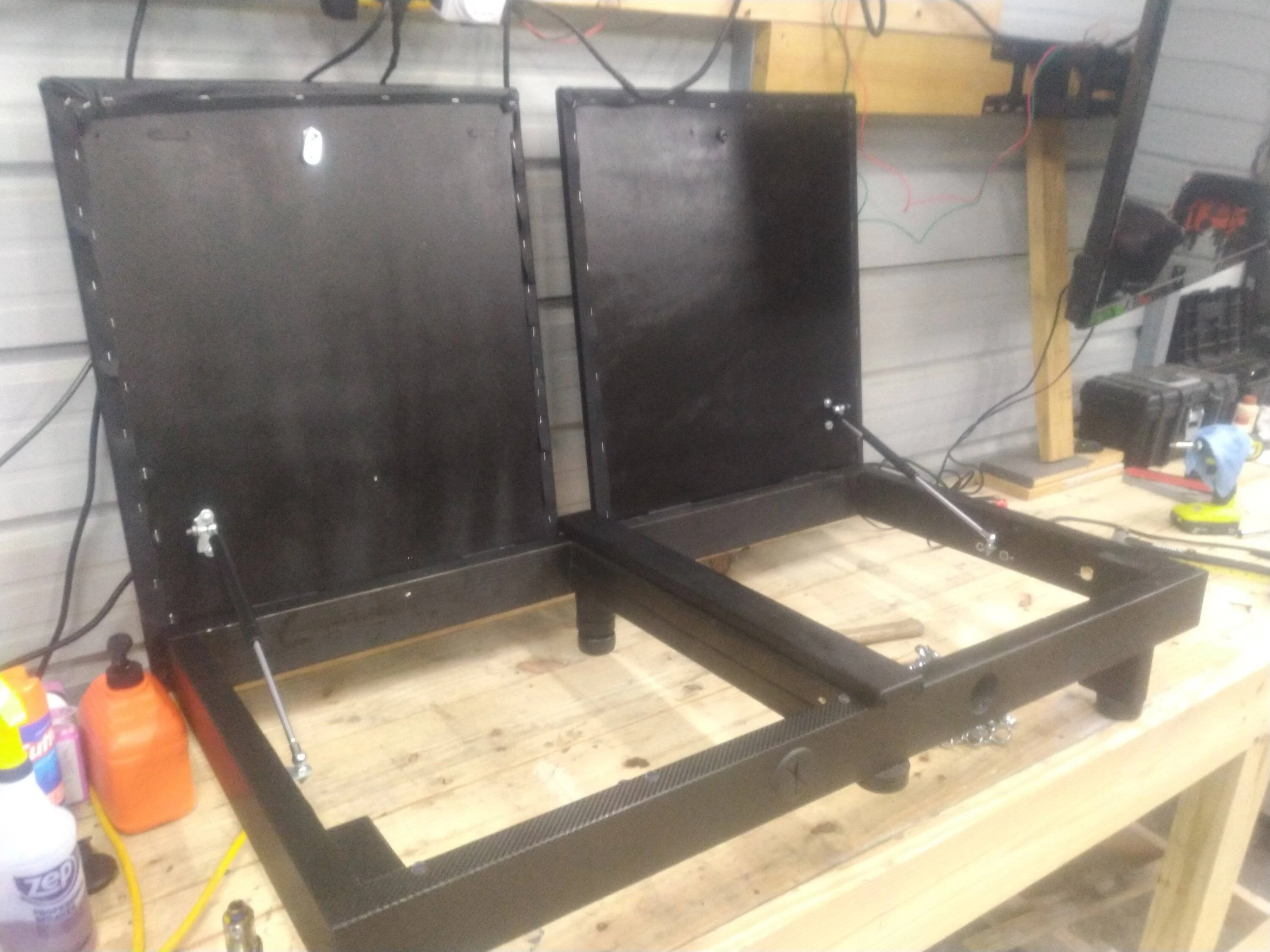

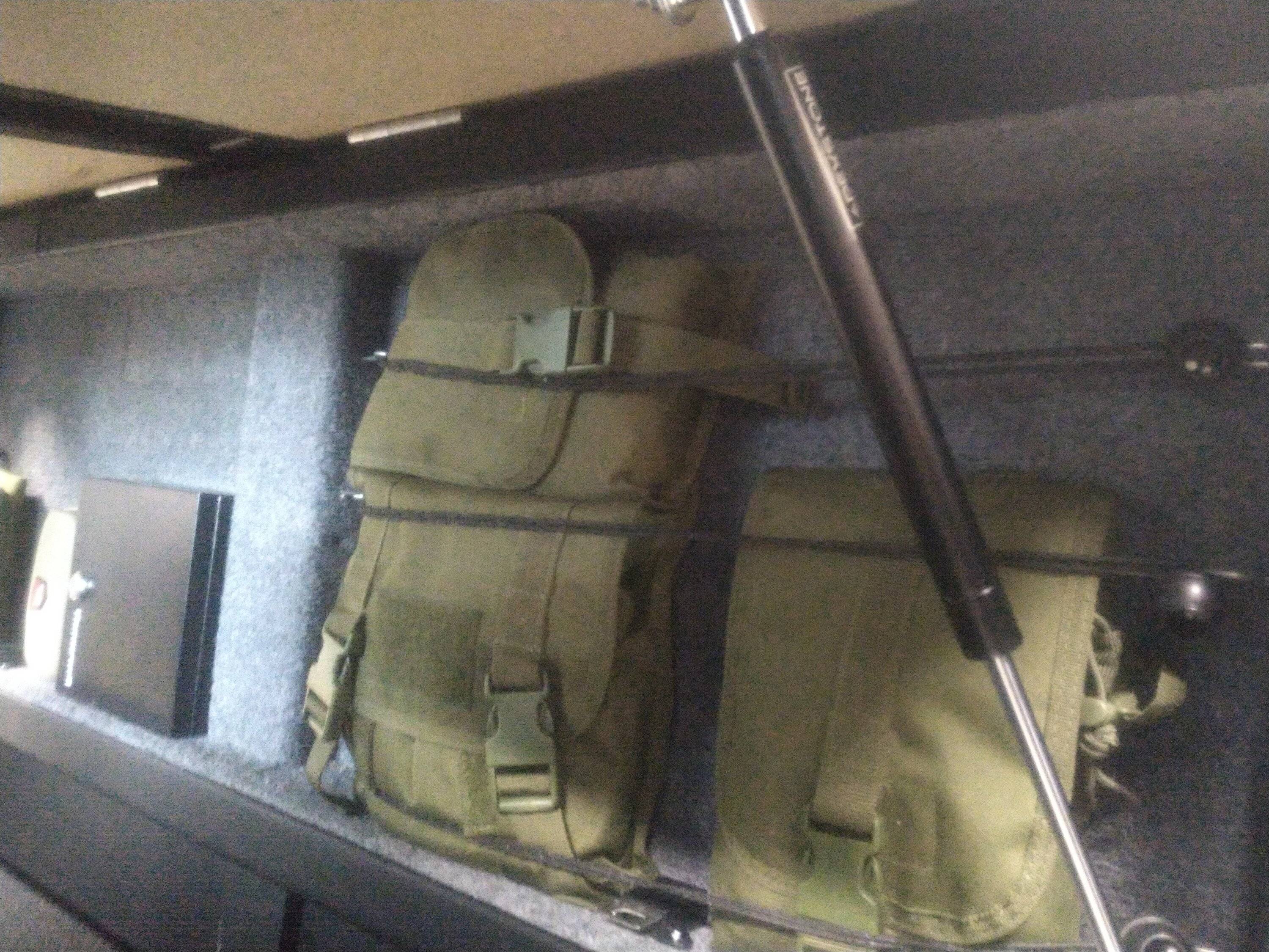

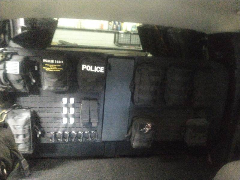

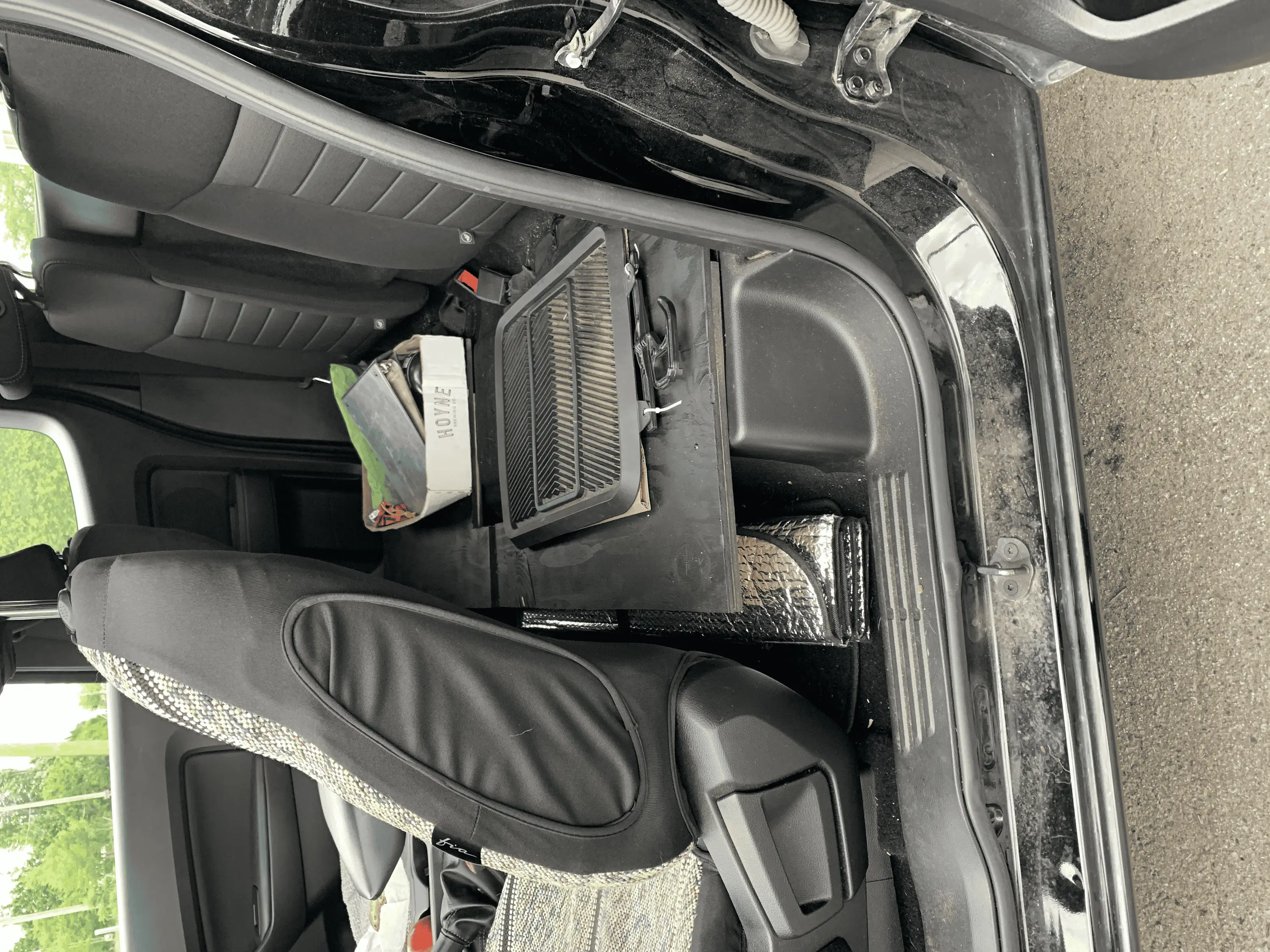

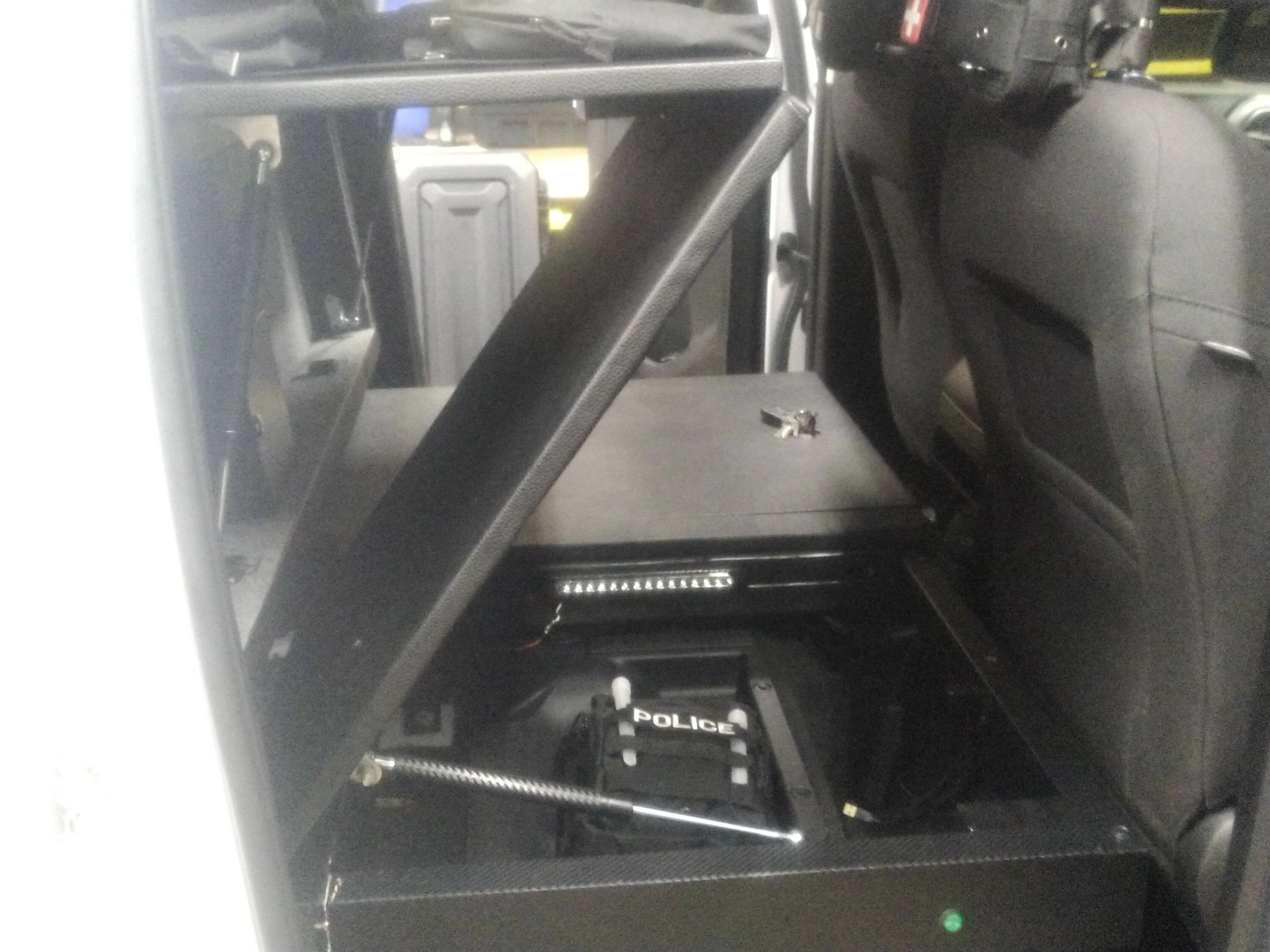

I think I have about $200 invested in my rear seat delete if you include all the accessories. That covers the wood, upholstery, struts, locks, molle panels, and molle pouches. I am actually re-doing a new bottom platform right now with 1x4's instead of 2x4's because I wanted to change p some things on it and add some extra 2" ventilation holes with 50mm 12v PC fans due to all my aux electrical being contained within.
To answer your question: Removing the back seat takes nothing more than removing some bolts and fishing the seat belts through the bench.

That is a sweet setup! I'm an EMT, so having a place to stow an IFAK, my trauma bag, and some turnout gear would be awesome. Right now, it just sits on the back seat. I also carry, but I'm looking at the console vault for a lockable solution for when I can't take it in with me or need to lock up my mags and gun separately when traveling through Communist territories ;). Any links to where you got supplies? I'm not much of a woodworker. I wonder if there's anyone building units?

I plan on putting up a DIY guide in the next couple of weeks. My design is nothing more than a few pieces of straight wood to make some squares nothing I built conforms to any shape regarding the floor. What I built can be done by anyone with just a miter saw or a skill saw to cut the wood.
The rest of the components are going to vary depending on what somebody wants to install. For example the floor panels use standard cam locks for a bit of security while the rear wall uses hidden RFID access locks with a key card.
The finish can be any number of things from vinyl wrapped to stained to painted to upholstered.

I’m thinking black carpet on the base with hatches for the compartments underneath and molle strips all along the back wall.
