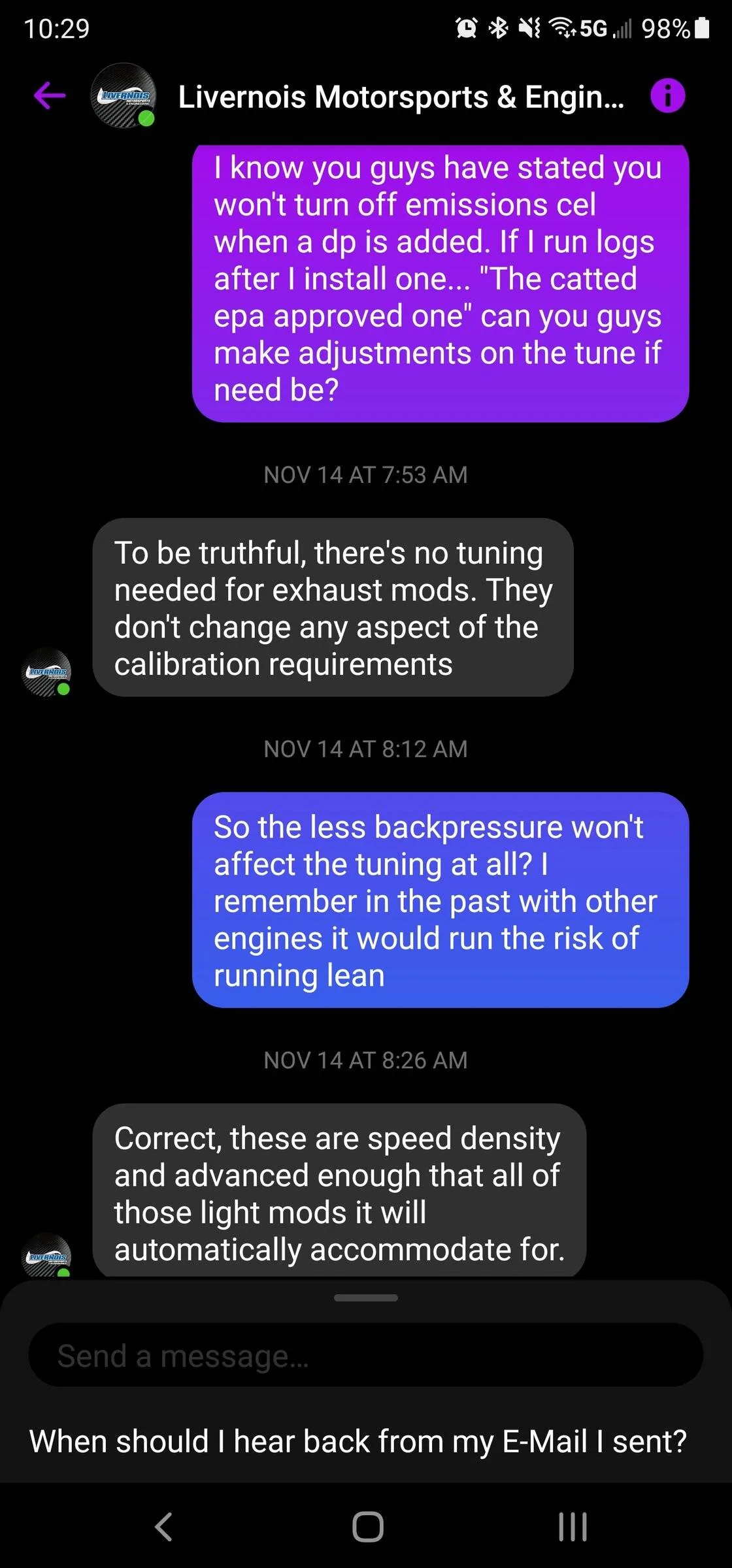

Turns out you do not need to be tuned for exhaust mods. Via Livernois. They said it's a Speed density motor.. No need

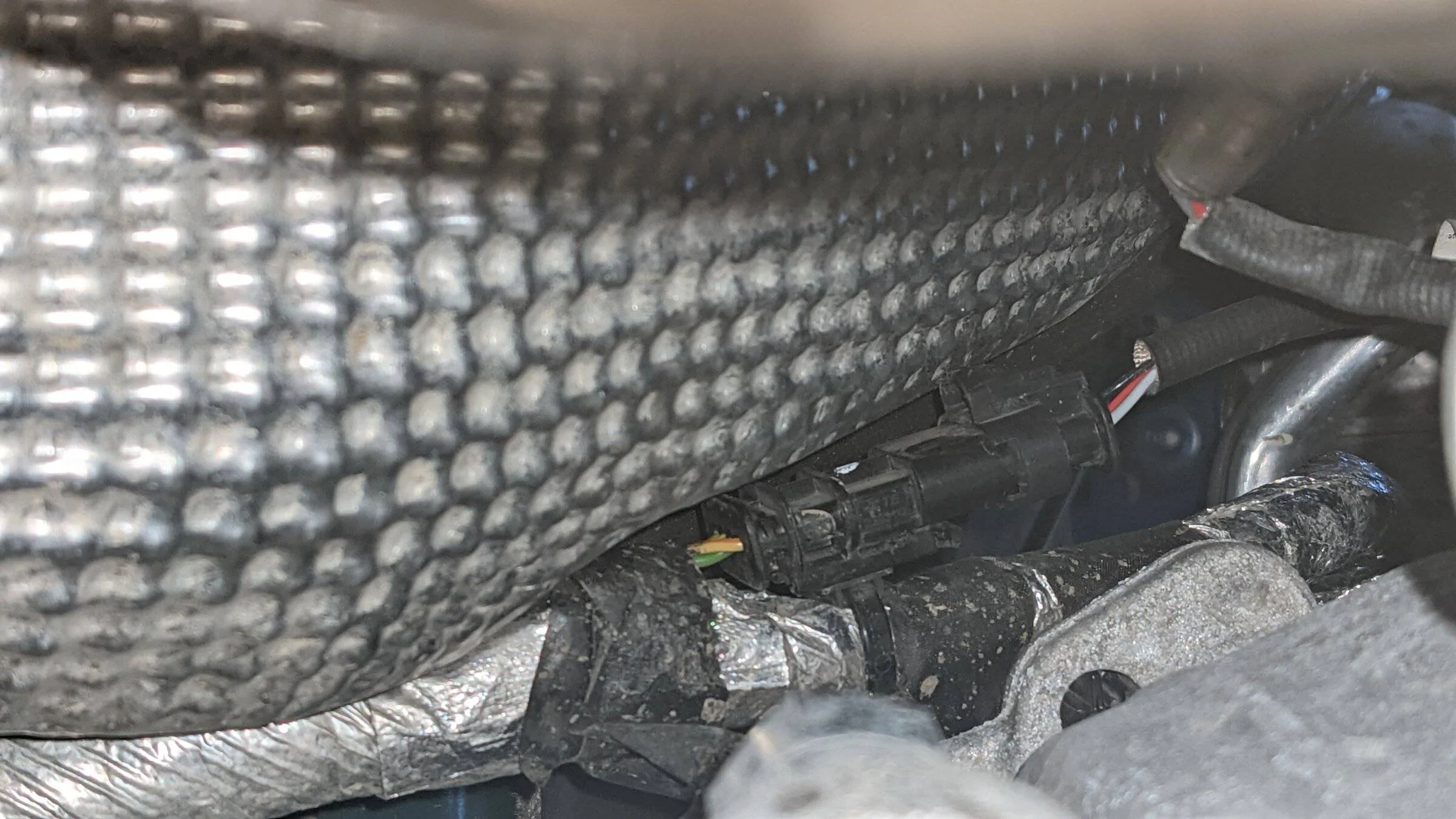

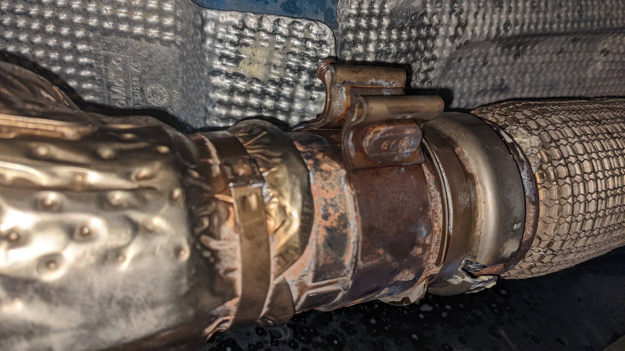

There are 2 things that are driving me crazy.
1) I can't seem to disconnect the factory downpipe from the flex pipe
2) I can't disconnect the lower O2 sensor plastic connection
1. the clamp or pulling them apart?
2. Not sure how to help you there. Mine came apart, it’s just a matter of finding that release button and leverage to pull apart
Pulling the pipes apart lol.
I took the nut off the clamp it's loose, but boy oh boy the pipes are hard to pull apart.
I can disconnect the electric connection once I pull the pipes apart.
