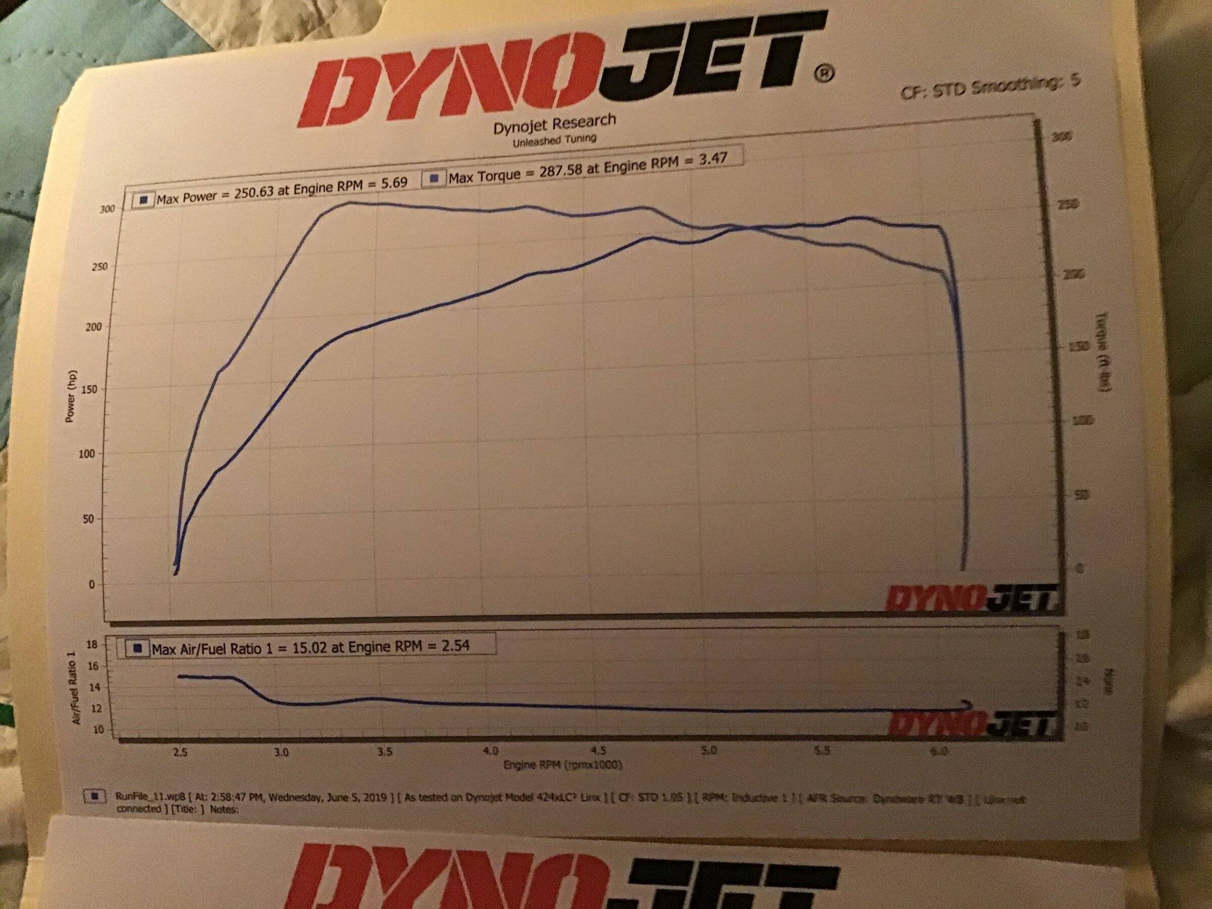

93 octane Unleashed Tune stock with muffler delete.
before tune and after……

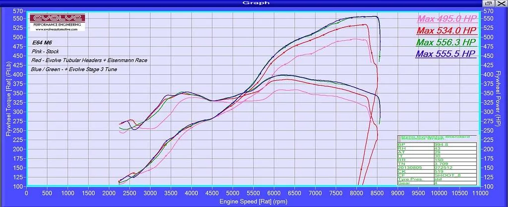

Yeah, but I'm kinda hoping my FRP tune graph looks more like this: :)

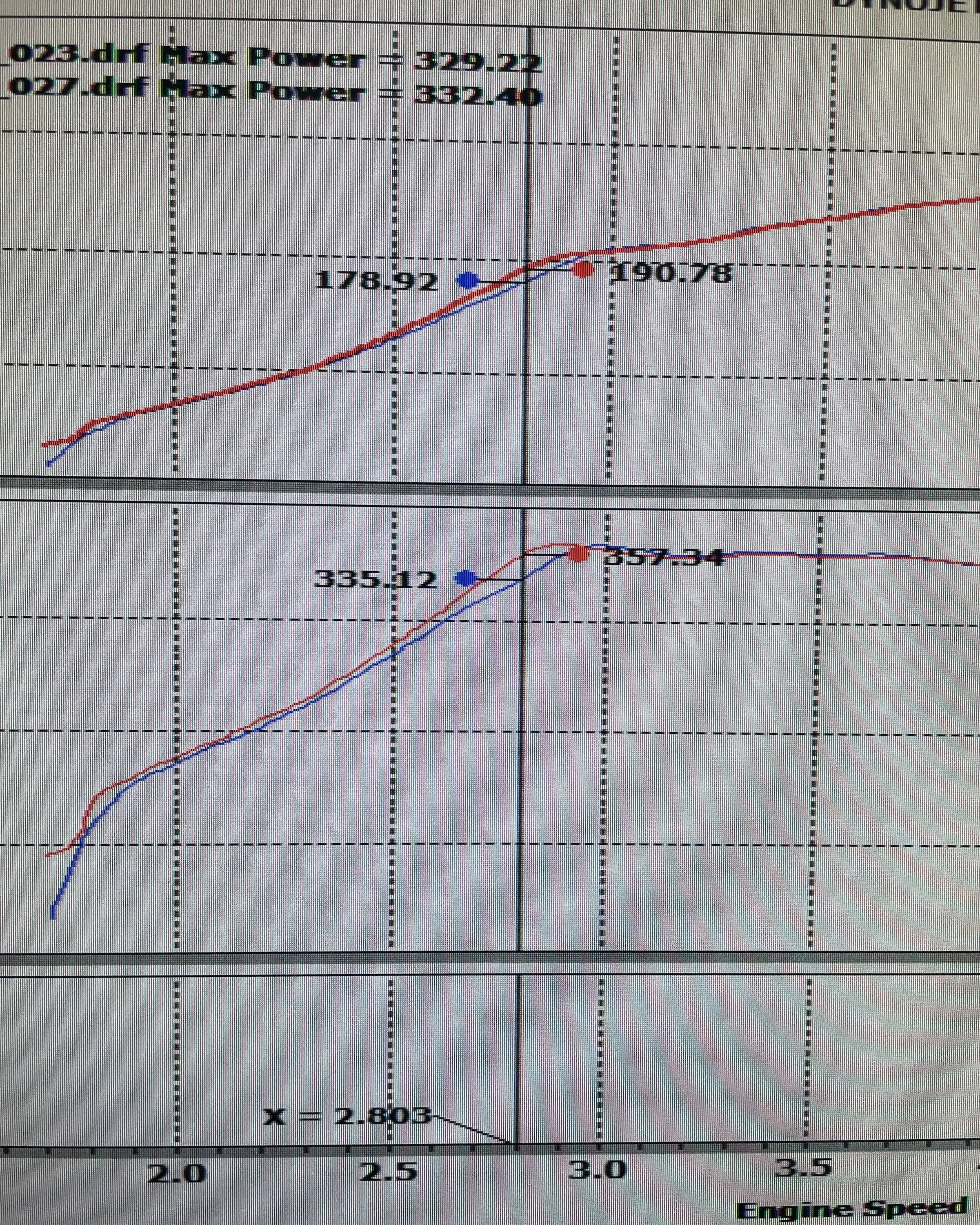

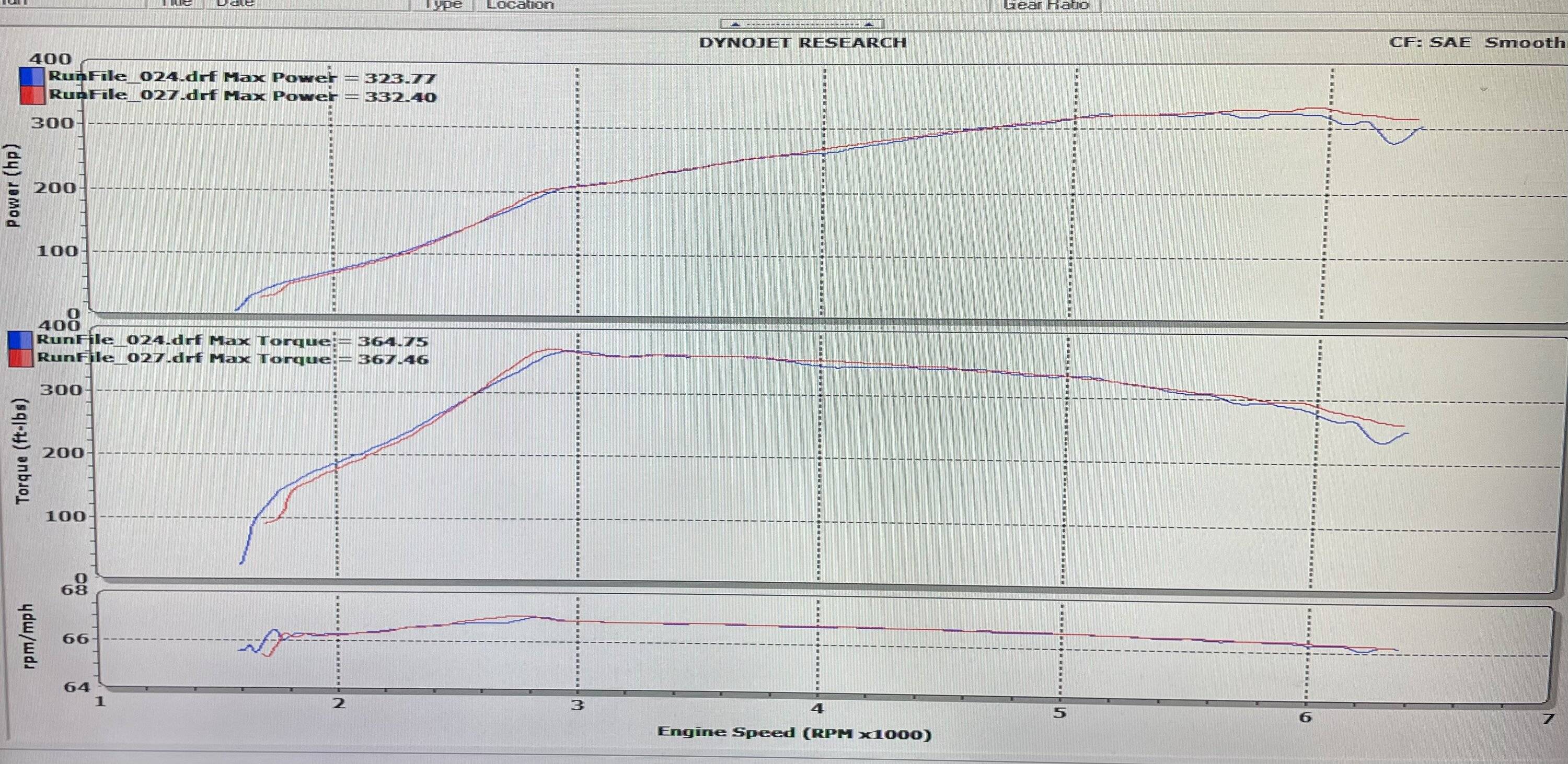

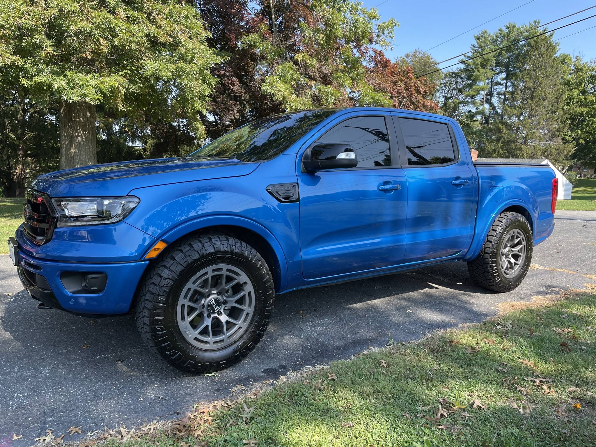

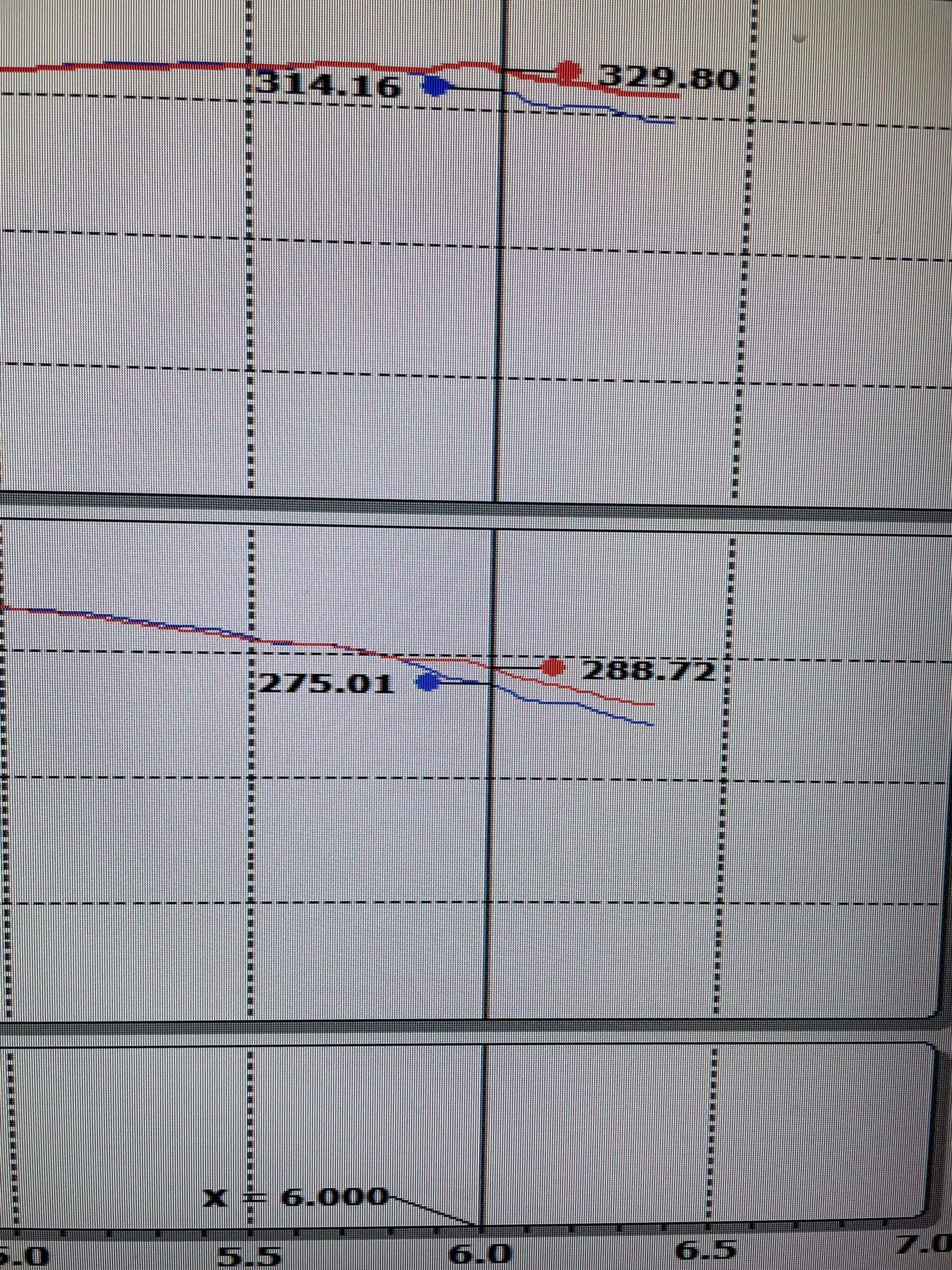

My FBO stock turbo truck on 93.
21 Lariat Fx4. At time of dyno, custom downpipe, Mishimoto intake, intercooler and pipes, UPR dual valve can, Turbosmart closed BPVand custom dyno tune by Revolution Automotive in Baltimore.
We were testing our new turbo inlet pipe on this pull. Red pull is with the new pipe and blue is without, no other changes. If I recall correctly these are 5th gear to keep the wheel and driveshaft speeds down.

Granted those aren't dramatic improvements but the shape of those graphs tells me there is an opportunity to refine the curves via moar tuning. For us 'regular' folk I bet the overall driving experience would be enhanced - how that translates ? ? dollar wise is going to be subjective.

There’s considerable work in making that graph look like that, most Ranger tunes come on stronger than mine but they fall off super fast. We prefer a smooth, broad powerband in our tunes. Customer reports show a pretty good improvement on a variety of trucks ranging from stock, tuned, lightly modified and all out bolted on.

Agreed. Look for a totally stock graph and overlay it with yours and I think it should be apparent.
