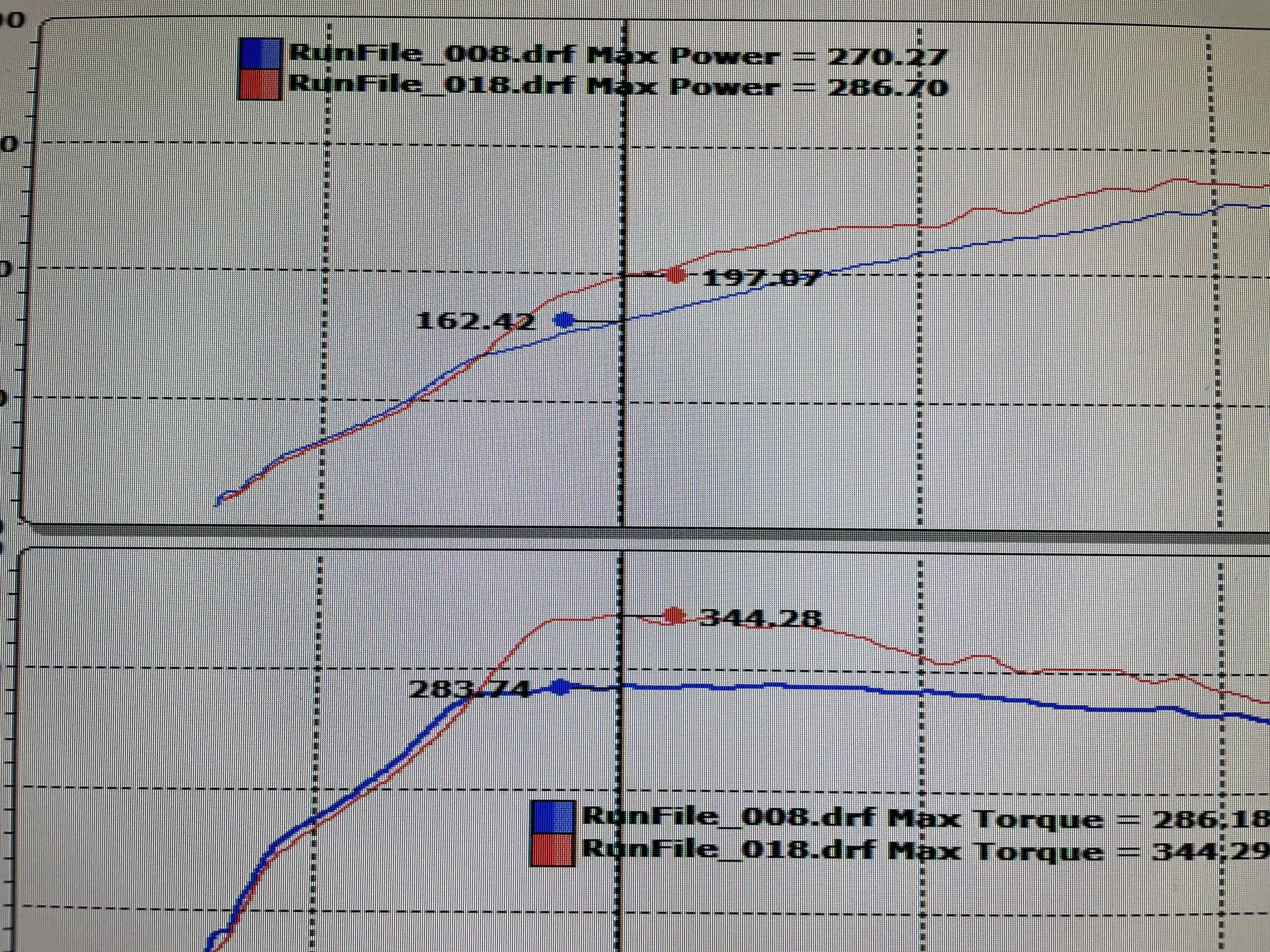

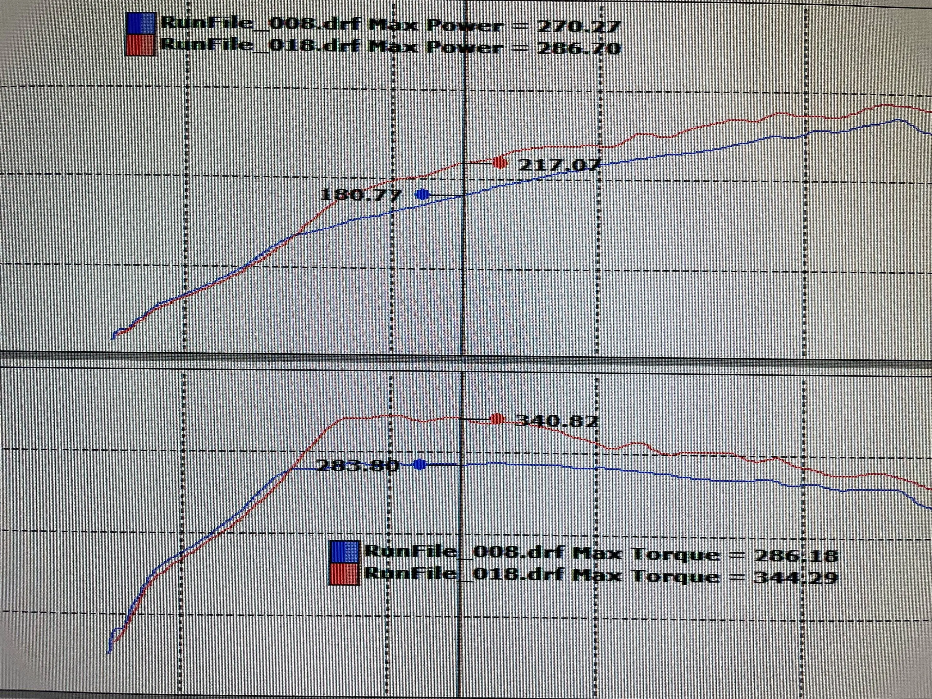

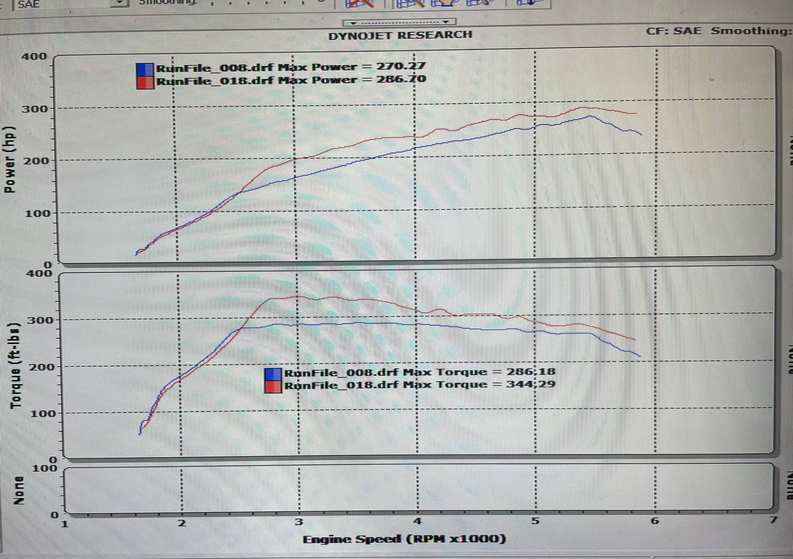

I was digging through some dyno pictures yesterday and had decent comparison of my truck while we were developing the tune. This is my personal truck that we use for product R&D. In this particular case it is equipped as follows; 2021 FX4 Lariat Black pack on 285/65/18 Ridge Grapplers, 93 octane fuel, Mishimoto intake, intercooler and pipes and custom downpipe with MBRP catback. The tires are important to note because their weight will affect overall power transferred to the ground making the numbers lower than expected when compared to stock tires (roughly 40 pounds per tire weight difference)
In this graph we pulled an already street tuned truck in, made pulls, returned the ecu to stock and made more pulls. This is strictly a comparison of a few boltons and how they work with and without tuning. Unfortunately I don’t have an actual stock baseline for this truck because I’m impatient and already installed stuff before getting it on the dyno first.
No, that is not the final power from the tuning session. The truck later made 298hp after being dyno tuned but that is another graph for another time.
This is not the current configuration of the truck nor is it on anything more than a quick base file for some street driving data.
I plotted a couple under curve points to show how much more important it is to look at the gaps between lines rather than the peak numbers written on the sheet.
God I hope everything was explained transparently enough to not create what happened yesterday but we’ll see😬

Dang you gain a lot of torque from the tuned truck vs no tune. I wonder how many people by parts, through them on and don’t do a tune (that was me when I was younger, haha) They are surely missing out on hp and tq.
I was impressed with the gains from just the parts and no tuning! The torque is where it picks up big with tuning. The truck ended up at 298hp with torque around 365 after dyno tuning.

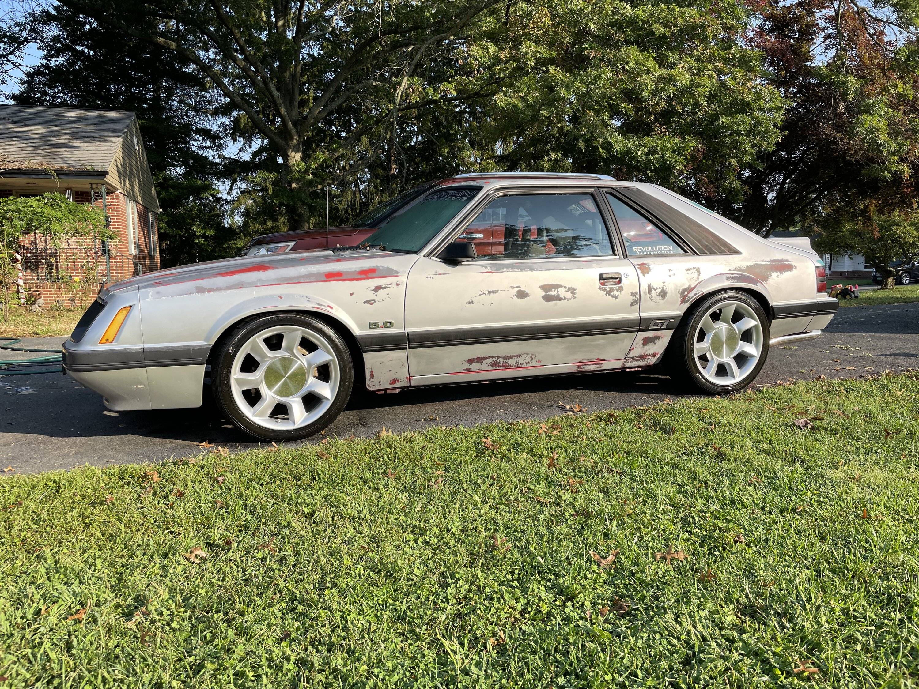

I understand that! I have an 86 Mustang
