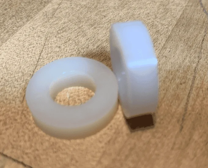

That said, the fix is simple and takes less than 5 minutes. Some have used washers, others just cut down the bumpers. The gap is about 1/8", and that is why it requires a lot of force to latch it. I used two plastic 1/8" washers from ACE hardware, works perfect now.

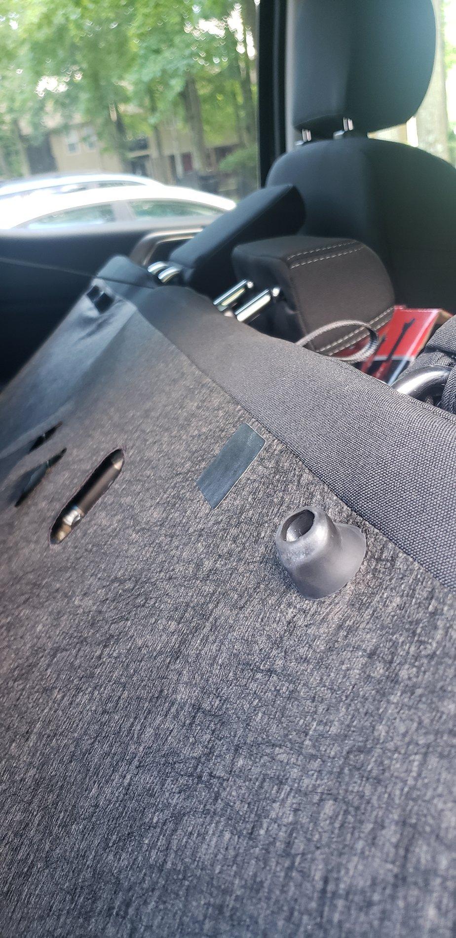

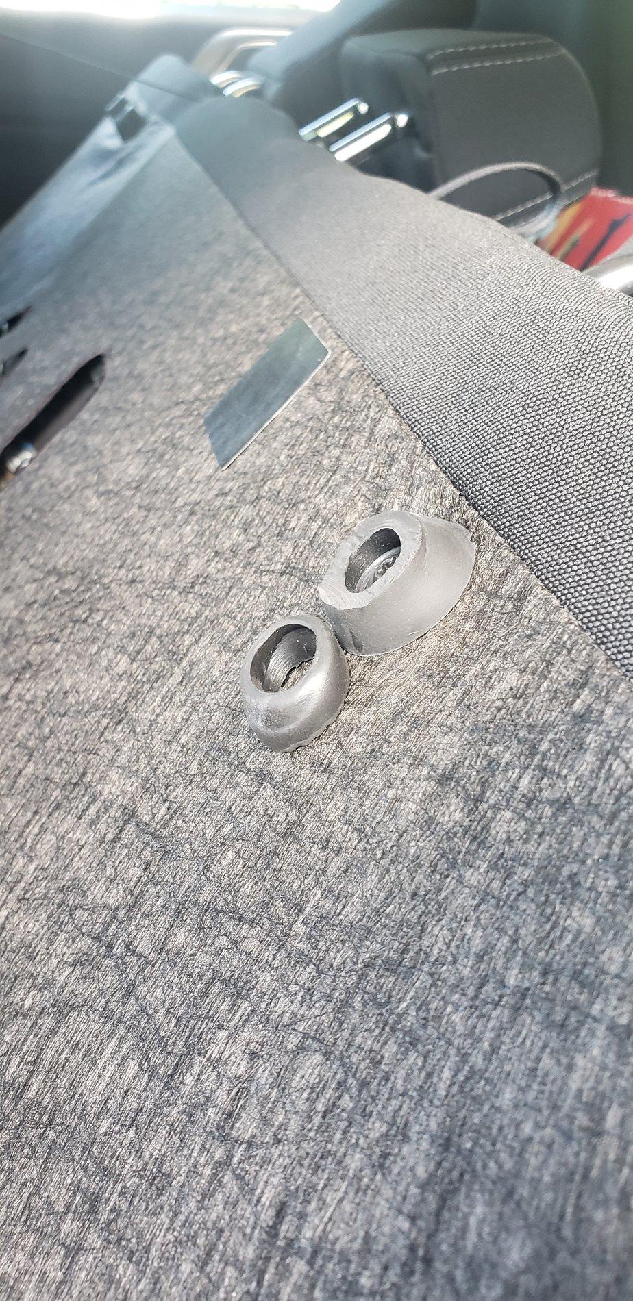

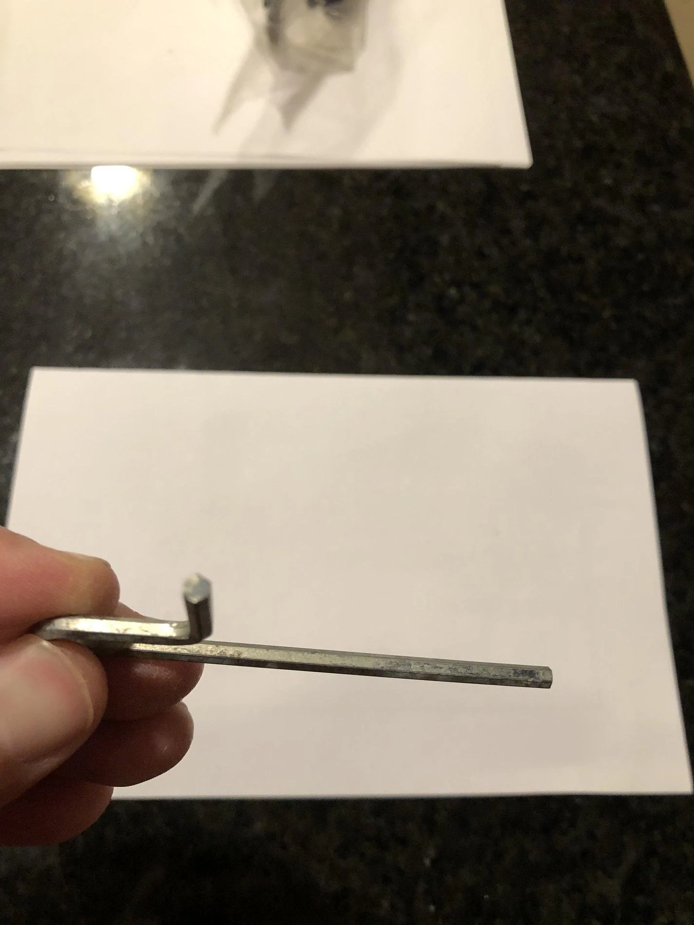

I had this problem and after reading the posts in this forum, I went to my Ranger and did notice 3 rubber stoppers. I was at work so I had to wait until I got home to fix it. Once I was home, I got my allen wrenches and then just unscrewed the rubber stoppers. It took about one minute and as soon as I removed them, the back seat easily folded back up and clicked (locked).

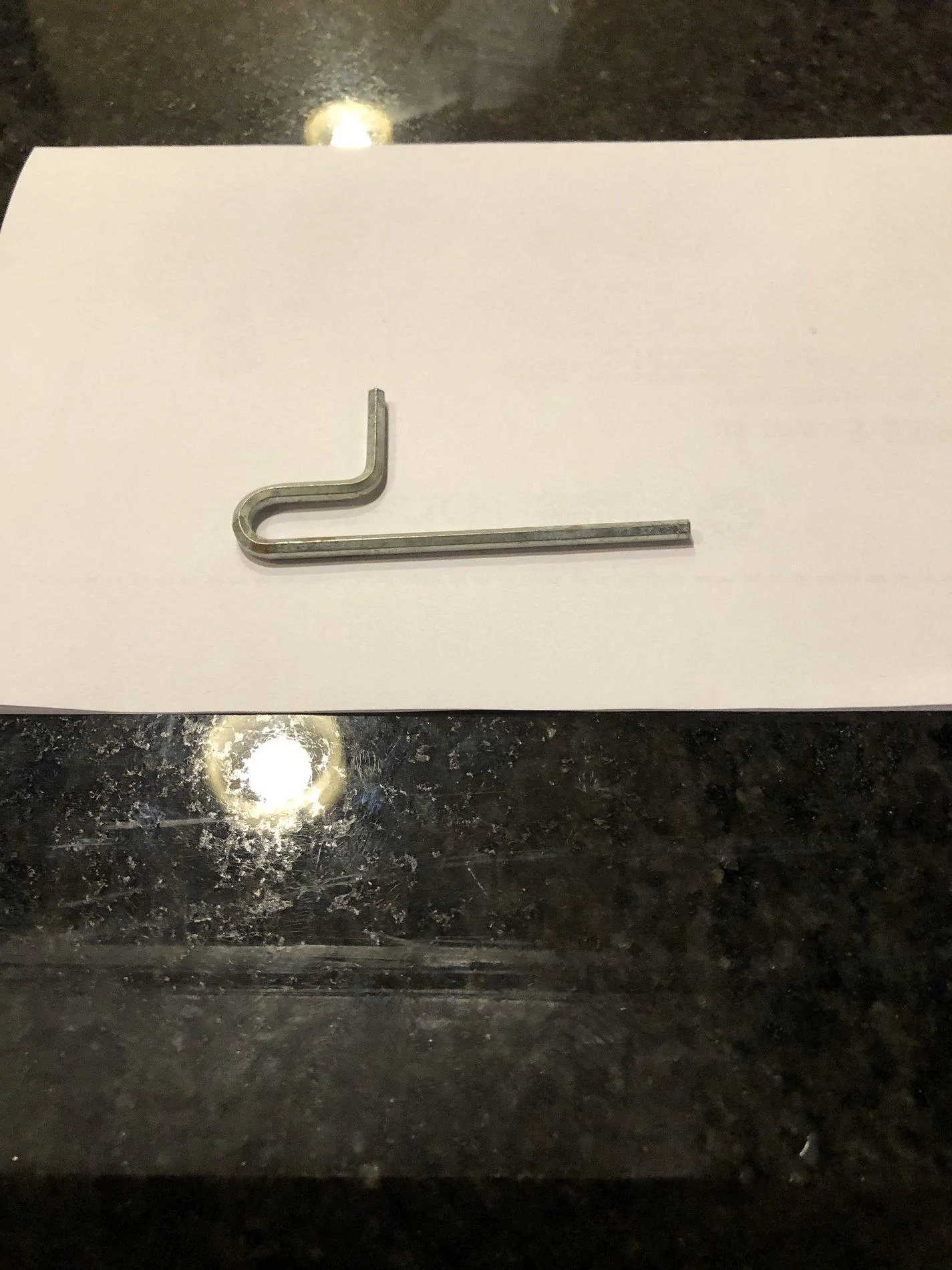

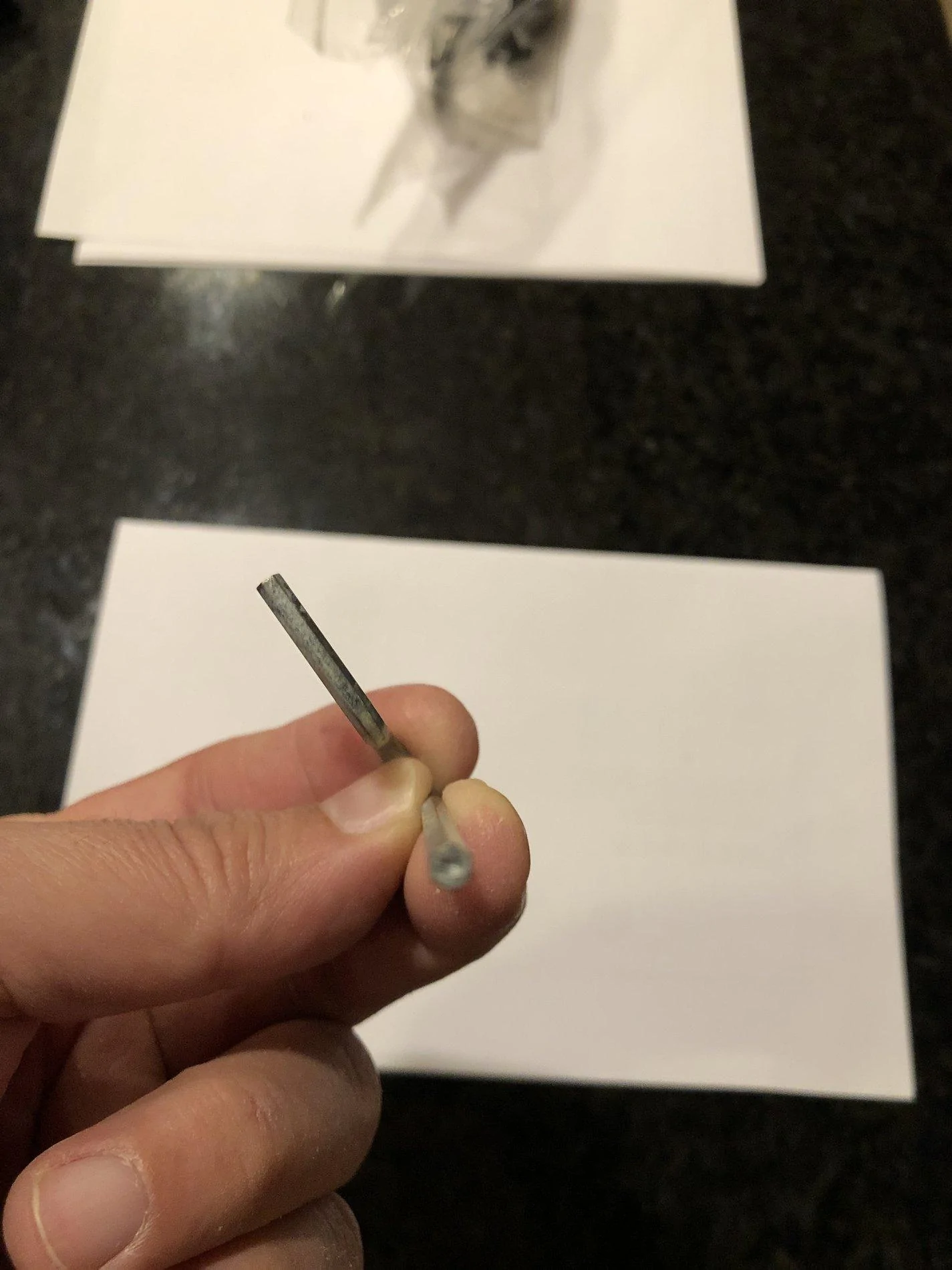

I'm not sure why those three rubber stoppers were there to begin with, but at least my back seat folds down and locks back up like it should and there is no rattling of the back seat when I drive. Here are some pics of the allen wrench that I used to unscrew the rubber stoppers.

The bumpers are supposed to eliminate rear seat back chucking. I retained the bumpers, but I turned them down on my lathe to about half thickness....Latches solidly and no seat back chucking.

Dude...i think i may have some left over plastic washers from the Weathertech mudflaps i can use :)

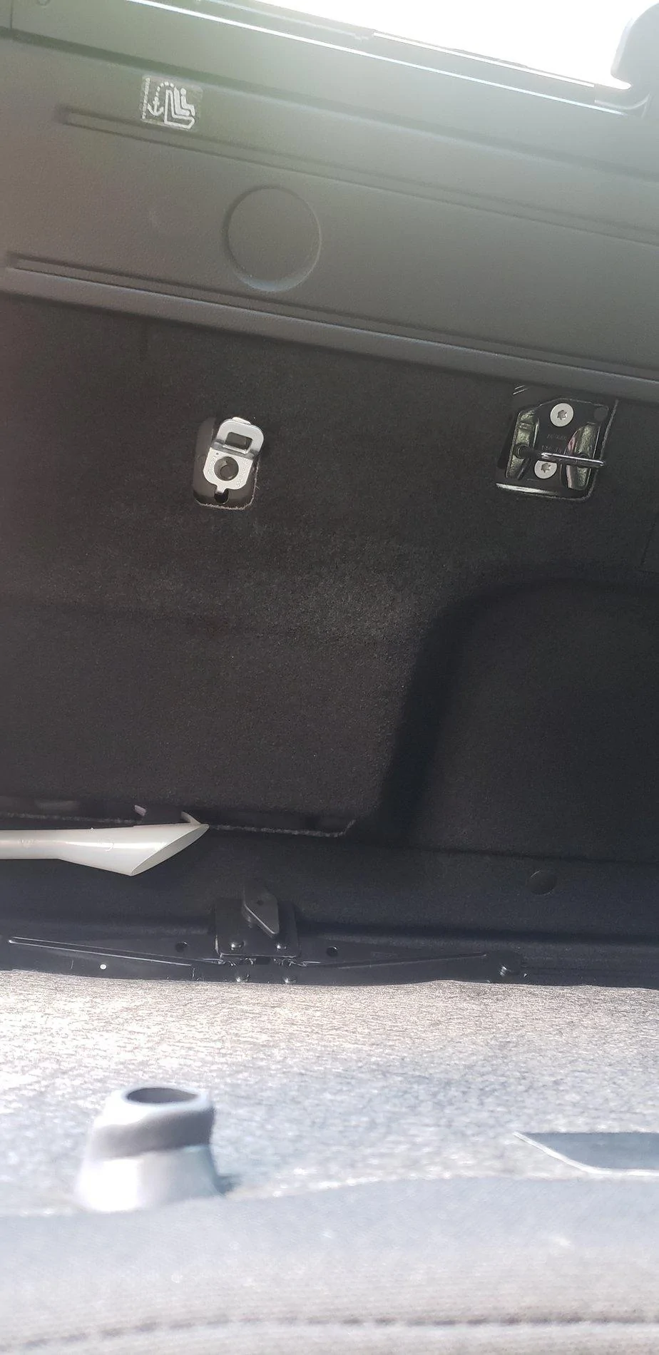

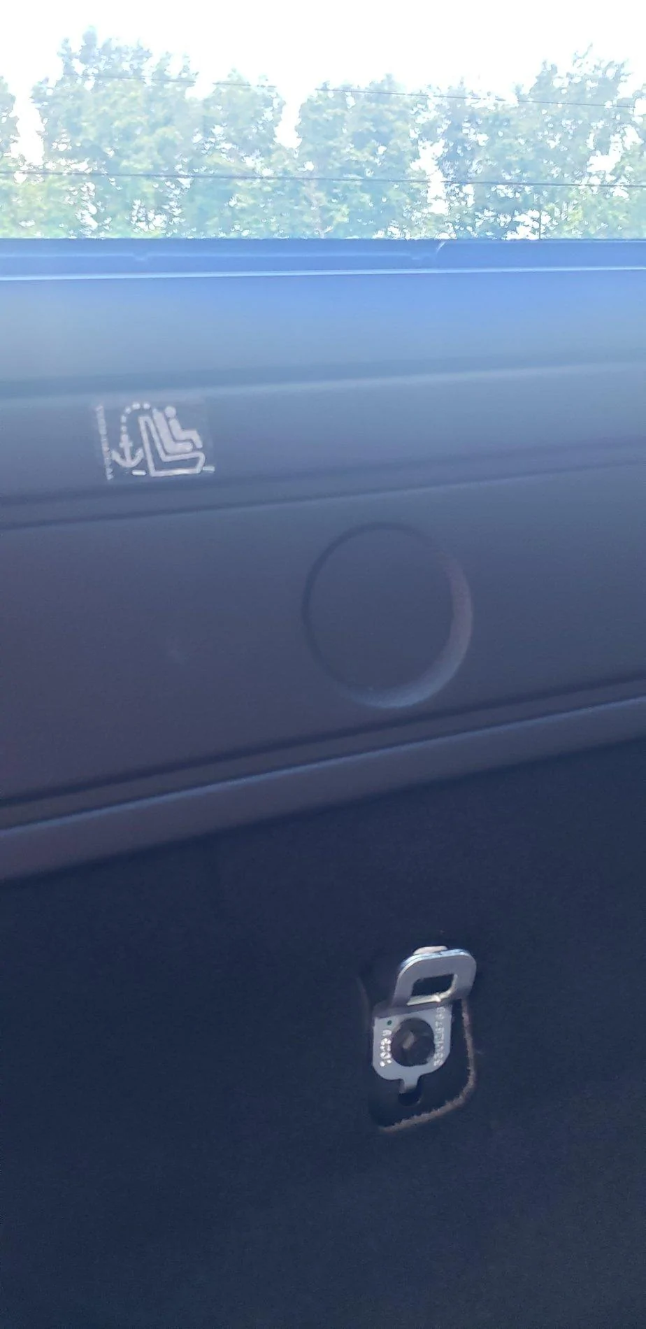

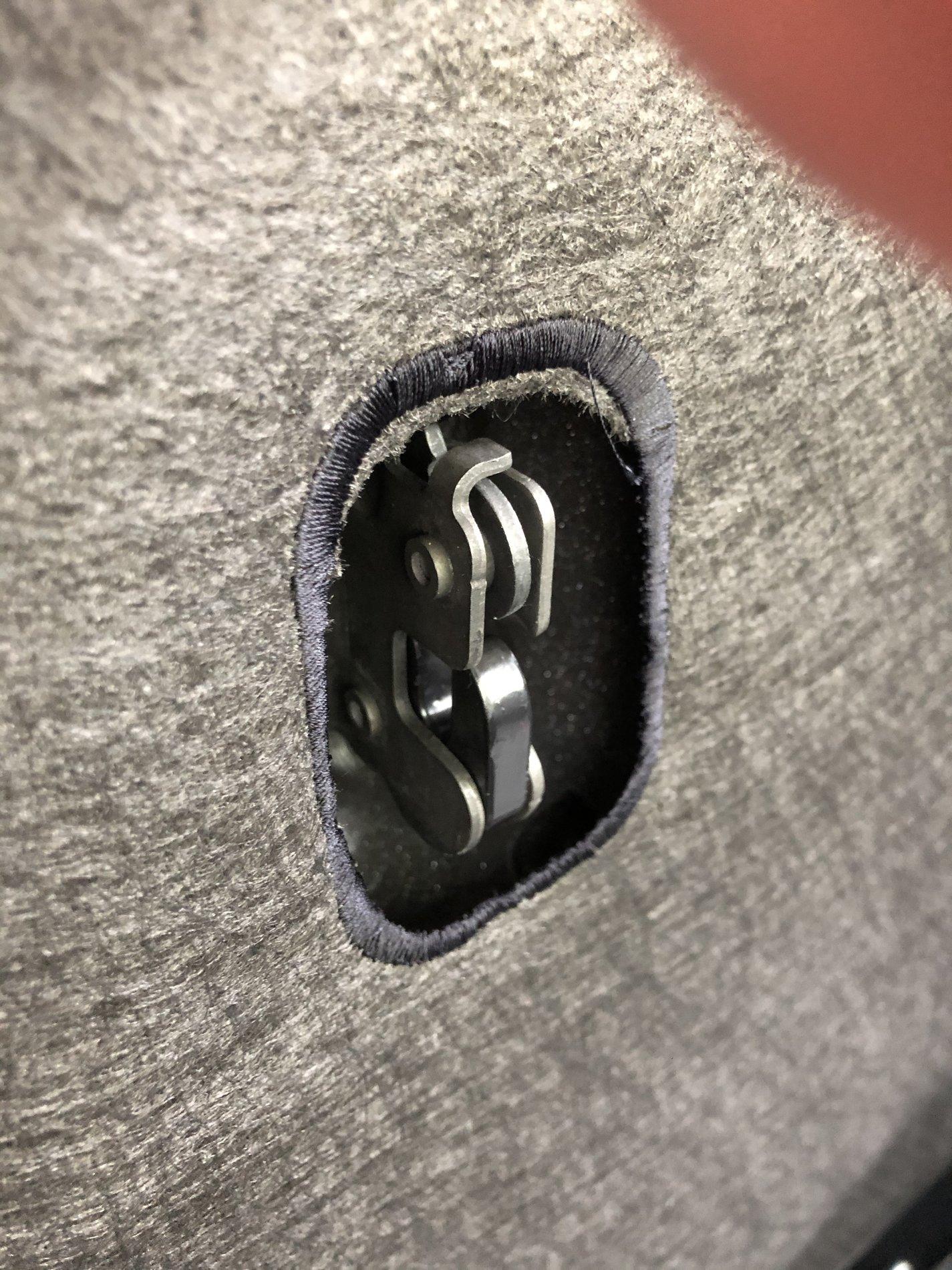

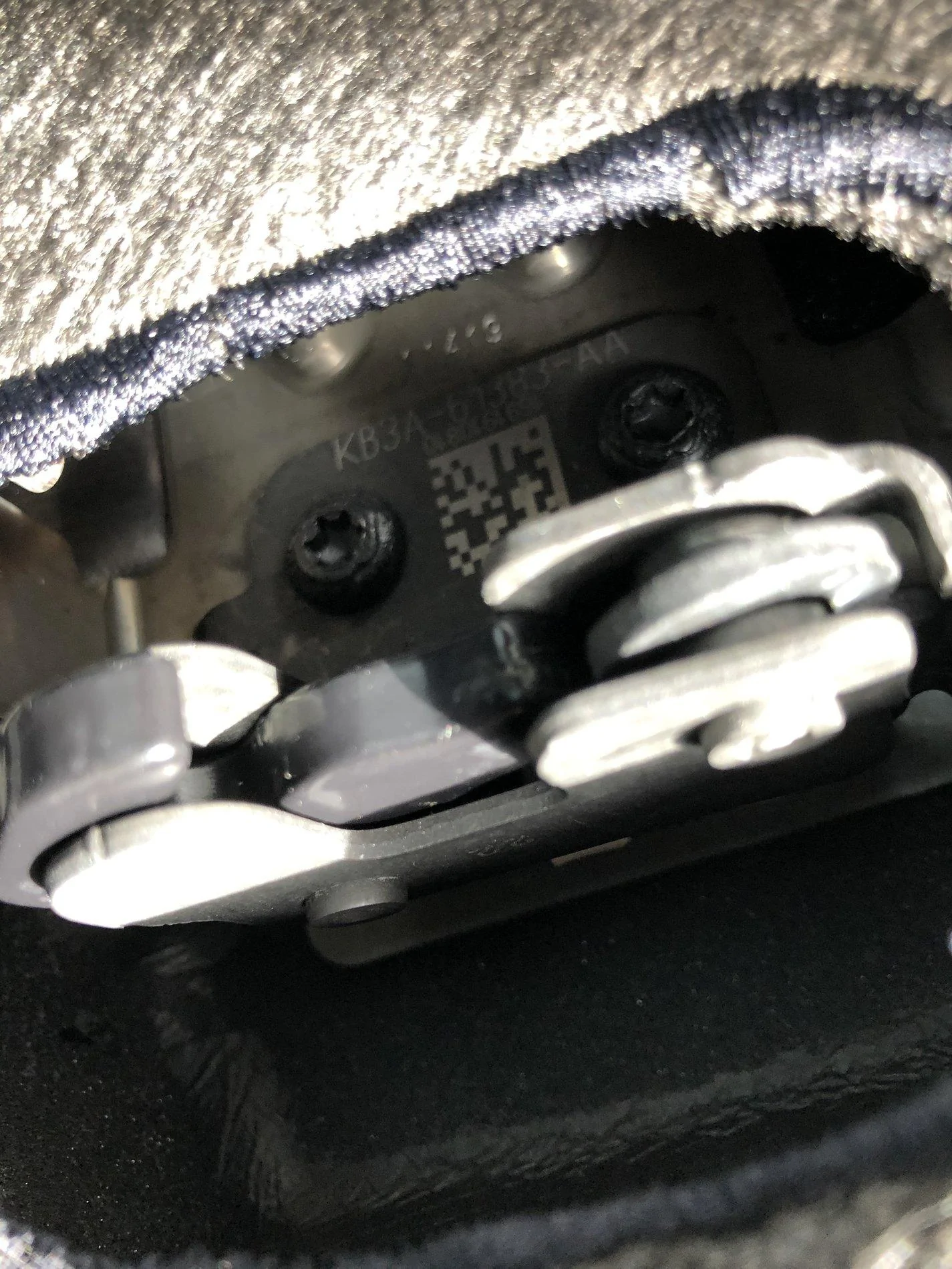

Does everyone’s latch look like this? I’m concerned it is hitting the right spot on the latch, but the latch mechanism doesn’t seem to want to move to allow it to connect.
