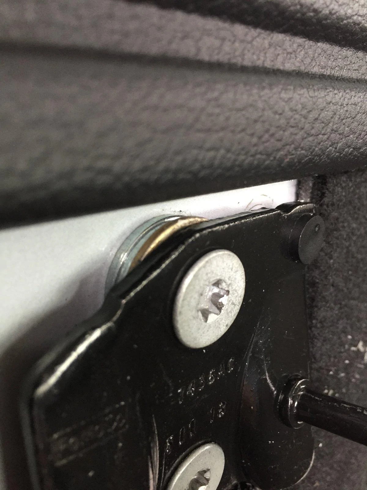

What's the issue with this? More detail.
Look at my post on the first page, #11. No real issue, it just seems this hook and catch are there for no reason, because they don't engage or appear to do anything!

Did you notice if the rubber stops were still in place? I'm wondering if dealers are starting to remove them proactively to address this issue.
Yes, the little rubber stops were in place, but I didn't count them, so it's possible one had been removed already (but not by the dealer - he wasn't aware of the problem till I mentioned it).

@JDCinVA did re-installed all but 1 rubber stop fix it? What does passenger inboard even mean?
If there were originally 4, then the term would refer to the 2 inside ones. One on each the drivers side and the passenger side
That was my assumption as well. The passenger inboard rubber stop is the one closest to the latch. I re-installed three of the rubber stops (two on drivers side, and outer stop on passenger side), and the latch properly catches. You still have to close it pretty hard, pressing it right where the latch is, but it closes. Of course, it's been warmer out too, and warmer ambient temp seemed to help it close even with all four stops in.

SSM 47794 - 2019 Ranger Super Crew - Folding Rear Seat Back Hard To Latch – Built On Or Before 30-Jan-2019
Some 2019 Ranger Super Crew vehicles built on or before 30-Jan-2019, may exhibit a hard to latch rear seatback to the upright (Normal) position. This may be due to 4 installed rubber bumpers in the seatback frame. To resolve the concern, remove the passenger inboard rubber bumper by the seatback latch. Verify proper operation, may need to adjust the latch after the removal of the 4th bumper. Vehicles built after 30-Jan-2019 will only have 3 bumpers installed, and small patch to cover the exposed hole in seatback cover material Use Flocked Tape (Fuzzy) 164-R4903. Refer to Workshop Manual (WSM), Section 501-10B. The 4th Rubber bumper is no longer equipped due to a running change. The vehicle is not misbuilt. The addition of any parts would not be considered a warrantable repair. Do not submit a claim for this condition.
