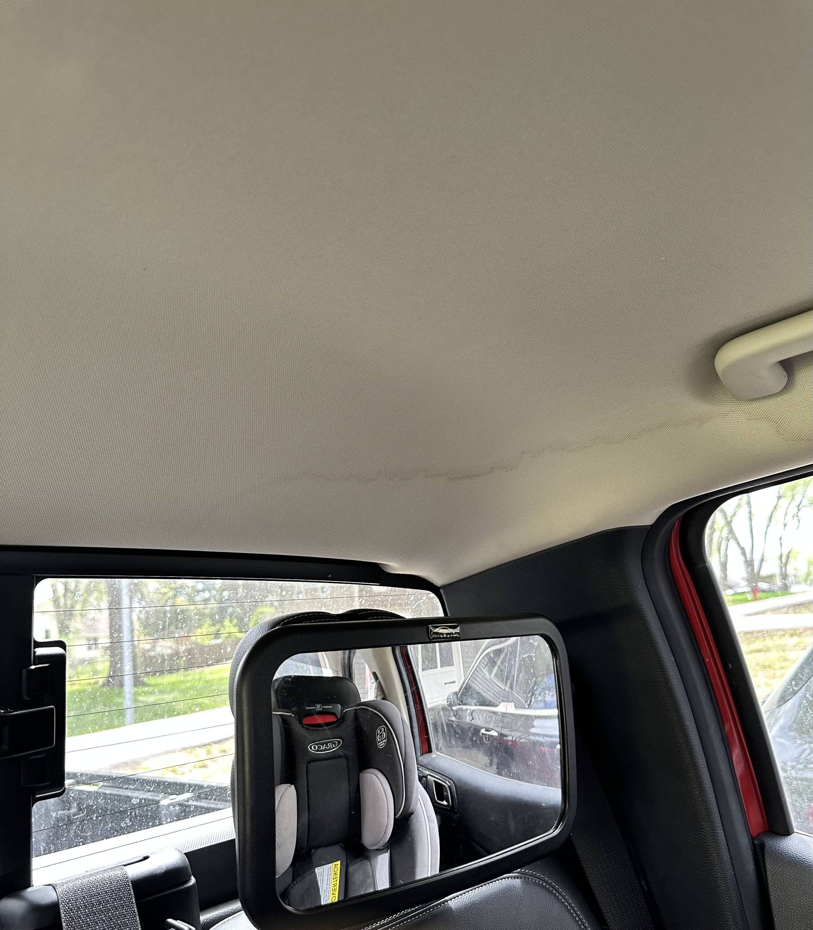

Are they water stained?

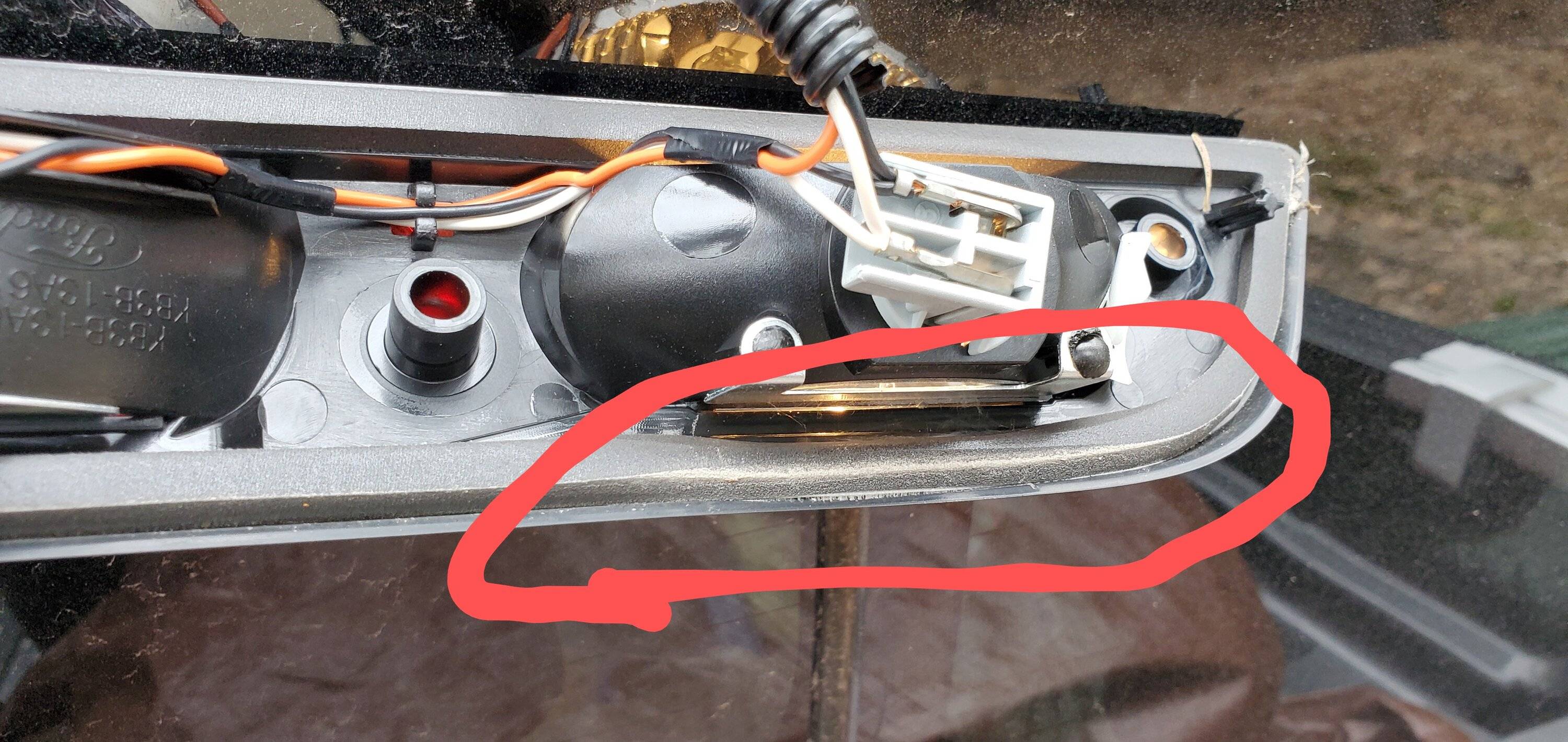

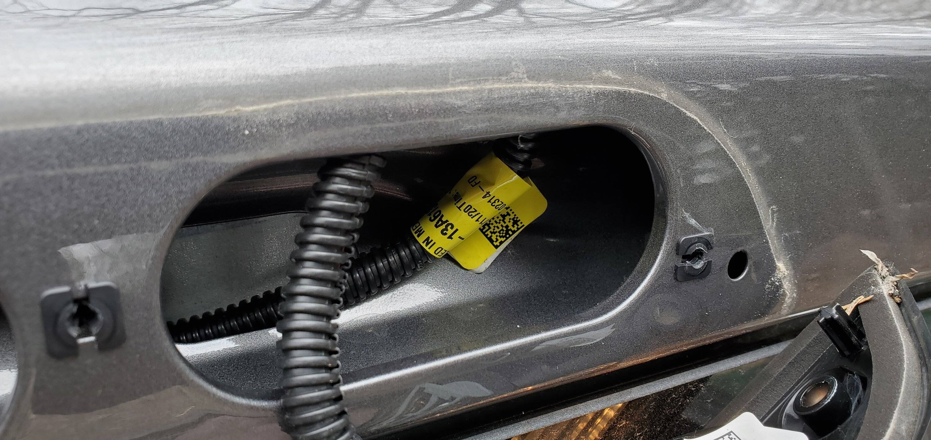

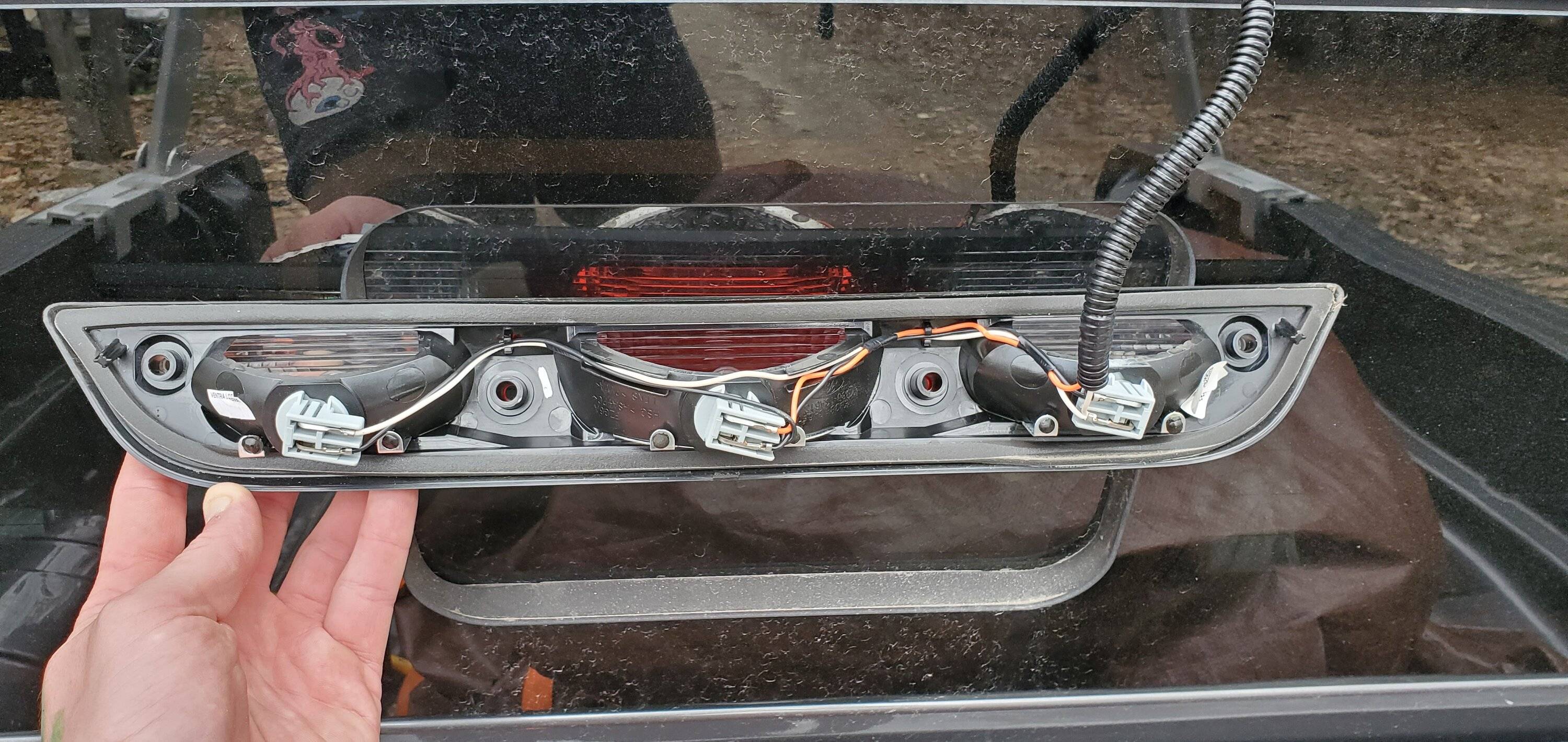

It's probably due to a poorly applied seal on the third brake light housing. My truck recently started to leak, and I tore it apart yesterday.
The seal is a foam/rubber type deal. In my case it wasn't put on completely "square" and was allowing a leak along a short section..
Just enough dust had been brought in to make it relatively obvious where it was leaking
Mine started leaking, just as ford would want, at 37k miles.
I just gobbed a bit of ^ this stuff all around the mating surface of the seal and put it back on. I'm sure it's days of leaking are now done.. but I'll report my level of success when it's done raining in like.. 3 days lol.
The "proper" fix would probably be the installation of a new housing with a correctly applied seal.. I just wanted the leak gone asap.

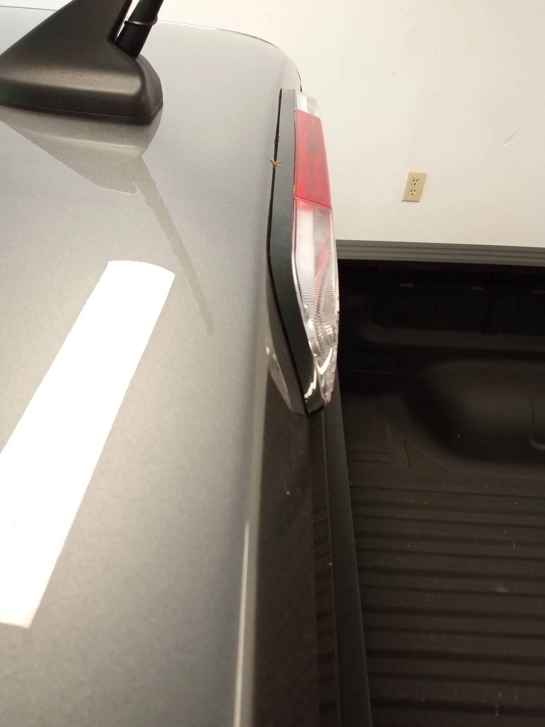

No stains on the inside , but it doesn't seem to fit tight , looks like a lot of gap to me , I may take it off and check gasket ...
