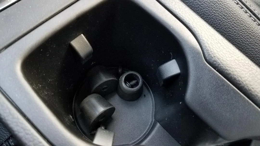

My Ranger was back at the dealer to get my spray-on bed liner installed, so I asked them to take a look at the back seat issue. When the service manager called me to let me know my truck was ready, she said the tech "called the hotline" about this back seat issue, and was directed to "remove the rubber that was interfering with the latch" or something along those lines.
I assumed it was the piece of rubber right next to the latch, as we've been discussing. However, when I looked at it when I picked up the truck, the rubber was still there, and I didn't notice that it was adjusted or trimmed. The back seat properly locked upright, however, so they did something.
While driving home, I noticed these in my cupholder:

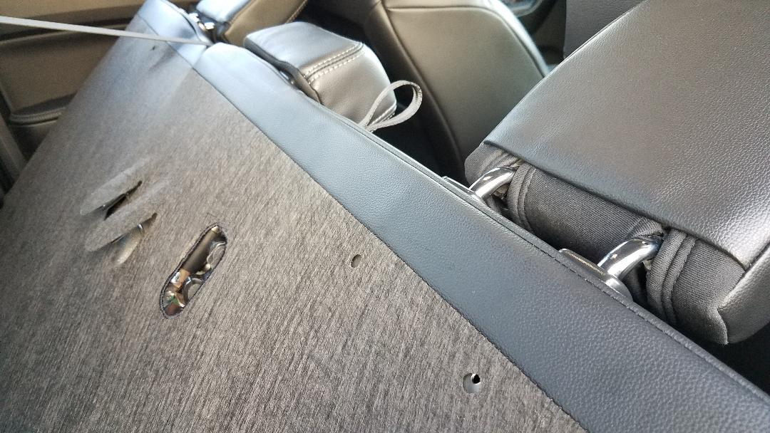

I looked for where they may have come from, and saw these holes on the back of the rear seat:
I hadn't noticed the rubber stops there prior to dropping it off. Not sure how those rubbers stops would have even fit there. What's also throwing me off is that there are four holes but I only have three stops in my cupholder. Can anyone confirm that these holes are where the stops came from? I'm just trying to confirm where these rubber stops came from and confirm what Ford's current recommended fix is.
That is where they are located. I pointed them out to the dealer when I dropped mine off yesterday for this exact issue. Hoping they don't just remove them, because I assume they're installed to help prevent any rattling from the back seat in the latched position.
Thanks for confirming. I concur with your hopes that Ford comes up with a more permanent solution, like maybe slightly shorter stops. The engineer in me has to assume the stops were there for a reason. In addition to the rattling, I assume the latch itself and the area on the back of the rear seat that the latch is attached to were not designed to sustain the full weight / pressure and torque that rear passengers would place on them.
ETA: For those wanting to try this fix for themselves, I wonder if just removing the inner two stops versus all four stops provides just enough "give" to allow the latch to work, while still providing some support to the seat back and preventing any rattle. In fact, I may try this myself tonight and re-install the two outer stops.

My truck arrived today, so I "visited" it at the dealer to finalize our deal. Tested the seat back and no problems at all. It latched back up with minimal push.
Did you notice if the rubber stops were still in place? I'm wondering if dealers are starting to remove them proactively to address this issue.

Maybe those stops can be shortened a little by grinding them down. This might provide enough relief to allow closure without abandoning the stops all together.

Here is the official write up by Ford released today :
Feb 6 2019 7729 - 2019 Ranger Super Crew - Folding Rear Seat Back Hard To Latch – Built On Or Before 30-Jan-2019
Some 2019 Ranger Super Crew vehicles built on or before 30-Jan-2019, may exhibit a hard to latch rear seatback to the upright (Normal) position. This may be due to 4 installed rubber bumpers in the seatback frame. To resolve the concern, remove the passenger inboard rubber bumper by the seatback latch. Verify proper operation, may need to adjust the latch after the removal of the 4th bumper. Vehicles built after 30-Jan-2019 will only have 3 bumpers installed, and small patch to cover the exposed hole in seatback cover material Use Flocked Tape (Fuzzy) 164-R4903. Refer to Workshop Manual (WSM), Section 501-10B. The 4th Rubber bumper is no longer equipped due to a running change. The vehicle is not misbuilt. The addition of any parts would not be considered a warrantable repair.
