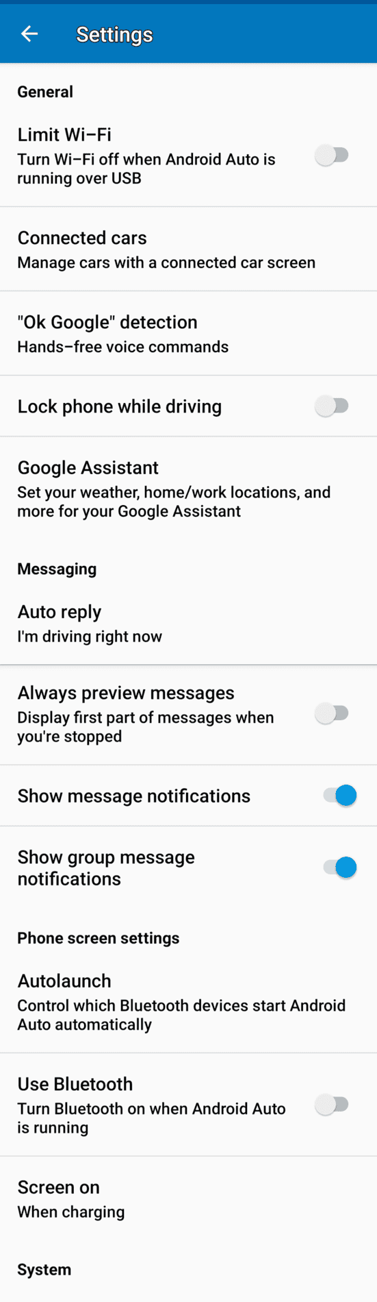

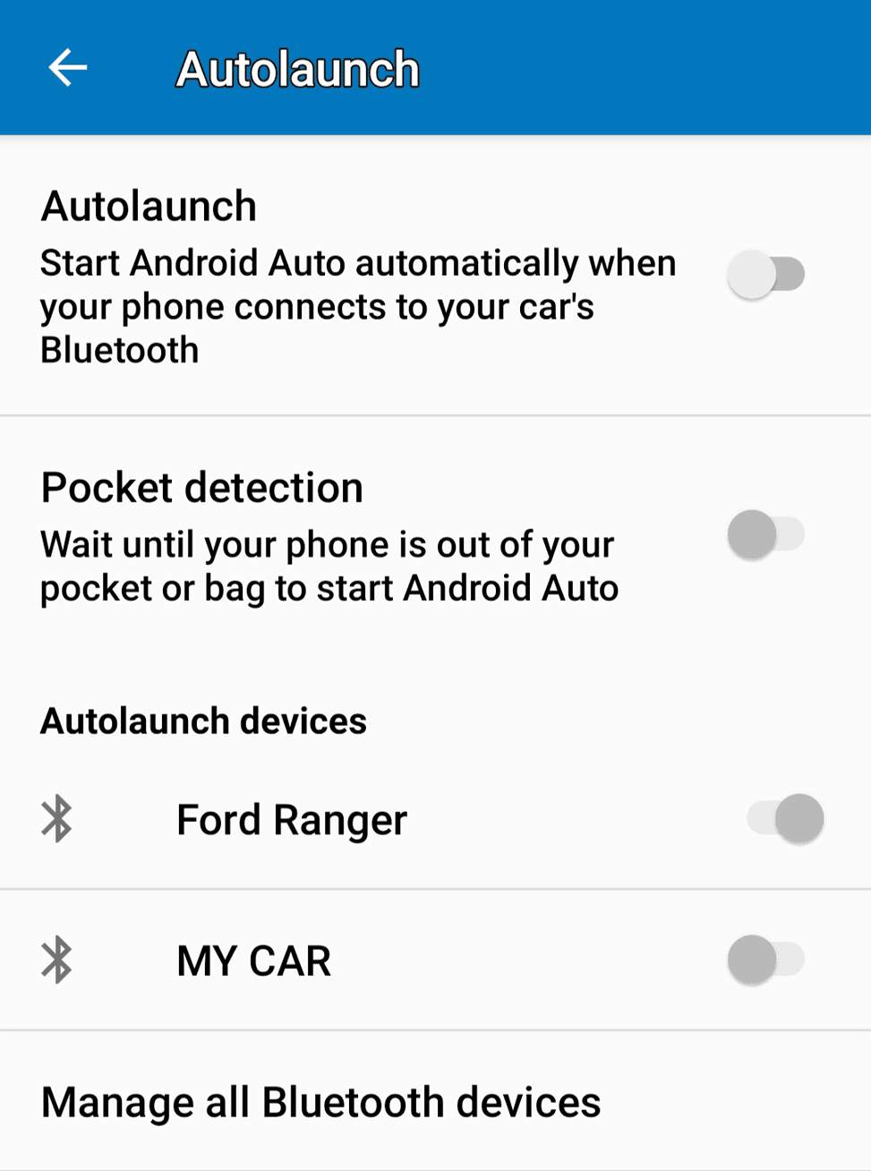

I was having the disconnect problem and basically, I got in and made sure that Android Auto didn't activate *on the phone* at all. After I did that, I haven't had the problem at all. If any of you have AA setup to activate on the phone as well (seems to be the default), give that a try and see if it helps.

Which setting did you change in Android Auto? Is it the "Lock phone while driving" slider?
ETA: In any case, I'm glad I just found that setting. Having AA lock the phone when connected to the truck was annoying as sh!#.
Here are my AA settings. Haven't had any further issues. My Sync-3 system is also up to date.
