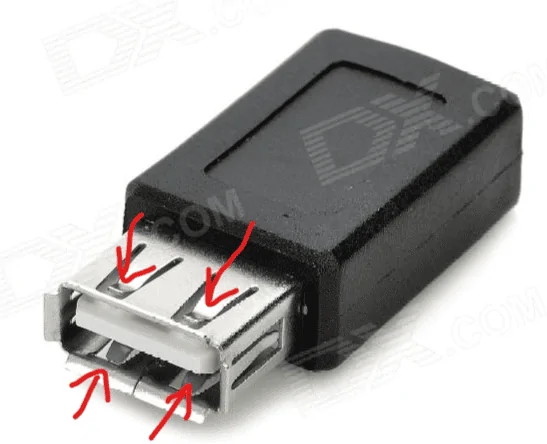

So I had my dash in my Focus RS apart this weekend swapping the USDM fascia out for the Euro version, and I decided to take a look at the usb connector while I was in there. Everything looked fine, but I decided to tighten the retention legs that hold the male usb cord in, and since then I have not had one instance of Android Auto dropping out! This may just be a case of loose USB connections causing the drops. I'm confident you can use a needle or pick from the front of the usb port to pull the legs up to tighten the connection. I'm going to give this a go in the wife's Edge tonight to see if it solves it for her as well.
Here's a pic of the retention legs I'm talking about.
