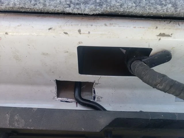

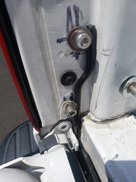

If I could only find a spring assist. Every since the tailgate storage it's like opening and closing a 79 F350 tailgate.
Well, step right up! I just installed a Hopkins EasyLift tailgate torsion spring.
Although it's made for full-sized pickups with heavy steel tailgates, since I installed the Huracan tailgate storage and loaded it with straps, tie-downs and such, the EasyLift is just what I needed for my +60lb tailgate.
I didn't take any pictures during the process, but it was fairly easy to make it fit, and it's a pretty good improvement. The packaging says it'll drop a 40lb tailgate to an equivalent 7lbs.
Here's a couple of pics after the fact. I've got to fab a cleaner clamp set up then what I've got right now and clean-up the hole I cut at the bottom of the tailgate. It's a rectangular hole to allow for a polypropylene pad (made from a cutting board) fitted to the tailgate end of the torsion bar so it wouldn't wear metal on metal against the storage box inside the tailgate.

I tried but gave up since I didn't want to cut more holes into the truck. I'll have to try again since you were able to do it. Did it allow for a slow drop as well?
Not really, I think the damper is better suited for that, I'm certainly not going to let it drop on its own. The previous lift weight was just over 42lbs. with the storage unit loaded. It's now just 18lbs. It's not as much as I'd hoped it would be, but it is a great improvement. I can one-hand it with no strain. It feels about the same as before I added the storage unit.
