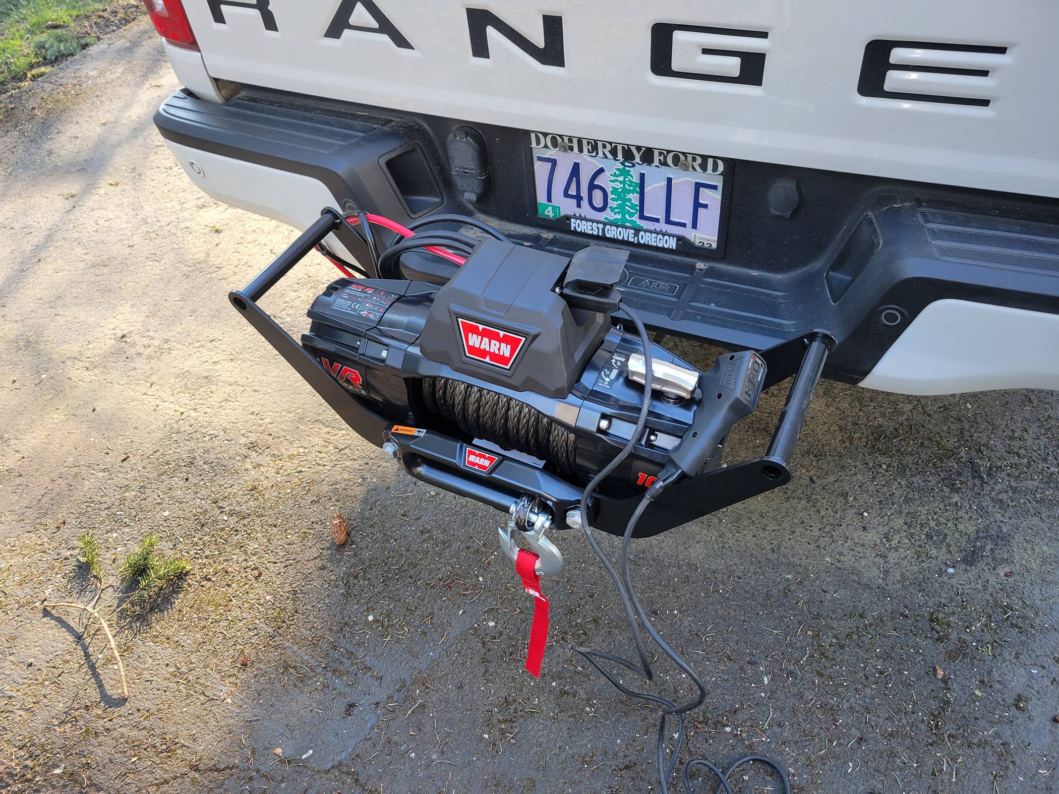

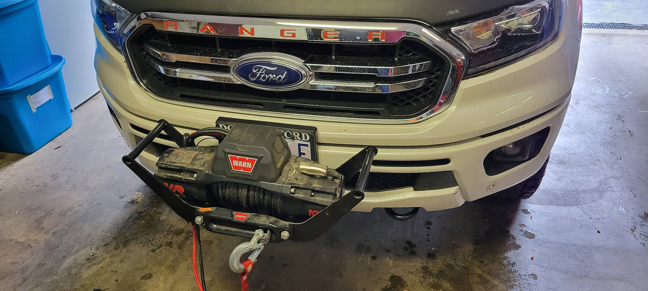

Depending on how frequently you intend to use the winch, you might look at a hitch mounted option. I've had that for a couple of years now, and even installed a front mounted hitch receiver from our own @Heavy Duty . This allows me to keep the winch in the bed and install it up front or in the rear depending on what I need. I've only used it once, but it works really well.
This is excactly what I am doing. Just have to weld up the kit from heavy duty. If you are the one that posted this. Thank you for the idea.

@Heavy Duty if I order your pre cut kits, can a local fabricator adjust the center of the hitch to account for the ACC?
Absolutely! That's how I designed this hitch. The center of the reciever tube can be offset one side or the other....some have requested both. The hitch is also designed to be installed without removing the bumper.
