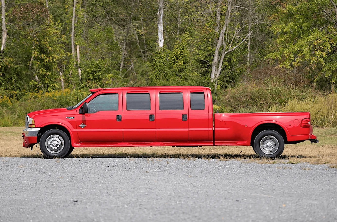

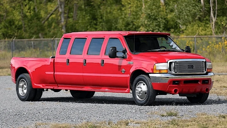

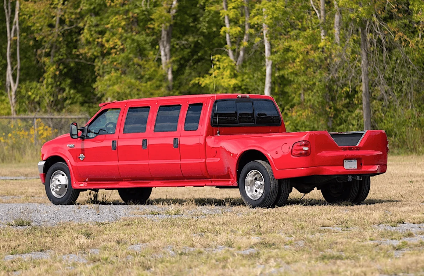

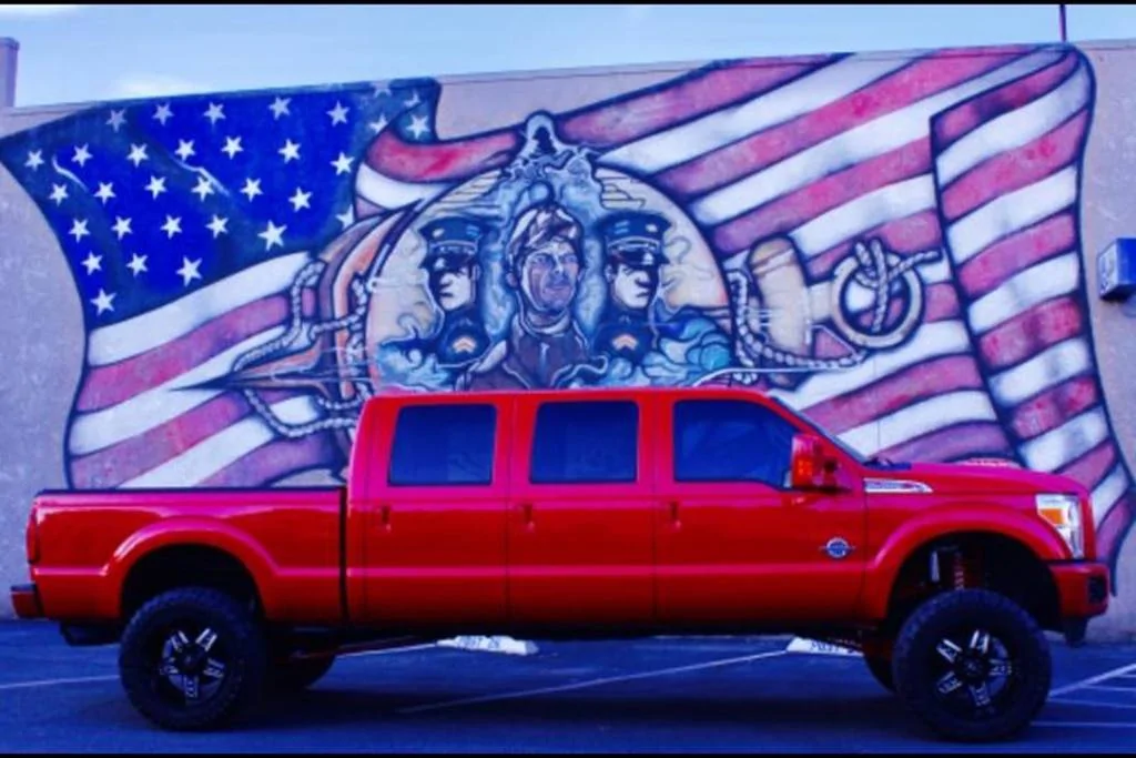

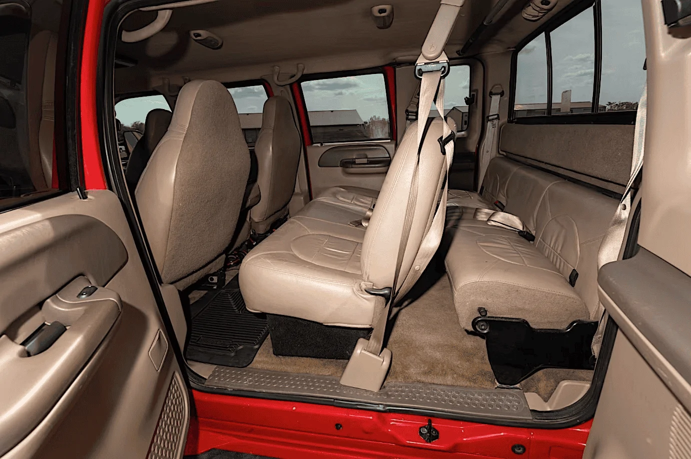

I just wanted to chime in on the 6 door, having a fairly big family would be pretty easy if you had America on wheels ?
A few fords have been customized and dodge too.
Idk I don’t hate it ? two captain chairs up front and two bench seats means all four kids and two dogs seated comfortably and a truck bed… it’s almost the truck I’ll need if the wife and I have another kid ?
Please ignore the squat tho, I’d rather have it with a slight rake for towin.

A six door Ranger I wouldn’t hate it but you might need a limo license to drive one of these crazy things? oh and probably keep a spare transmission in the bed?

Hey, it's a Ford, it's Race Red, and I suppose it's a supercab of sorts with the little suicide doors.
Great for those dump run tailgate parties for the entire neighborhood! =D

The last little super cab situation made me fall of the couch ? like you know what’s better than three doors on each side…. 3 and a half doors on each side…. Why not just make it a 8 door? … what!? 8 doors? 8doors well that’s just ridiculous! ?
That last row is definitely where you make the ones you like the least sit
