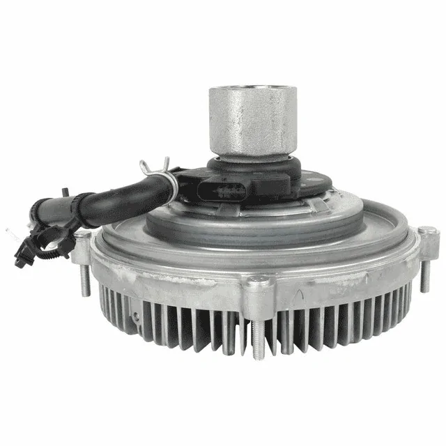

Fan Clutch - Ford (KB3Z-8A616-B)
2019-2023 Ford Ranger - kb3z8a616b
  • MSRP:$609.09
  • Discount:$240.59 (39.5% off)
  • Sale Price:$368.50
Shop Labor Guide = 1.8 hrs - For a 30 Minute Job (Grrrr) - Fan Clutch R & R

The Fan Clutch above is from OEM Ford Parts Direct to use for comparison pricing to your dealer.

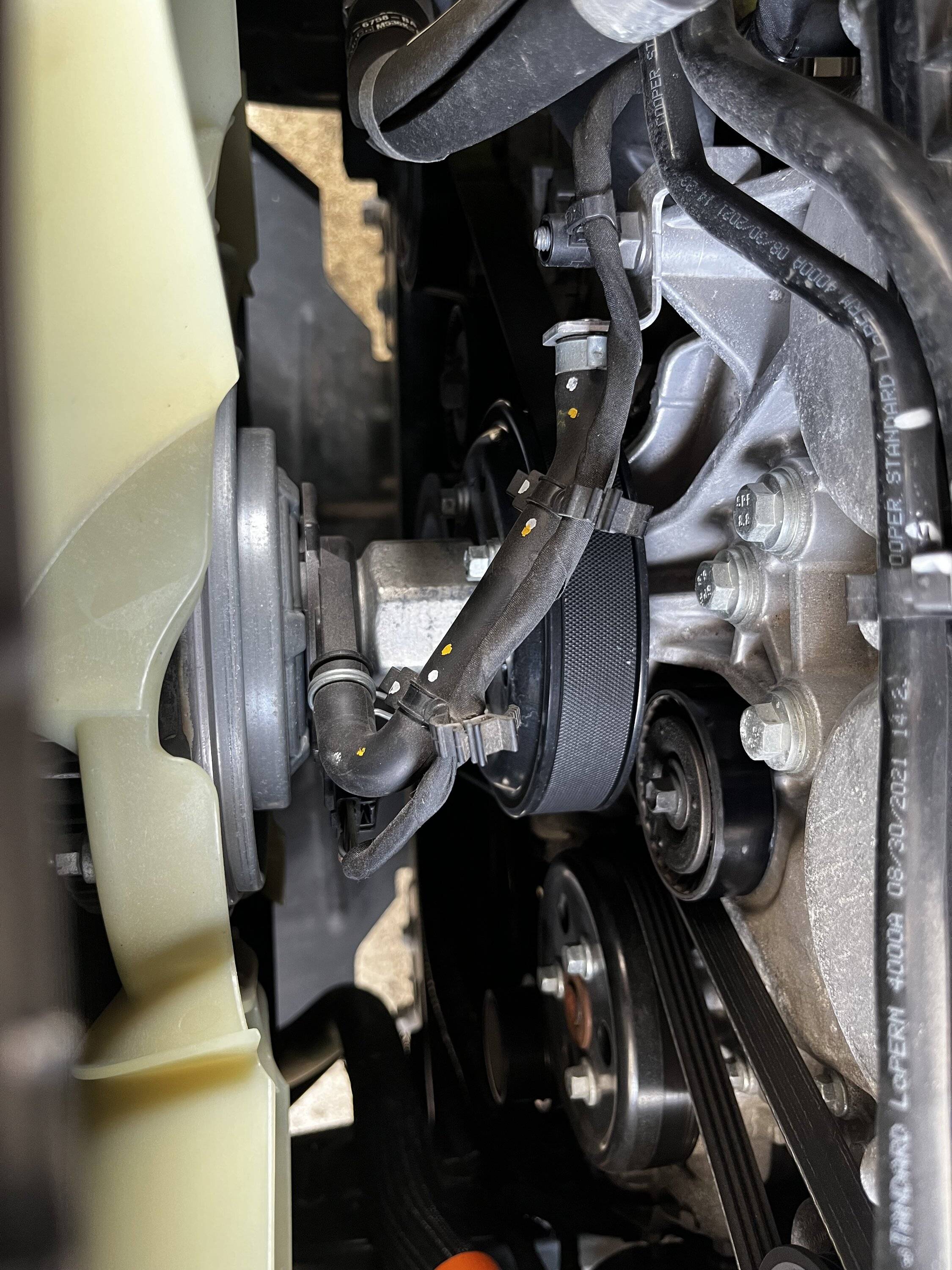

After looking at this pic, I thought I would go out to the truck and physically look at the clutch with engine running.
The whole assembly spins with the module remaining semi rigid, some very slight movement rocking back and forth but mostly rigid, I very carefully reached down and moved it side to side.
No grabbing or any resistance noted.
Note: An easy way to mentally picture this is grab the module and spin the clutch
I was determined to come up with a reason for this to fail and rip the harness apart.
I have come up with some possible failure points and makes logical sense.
That module is sandwiched between the backside of the nut and backside of the hub.
With engine off or running you can rotate the module side to side, so it is free-floating.
I am assuming it is a solid shaft between the nut and hub with a metal raceway and or a bearing and race that the module is riding on. Would have to see one apart to be sure.
I can see that that over time, the raceway can wear and gall and cause friction, thus create a grabbing effect on the module as it will want to spin with the rest of the unit.
Now, if this wear gets bad enough, I can see the module now being able to rock front to back and grabbing the back side of the hub and the module wedging itself in between the nut and hub, thus being the big rip of the hose and harness as now it will really want to spin with the rest of the unit.
Another possible is Bearing wear on the hub itself, if the hub bearing gets wear it will let forward and aft movement of the hub and thus let the hub rock backwards toward the nut and wedge the module in between, making it rotate with the unit.
Basically, in a nutshell the module is being pinched or wedged in between the nut and hub and when that happens the module will want to spin, the rubber hose is installed to allow for friction movement of the module.
Modification Options: Hmm
1. If you were to install a rigid line / bracket in place of the rubber hose, might cause more stress on the raceway and physically break the plastic.
2. Reroute the wire harness off of the hose, will not help as the module (in a failure) described above will still spin and pull on the harness and connector anyway.
By using this borrowed pic from earlier post let's look at exact what the hose does for the module.
The Fan spins clockwise (as you are sitting in the truck) so the module also want to spin clockwise by the small amount of friction that is created by the rotation of the fan as its riding on the raceway.
Note the position and routing of the hose, it is there to absorb that friction resistance and keeps the module in place.
Now if the hose breaks the absorption is taken away and the module will want to spin.
or
If any failures noted above will put more stress on the hose forcing it to break
Now the wire harness is still attached to the hose and the module spins ripping the harness because it is clamped to the hose.
I do see one option to possibly help the wire harness and I have a strong hunch that this is where the harness damage is occurring and that is the first clamp on the route from the connector.
That looks like a stress point on the harness.
And I am fairly certain that is where the wiring is being damaged, due to the fact that when that hose flexes the wire harness will flex with it, and the area that is going to flex the most is right at the clamp.
and the hose stress point is where the small bend in the hose at the point where it clamps to the engine side, I feel that this is where the hose will break as this point will absorb the most force against it on the nipple connection for the hose.
So, the only solution I see to possibly save the wire harness is to either take the harness out of that clamp and leave in unclamped or zip tie it farther up the hose. It would allow more movement of the wire harness if the module were to spin clockwise and also eliminate the flex stress point at that clamp.
This is just my observation of this and possible solution to full wire harness damage.
I hope my rambling makes some sense for everyone.
