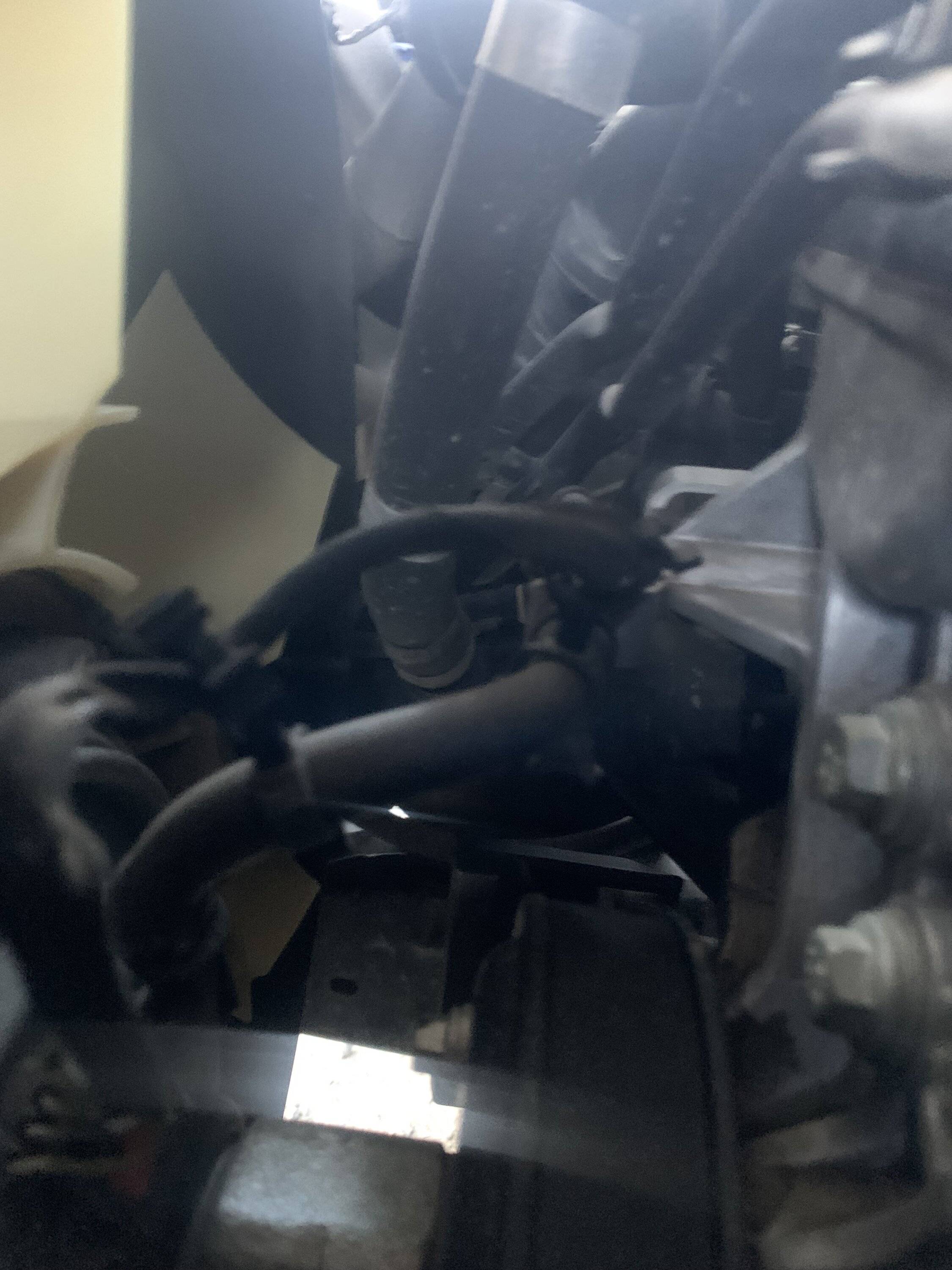

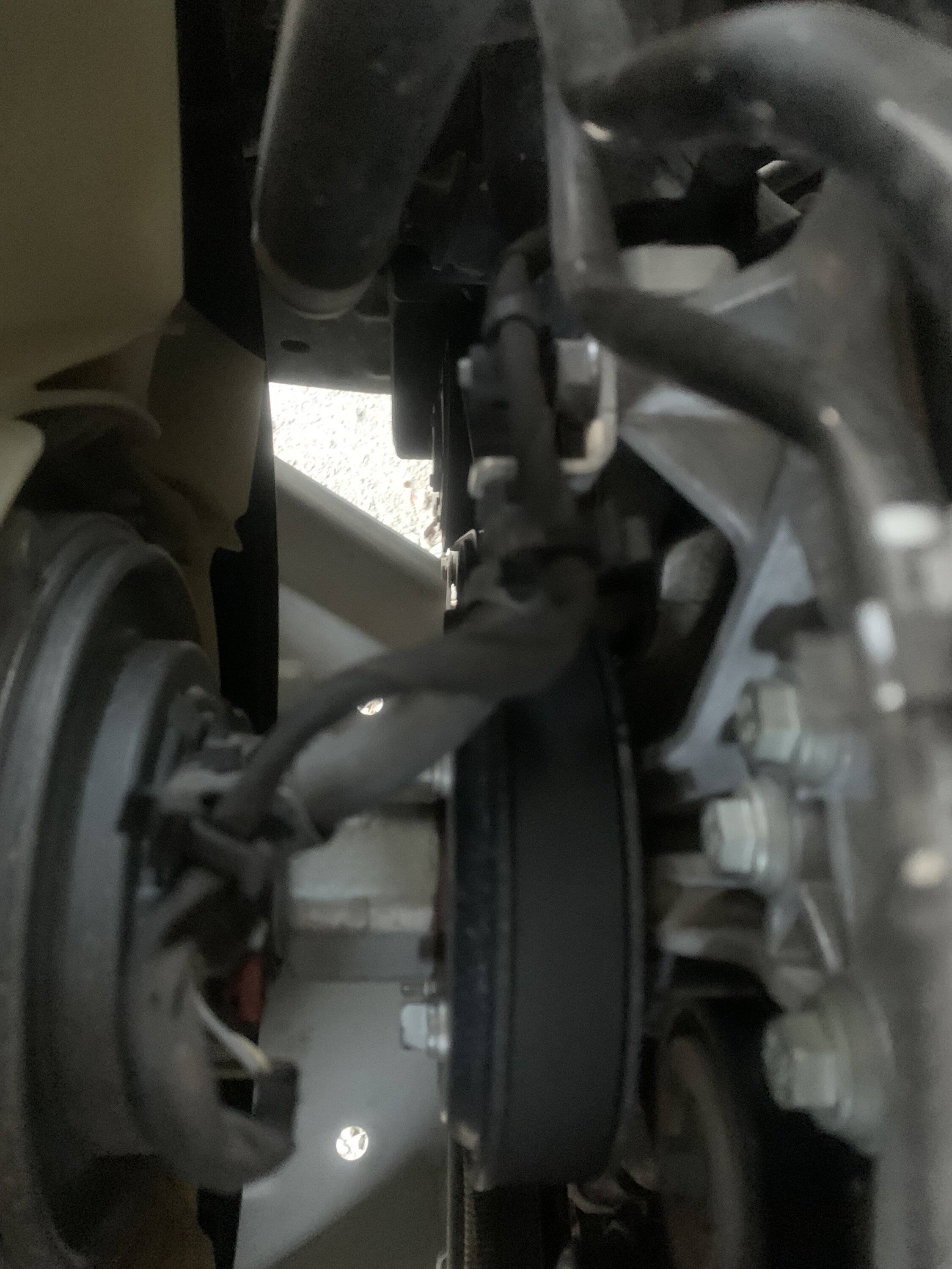

Airline tech thank you for your detailed response very informative.
Thought I’d post my experience.
As for the rubber hose I noticed mine ripped apart during routine maintenance (oil change). maybe 2 years after purchase around 30k miles (original owner). Glad I noticed when I did never knew a clutch fan could lead to some many more problems. As for the hose I replaced mine with some good quality vacuum hose same diameter and new zip ties for wires. Hose has held up so far.61k miles now.
Don’t have any pictures of it broken. But there was tension on wires it was still free floating when clutch fan was spinning. But I could see how debris or anything over time could make it bind up and rip wires apart. Definitely something worth keeping an eye on or maybe proactively changing the hose.

Do you think maybe the hose deteriorated allowing the friction of the clutch to wrap the wires up, or did the clutch fail in the locked position causing the hose to fail.
This will aid in determining the solution. Stiffer hose vs a more rigid solution such as a separate metal bridge to anchor the sensor cable separate from the hose. I'm going to have to get under the hood to see what is feasible. I am certain that I am not leaving it stock, as it is a failure waiting to happen. The possibility may be low, but the repercussions are extensive.
This is my point of stupid design.
If it is just the hose breaking down and ripping apart over time, then easy fix and preventive maintenance (replace)
Wire routing, I am questioning the engineering reason for routing the harness inline with the hose vs a rigid route.
I would like to know what is the designed failure of the clutch, is it actually intended to break the hose and wires?
I have a hard time thinking they designed it this way.
The most important question is why is the electric module designed to free float in the first place vs screwed / bolted in place.
Hmm - enquiring minds want to know.
More research needed on this, hopefully the Ford Tech’s on this site can give us some insight on internal operation.

That is the stupid design of the clutch fan and is the common (if it fails result)
That little rubber hose is a anti rotating design for the sensor on the back of the clutch - note the wire harness for the sensor is clamped to the hose.
Clutch fails, sensor rotates breaking hose in half taking the wire harness with it, thus ripping wires apart.
Tripping all the dash warnings.
So pretty much my clutch fan is failed?
