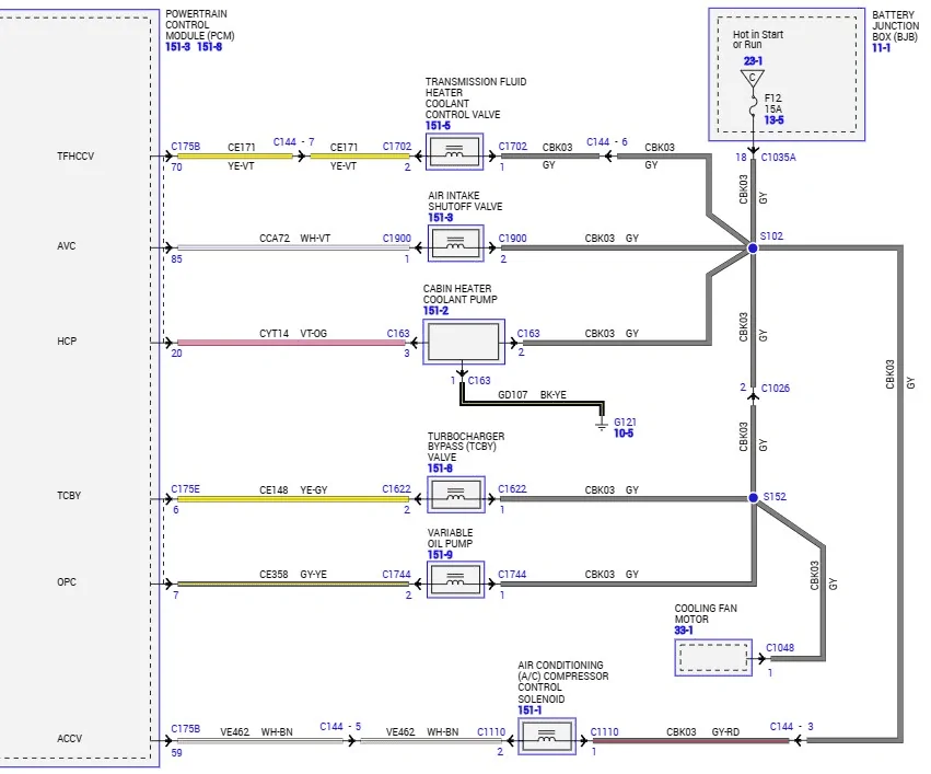

Ok, did some digging for the circuits that are tied into the Fan Clutch:
This is what I found:
Now keep in mind that all of these circuits will only drop if the Fan Clutch wire harness shorts out and possibly blows the fuse.
This is only showing the power feed side, you also have the VREF (5-Volt) circuit not depicted here. I found the diagram that only has this circuit as I missed some things on the complete engine control circuit.
1. The Cabin Heater (Coolant Pump) - Only active with ASS, provides coolant flow with cold outside temps while in ASS is active to continue flow (with electric) coolant pump to take place of the water pump with engine not running. ---So most likely ASS will disable.
2. Trans Fluid Heater Coolant Cont Valve - Normally open, closed with 12-volt power applied.
This valve allows or by-passes coolant through the Tran Oil Cooler for heat transfer tranny fluid to the coolant.
3. Turbo-Charger By-Pass Valve: No Fail safe found but assume that it will not work with no power.
4. Fan Clutch, now if the fan is not rotating or low airflow across the radiator, then the cooling system has a failsafe mode. (2) modes open/closed loop failure
This puts engine into LIMP mode, reduced engine power and limits to 3,000 RPM and has the ability to limit to 800 RPM, it can also deactivate (2) cylinders. (Overheat Protection)
5. Air Intake Shut-Off Valve (Note: diagram is nomenclated wrong) this is the Aspirator Valve.
This is normally closed and when powered it allows vacuum to be added to the brake booster, if the booster is sensing low vacuum.
6. AC Compressor Control Solenoid: Ac Compressor will not run, so no AC
7. Oil Pressure Cont Solenoid: Lengthy Description (Copy/Paste)
No Fail-Safe mode found for this, but the Oil Press sensor will read a low pressure and put engine into LIMP Mode (Power Reduced) if this solenoid drastically drops oil pressure.
You will still have an Oil Pump, mechanically driven, you just will not get the variable control out of it, so it should be full pressure (unaltered)

Update! Bad fuel sensor was blowing the number 12 fuse. The sensor happens to be covered under power train warranty. Thanks everyone for your advice. So many things attached to that fuse I didn't know where to begin
I am happy for you that it has been resolved.... But it is disconcerting, as I did not see the fuel sensor on the schematic. So we can add at least one more completely different system protected by that single fuse.
airline tech
Aug 24, 2022
4,506
8,600
Midwest - KS
Aircraft Tech
Yes, I checked the Engine Control, diagram as well, nothing on that circuit I see related to Fuel Sensor. Hmm We would need the exact name of failed sensor for deeper dive on how it relates.

I, too thought it was strange as I didn't see anything related to the fuel system for that fuse. I will speak with them more tomorrow maybe get the part number for the exact sensor replaced
And maybe the Code it threw as well.
The code I cleared personally was a P0034, which popped up again. i believe there are others as well as that code. Don't remember off the top of my head. Will report as much info as I can get
