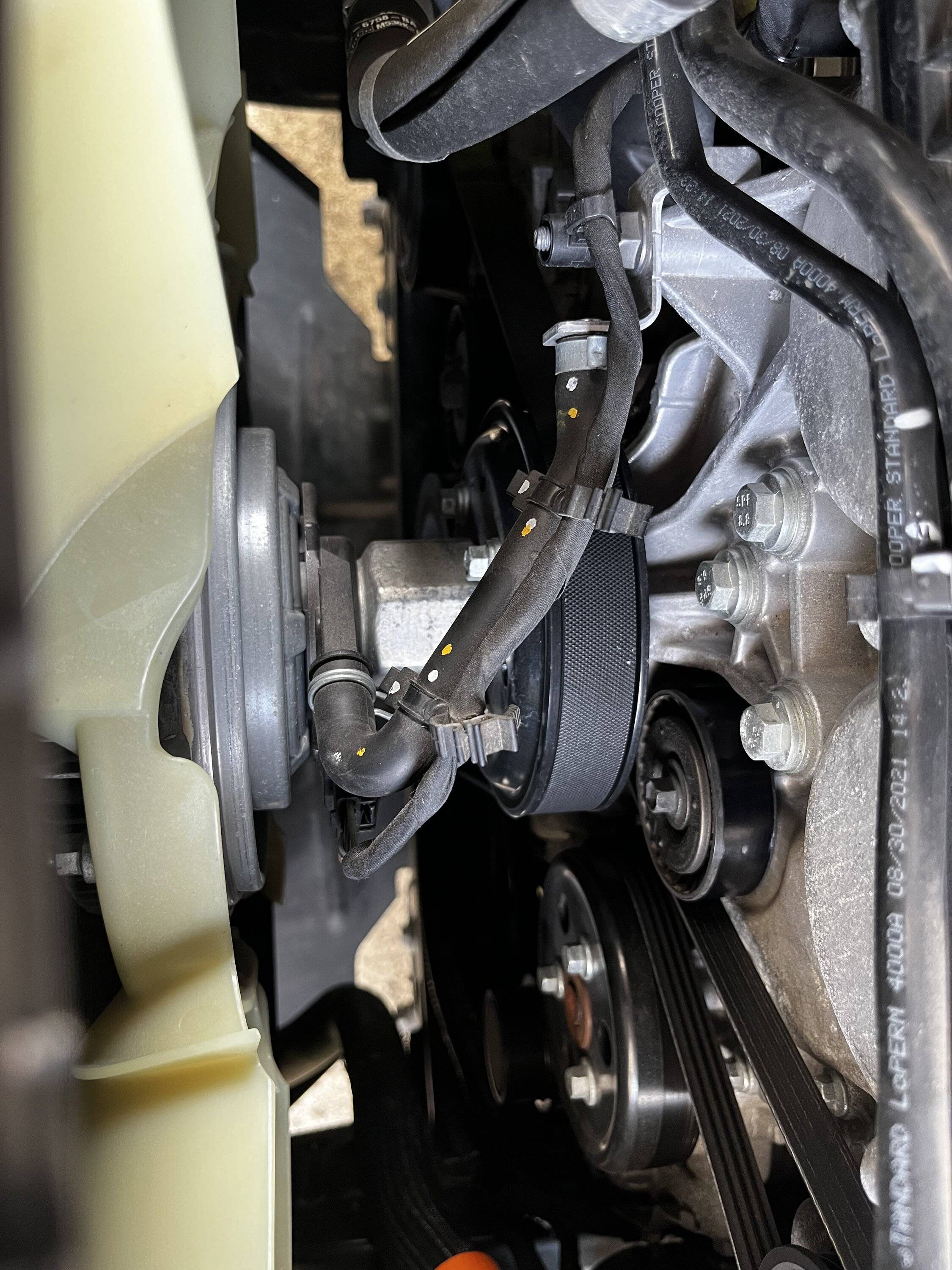

Is this what we are talking about?
Yes
The hose stops the electric module from rotating completely around from the rotating force of the clutch, something is causing it to break and it puts a stress on the wire harness (pulls it apart) and or allows the harness to come into contact with the fan blades

Yes
could the hose be replaced with a metal bracket?
I just checked mine and it was cracked, called my service guy and in the meantime I super glued it back on.

I am going to fabricate a replacement hose, and only a couple of inches will be simply hose, an inch on each end. Just enough to secure it with the hose clamp. The majority of the hose will be re-enforced with pipe, probably copper which I can easily form to the contour of the hose. I will be replacing the original hose with something of much higher quality.
My assumption is that the hose deteriorated. Even if I am wrong, I'd rather have the clutch squeal until it freezes up, rather than have it wrap the cable around the sensor shaft shredding the cable.
