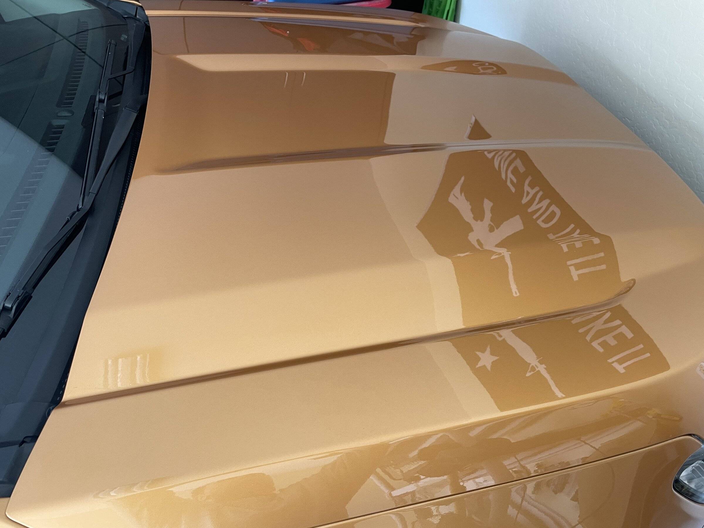

Andrew check out the link below where I explain how to apply the Graphene. There's also a couple videos there which will help you too. Yes you'll want to clay it first and do the baggie test. Before claying put a sandwich baggie on your hand and run it over the panels while they're soapy. If you feel grit in it you'll need to clay. After you clay an area run the baggie over it again, if there's grit still clay it again until it's smooth.
I use any speed detailer I have and don't waste a lot of money on it, use something cheap. You can layer up to 3 coats of the Graphene which is what I did for better protection and it takes about an hour taking your time. The second and third coat goes much quicker too. It will last up to 1 year like this and it's a good idea to hit it in between with the Graphene Detailer. That will add a little more Graphene to it and give you a super shine and slickness.

Yes it's a good strategy. :wink:
