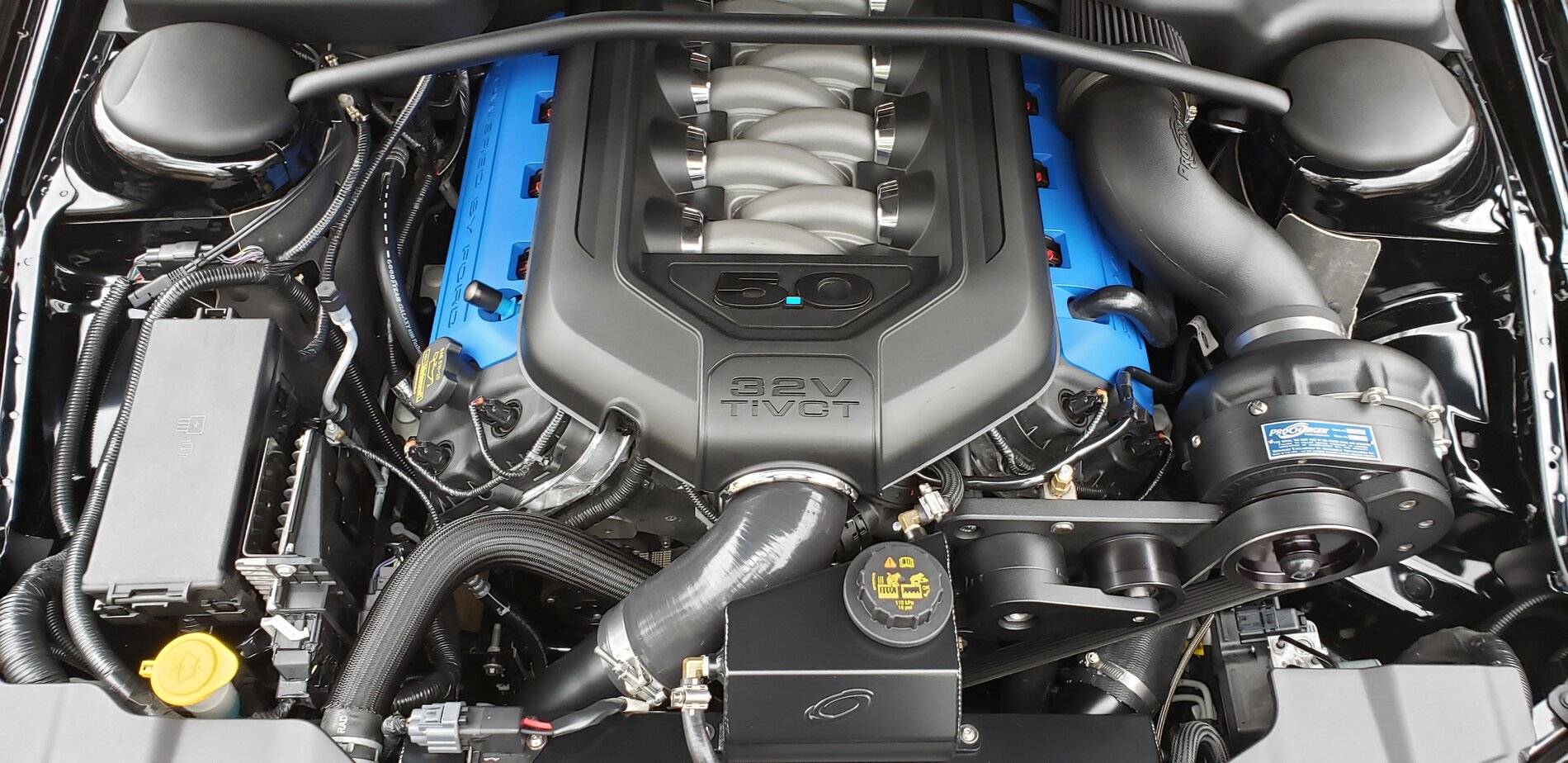

I use a product called S100 Total Cycle Cleaner (for motorcycles) to clean the engine bay. You lightly spritz it onto a cold engine, aggitate it with a sponge, and mist it off with the water hose. It actually leaves behind some sort of really, really light dressing that makes everything shine really nice. And it's made for the whole motorcycle, engine and all, so it's okay in just the engine bay! Here is my Mustang's engine bay after using it. A bottle of this stuff will last you a long time!

Nice! Just ordered a bottle of the S100 Total Cycle Cleaner and their Engine Brightener Aerosol. Supposed to rain all week, but I'll take some before after pics first chance I get to try it and will post here.

Can't wait to see them!
