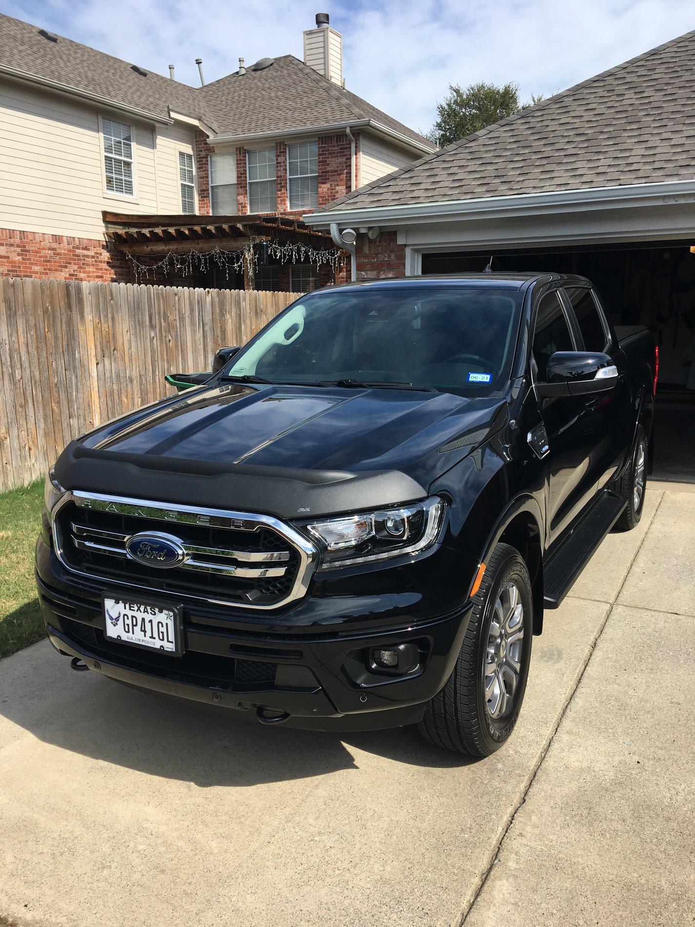

Did the dealer put on wheel locks? Did you put on colored wheel nuts like some folks on this site did that do not have the OEM footprint? Hopefully you will answer these questons. If this is a defect bubbling up, the company needs to head it off asap!

Phil, there were no locking nuts installed, wheels/tires are bone stock

Could be the dealer had the wheels and tires off for some reason (swap them, or damage in shipping) and didnt reinstall them properly.

Update, checked the lug nuts on the wheel while waiting for the tow truck and discovered they ALL were loose. So I tightened them up before he took it away. Arrived at the dealership and they are puzzled as we also discovered that the center stud is totally missing from the truck while the outer two were just sheared off under the lug nut. Just waiting for my loaner car and will update again once the service department eyeballs it
Did you put on the nonstandard valve stem cover? If not, it seems unlikely someone changed a dust cover without changing the tire. My other thought was maybe someone tried to steal a tire and got interrupted.
Nope the valve stem cover is from the dealership and shows they put nitrogen in the tires, as for swapping wheels I don’t think so but it’s certainly possible although these wheels are stock on a black lariat
Now since you’re all speculating here is what I have done to the vehicle
-instilled tonneau cover
-installed bug shield
-installed mud flaps
-installed Bed liner
-installed running bars
So I haven’t touched the suspension, brakes, tires, wheels. Other than the aftermarket parts displayed above this truck is bone stock from the dealer
Oh one last thing I bought it at the end of June and it only has 1,609 miles on it as I haven’t been driving a lot this summer

I think that the most likely culprit is someone was trying to steal your tires, and got interrupted like someone else mentioned. It's an oddball bolt pattern, but the average thief wouldn't know that, and if it sits a lot, they've had lots of time to eyeball your daily routines...
It’s in a locked garage all night
I had a tire store years ago that put Nitrogen in my new tires for the Corvette without my asking for it (extra $). I had to have them look for the OEM caps because I wanted to keep them. The reason I mention it is they also changed the stem caps to green ones. They said it was to identify there was Nitrogen rather than normal air.
I wonder if it might have been easier to move the wheels to the Nitrogen tank rather than move other vehicles around or move the tank to the vehicle. So, they took the wheels off.
I think the dealer caused the problem since they were the only ones to touch your vehicle. My dealer's "mechanic" broke a mounting bolt when installing my running boards. I thing they had a low experience prep guy who used an impact wrench rather than a nut runner. It took them 2 extra hours to fix that one and I ended up with one larger bolt since they had to drill out the broken one. At least they didn't just leave it. I'm just sorry I didn't install them myself but they were supposed to install for free as part of the deal on the truck.
You can bet I was really pissed when they tried to charge me $100 for labor. Don't pay them anything for fixing this problem. You're lucky to be alive.
